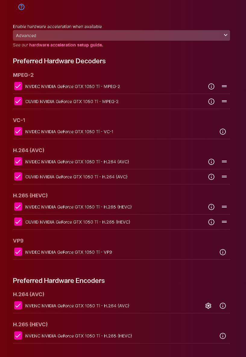

wpjonesnh
I know this is an old post and I am honestly not trying to hijack it. I just wanted to add a comment for anyone who is trying to do this with an nvidia gpu. It took me a while to find the correct links/process to get this to work but in short I followed the process on this link first to get my gpu working with an ubuntu 24.04 LXC container on a Proxmox 8.4.1 VE host. Note: Post actually references Plex but I was focusing on just getting my GPU to work.
Github Gist NVIDIA Proxmox + LXC
( I did not need to follow the "Python/cuDNN" section)
My lxc conf file ended looking like this:

After I got that process completed, I installed emby and I was good to go so I thought I would share in case anyone else who is trying to use an Nvidia card comes across this post:
