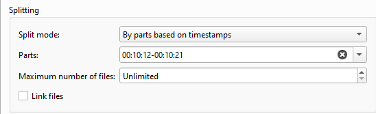

rbjtech 4996 Posted October 18, 2023 Posted October 18, 2023 (edited) 32 minutes ago, GothsterC said: Yes, it always glitches in the same place and the same manner. ok - so the fact it stalls in the same place is good. In mkvtoolnix - drag the mkv to it, change the output file to test.mkv, then go into output and create a 5-10 second using the hh:mm:ss in the 'Parts' section covering where the issue happens. (see example below) This will then create a small snippet of the MKV. If this snippet has the same issue (which it should) then this can be used to further investigate - and be sent onto Luke et all (and me if you like) to try and re-produce the issue. Edited October 18, 2023 by rbjtech
GothsterC 47 Posted October 18, 2023 Author Posted October 18, 2023 This is strange. I made several snippets. It's still messing up but in a different manner. Before it was glitching like skipping ahead like a scratched vinyl. With the snippet, it plays mostly okay, but I am getting green/purple blocks at the top occasionally. Sorority Row [2009] - HD (1).mkv
