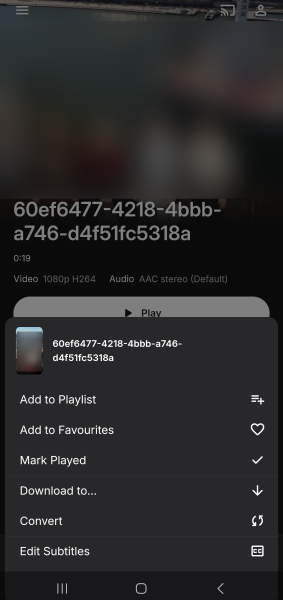

dma_k 2 Posted November 4 Posted November 4 (edited) On 11/3/2025 at 4:06 AM, Luke said: Hi, yes it is, the metadata editor is there. Where are you looking for it? I clicked on "More" (⋯) for the video and here it what I see (cannot find metadata editor): On 11/3/2025 at 6:38 PM, Luke said: Hi, I think this is a good idea, but probably not by default. Thanks for letting know. Is there any way to know the roadmap of features to be implemented in next releases? Edited November 4 by dma_k
Luke 41263 Posted November 4 Posted November 4 HI, you need to make your user an admin user, or sign in with an admin user, and then Edit Metadata will be available.
