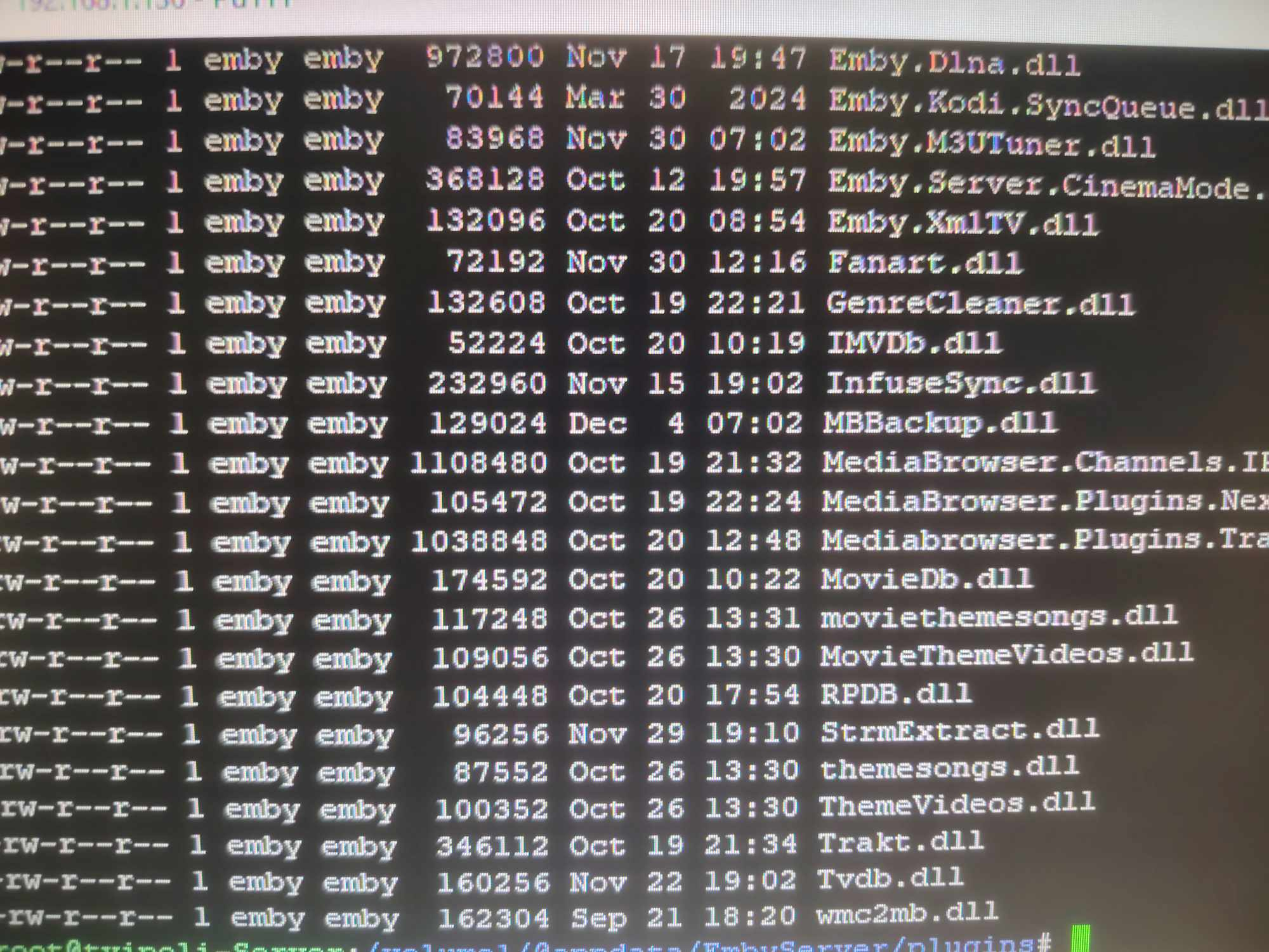

tvipoli 0 Posted December 4, 2024 Posted December 4, 2024 Can someone help me with the command for the installed plugin. I`ve come this far, I can`t go any further.
Carlo 4552 Posted December 6, 2024 Author Posted December 6, 2024 On 12/4/2024 at 2:22 PM, tvipoli said: Can someone help me with the command for the installed plugin. I`ve come this far, I can`t go any further. What plugin? What are you trying to do?
