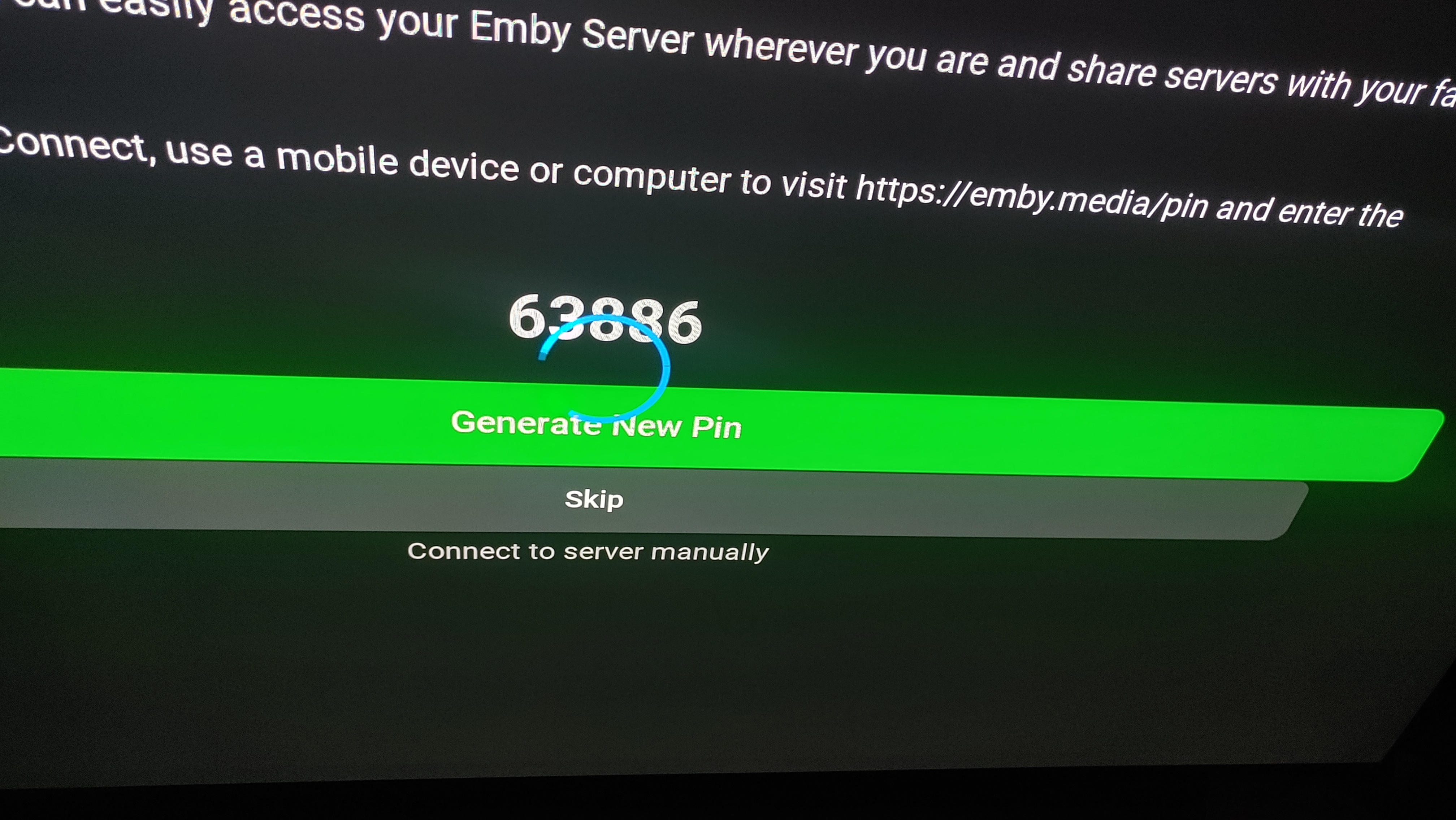

Kavalera 1 Posted November 15, 2022 Author Posted November 15, 2022 Excuse me but i didn't understand what to do. Now i try new Emby connect put PIN. PIN was confirmed then TV loading circle start and again show me to select server and when i select server there is message that cannot connect. Which details do you need?
Kavalera 1 Posted November 15, 2022 Author Posted November 15, 2022 If you need pictures pkease find it

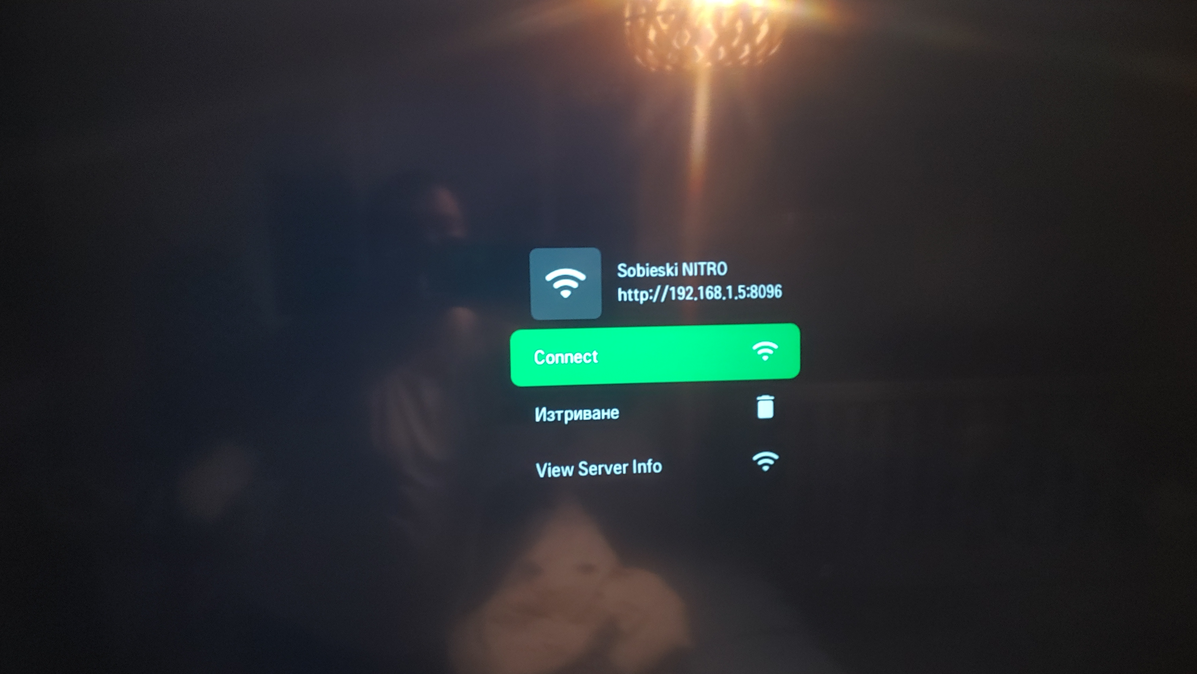

Kavalera 1 Posted November 16, 2022 Author Posted November 16, 2022 I have already test it yesterday and not work. Before when i set up and work i have used emby connect then pin and work. For some reason after a while stop to work and ask ne to show server, when i choose server then i see some error message. Please see pictures. Also intereating point is that from TV i see the Nitro PC (this is PC where Emby is installed) i also see my router samba HDD but didnt see EMBY.
Luke 40082 Posted November 16, 2022 Posted November 16, 2022 @Kavalera did you go through all of the steps in the document such as trying from another device such as a smart phone? What was the result of that?
Kavalera 1 Posted November 16, 2022 Author Posted November 16, 2022 Now i try with one old PC and result is like picture
