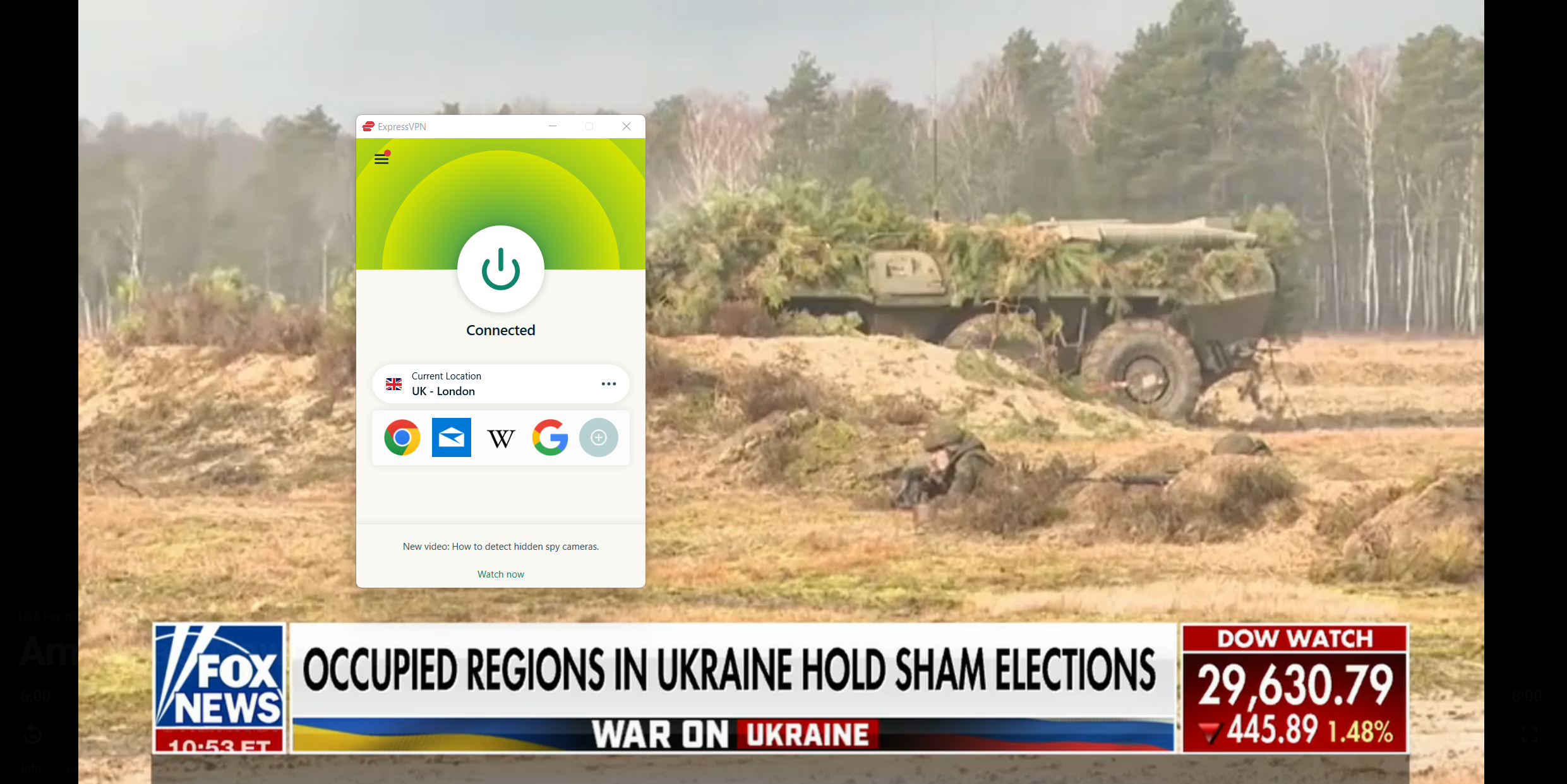

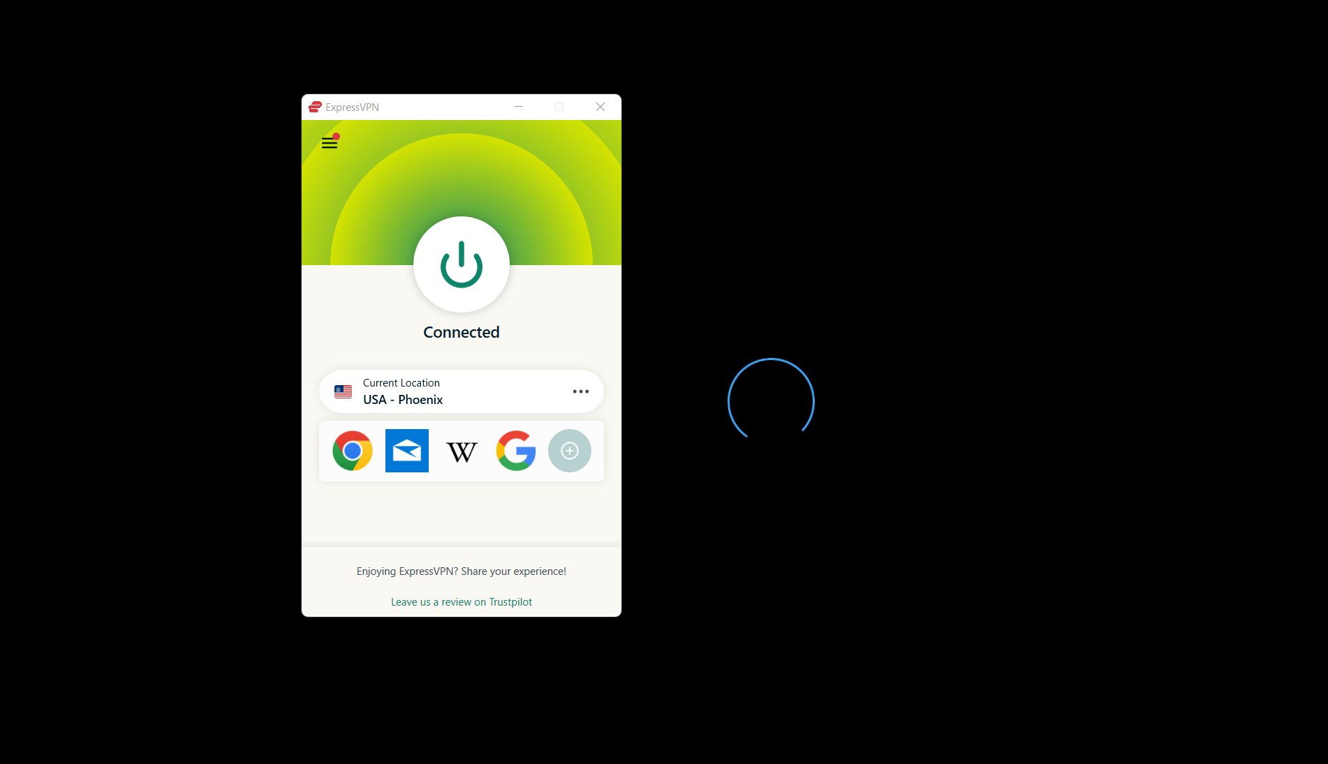

MarcusJ 18 Posted September 23, 2022 Author Posted September 23, 2022 2 hours ago, Luke said: Hi there, let's look at an example. Please attach the information requested in how to report a media playback issue. Thanks! Luke, I just changed the VPN to Phoenix (my city of residence) and tried Live TV and it failed (see screenshot). Then, I changed the VPN to London and it works again (see screenshot). I have attached the most current log file. FWIW, I believe my IPTV provider is Europe-based. Any ideas would really help. embyserver.txt
mark-in-dallas 87 Posted September 23, 2022 Posted September 23, 2022 (edited) If you are using the EPG data from your IPTV provider, most only provide 1 or 2 days worth of guide data. You can use the Emby Guide Data source and get up to 14 days worth of guide data, but you would need to map out all of the channels individually. As to only being able to play channels when using a UK VPN server, that may have something to do with either the VPN protocols supported or the IPTV provider blocking certain I.P. ranges. Try connecting with the VPN off to see if the issue is with the VPN or IPTV provider. If it works with the VPN off, then the issue would be with the VPN, if still doesn't work then IPTV provider is likely blocking. Edit: You might also want to download the EPG file from your IPTV provider, and check the dates to make sure that current and future data is available. Edited September 24, 2022 by mark-in-dallas 1
