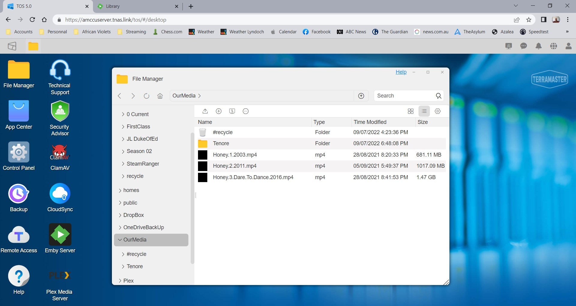

Media1 - Picture of Home Screen with media folder
Media2 - Picture of Media Folder open into the Library showing no media files.
Media3 - Picture of Library Setup showing Media Folder
Media4 - Picture of File Manager, with Media Folder open showing media actually in Folder

When you set up the library did you browse to the folder (use the magnifying glass) or just type it in? All my folders are of the form
/mnt/<sharename>/<folder>/
Edited by emdubya77
Yes I browsed, for the folder.
mine is /Volume1/OurMedia/
