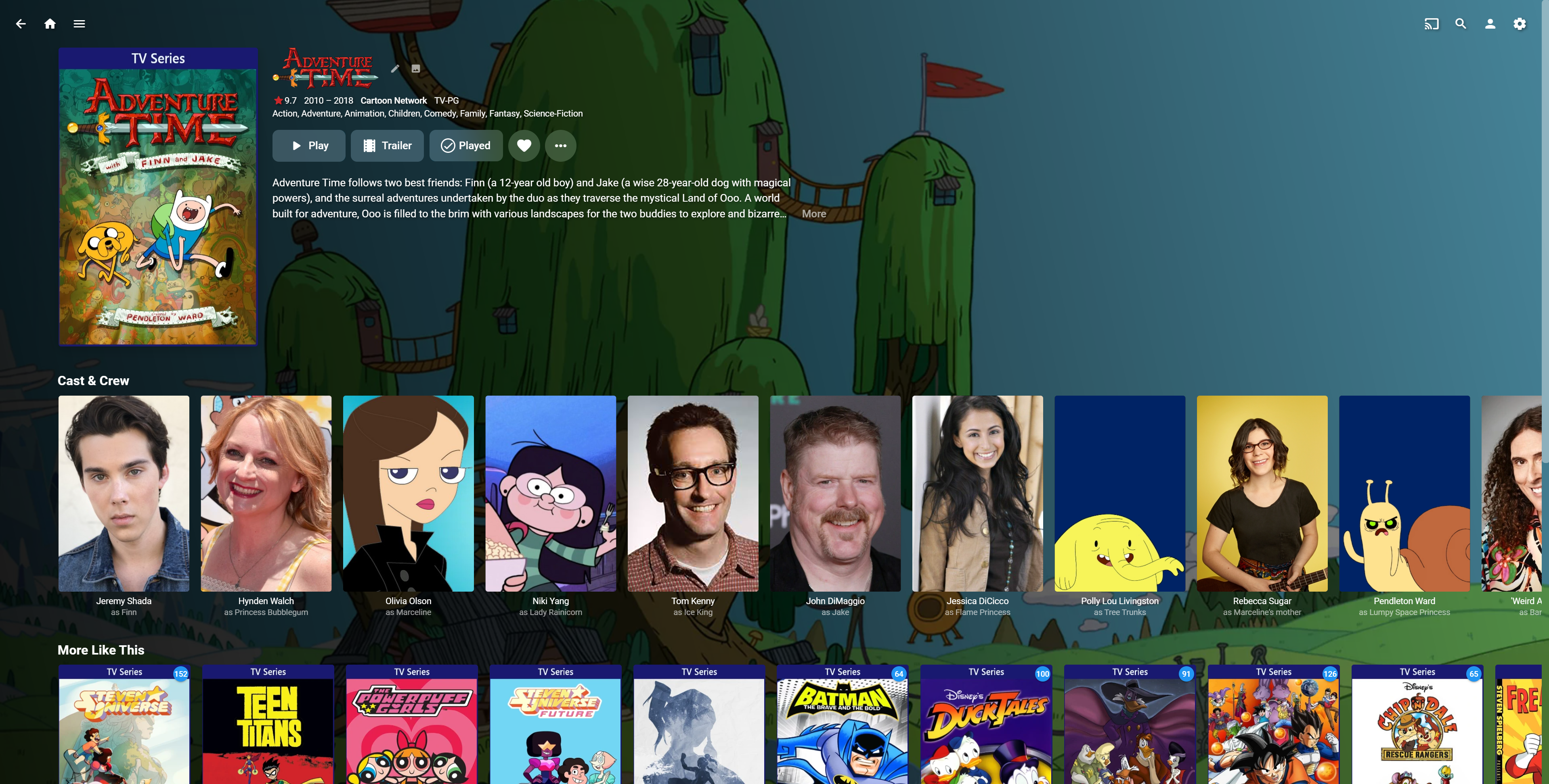

ShadowKindjal 19 Posted June 8, 2022 Author Posted June 8, 2022 Small progress update: I deleted the reference to the old metadata folder and I'm allowing that information to be saved in the default location. It was linked to an old folder structure that is no longer relevant but it could have prompted the issue in the first place. Changing this, however, didn't fix the issues with the tv shows. They seem to be slowing re-populating from the scan library scheduled task. I just don't know what happened to the previous data that would cause all the shows to not appear within the server. I assume I just have to wait for now. Another thing I've noticed, however, is that a lot of the actors and actresses seem to have missing art as seen below. Is there an option to refresh this data? I deleted the SSL reference on the networking page. Hopefully that'll take care of this issue. Like I said, everything is handled by my nginx reverse proxy so this should resolve the errors in my log files. I checked my discord notifications app and I was mistaken. It seems to be functioning fine. I took a second look at the error and it seems to be in relation to updates and when I checked the emby catalog it looked like the app is no longer available. Could that be why I'm getting this error message? Lastly, I did find the tune in plugin dll in my plugins directory and deleted it but I Can't find this anything similarly named to this channels plugin. I've provided an ls of my current plugins directory below.
Happy2Play 9442 Posted June 8, 2022 Posted June 8, 2022 (edited) 19 minutes ago, ShadowKindjal said: Is there an option to refresh this data? You would need to do a Library level Refresh Metadata as that image shows broken links to your metadata/people folder, assume your log is flooded with can not find paths as all the paths are recorded in the database so /metadata relocations can become problematic. You can try the "Scan Metadata Folder" task if you have relocate these items. 19 minutes ago, ShadowKindjal said: Could that be why I'm getting this error message? The topics suggest the dev stopped updating the plugin and hasn't been online in awhile, but you should look throw the plugin topic for options. 19 minutes ago, ShadowKindjal said: Lastly, I did find the tune in plugin dll in my plugins directory and deleted it but I Can't find this anything similarly named to this channels plugin. I've provided an ls of my current plugins directory below. Would need to see another server log after restart to see if anything else stands out. Edited June 8, 2022 by Happy2Play 1
