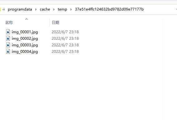

When I created episode 26, I found that the creation speed was very slow. I don't know why?
Even when I download to the local (SSD), the pictures of temp files are generated slowly one by one (very slowly). I don't know why?

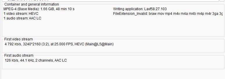

Is this related to video coding / resolution?
But in the first episode, it seemed to be finished in a very short time
The encoding / resolution of the first episode and the 27th episode are the same.

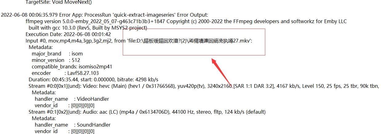

The following is the log file:
I noticed that the path here is garbled. Is this the reason?

Hi, it takes time because it has to step through the entire video, decode it, and then produce images at regular videos. So that means the performance of your disk I/O is going to come into play as well as cpu performance.

It seems that this is not the case. I re edited the post and uploaded the log file!

I know it takes time, but compared with Episode 1 and episode 27, I think there is a problem, because Episode 1 is completed in 10 seconds. I am not sure whether episode 27 can be completed in 10 minutes. In addition, the video is stored on SSD, so reading and writing should be no problem!
They're probably just encoded a little differently. Some videos will take longer than others.
