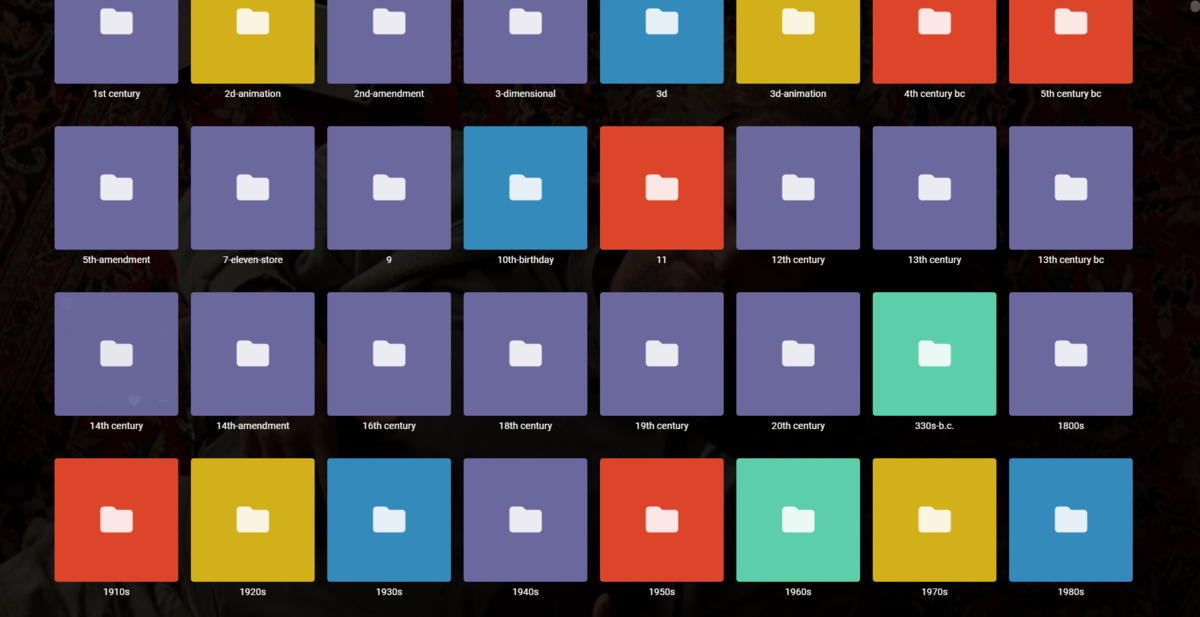

so i used tmm to scrape info to "movie.nfo" - then i wrote a little script to check directories for the presence of an existing nfo, and movie.nfo, if both are present, it collects data from both, merges them and creates a new nfo file, backing up the old one, code is awful but in theory i should only need to run it once, maybe again in a couple years.
the result of this is as the attached image, many many many many genres! fantastic, an absolute mess, but genre cleaner can now cull this down to something useful :)
