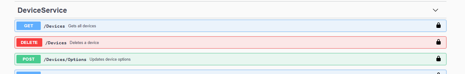

Looking at the DeviceManager service doesnt look like a way to remove a device, is that possible, I see you can do it from the UI lol.
If you delete a device does it kick all the stream/log out that user like I assume it should?
Happy2Play
Have you looked at DeviceServices.
I just looked at the call made in the server log.
2022-04-04 15:37:31.576 Info Server: http/1.1 DELETE http://‌‍‍localhost‌:8097/emby/Devices?Id=439dba90-7484-41e4-b497-92b9c73345aa&X-Emby-Client=Emby
I don't believe there is a global block, only a per user device access.

Yea this never applies to the plug-in c# api so idk why you keep referring me to it.  I checked in C# the device manager service and didn’t see a remove.
It's stored in UserPolicy for each user, so you'd have to update that.
