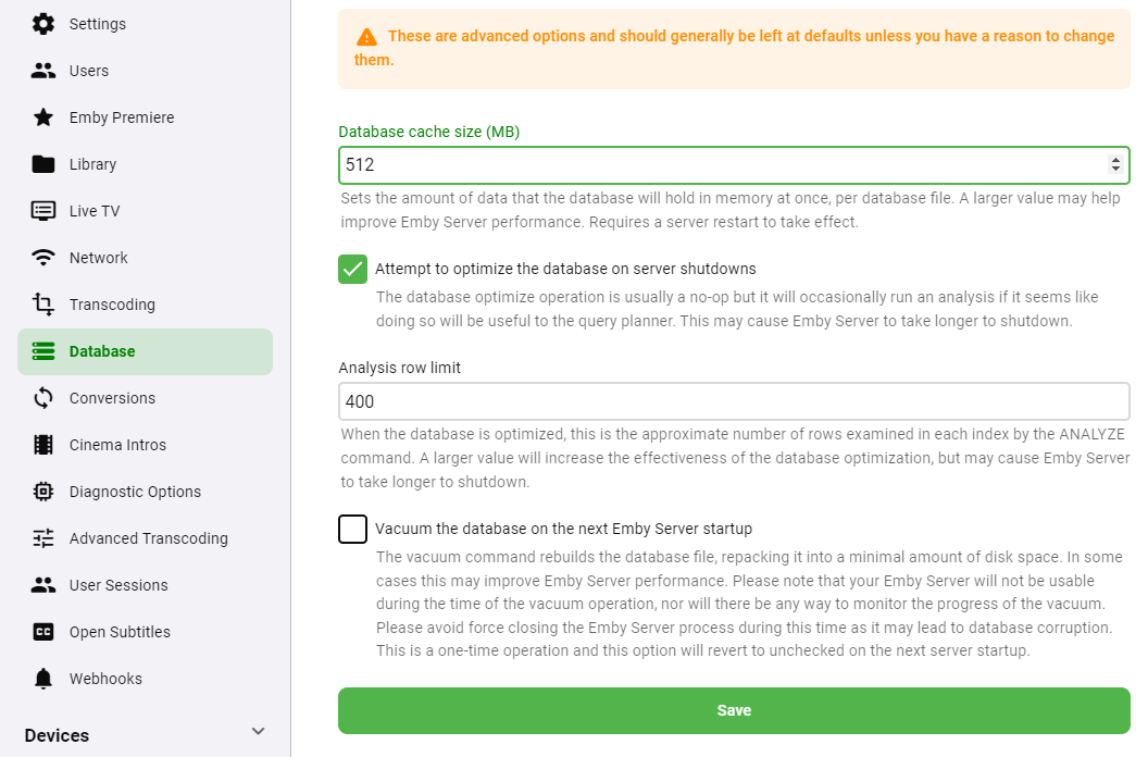

CharlesF 24 Posted September 5, 2024 Posted September 5, 2024 (edited) On 4/5/2022 at 1:58 PM, Carlo said: Yes, it get's it's own menu item too. You can adjust the amount of memory used specifically for database use, set a shutdown optimization that's pretty fast as it bases this decision off of X records (vs whole database) and of course allows you to set Emby to do a database defragmentation/optimization on the next startup. This get's unchecked once done until the next time you want to use it. Good sfuff! Is there a recommended value here? I set mine to 256 but default seems to be 128. I am running Emby on my DS423+ Edited September 5, 2024 by CharlesF
GrimReaper 4141 Posted September 5, 2024 Posted September 5, 2024 12 minutes ago, CharlesF said: Is there a recommended value here? I set mine to 256 but default seems to be 128. I am running Emby on my DS423+ If feasible: 1.5-2x your library.db size.
CharlesF 24 Posted September 7, 2024 Posted September 7, 2024 Thanks, these are my settings currently.
