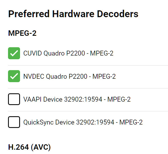

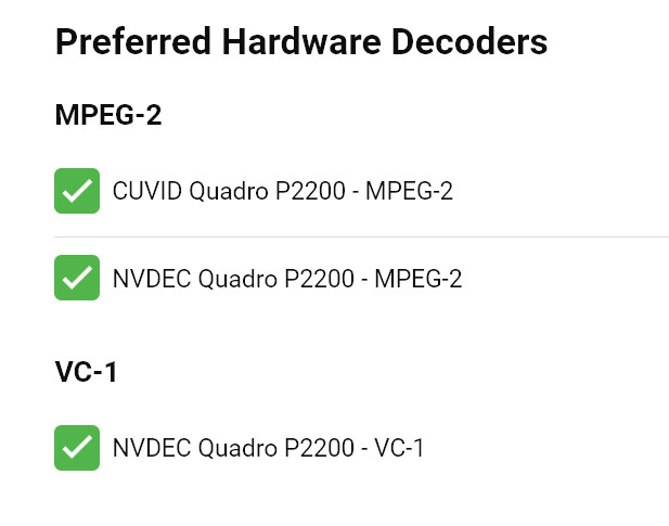

Ratatouille 14 Posted July 13, 2022 Posted July 13, 2022 (edited) Got something similar with Version 4.7.5.0 between reboot I am loosing vaapi /quicksync sometime is on and sometime is off. ffmpeg-transcode-8351d05e-d6c8-47f5-94a1-4fda0bdca87e_1(1).txt hardware_detection-63793294981.txt hardware_detection-63793298083.txt Edited July 13, 2022 by Ratatouille
softworkz 4570 Posted July 14, 2022 Posted July 14, 2022 The next beta will include the Intel updates. Sorry for the long waiting time.
