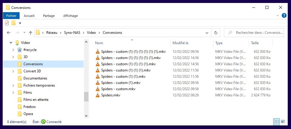

ielmax 1 Posted February 10, 2022 Posted February 10, 2022 Hello, I have Emby server on ASUSTOr and I’m very happy about it but I have to migrate to Synology and Emby does not behave in the same way at all. I pass on the special settings and permissions (at the expense of security) through which it is necessary to run Emby on Synology... The big problem I can’t solve is this: Video conversion does not work at all. Once the conversion is complete I always have the original video and, in addition, several 600 MB files (video(1), video(1)(1), video(1)(1)(1),...) whose total size is that of the original file... Unable to get a converted video in the correct format. This problem seems to be specific to the Synology server, the conversion works perfectly on my ASUSTOR servers as on my PC Thanks you for your answers
Luke 40111 Posted February 11, 2022 Posted February 11, 2022 Quote Video conversion does not work at all. Once the conversion is complete I always have the original video and, in addition, several 600 MB files (video(1), video(1)(1), video(1)(1)(1),...) whose total size is that of the original file... Hi there, can you please go over a specific example? What were you expecting? Thanks.
ielmax 1 Posted February 11, 2022 Author Posted February 11, 2022 Hi, I was just expecting a converted video according to the settings I chose. Namely a single file, . mkv with the original name of the video, and my conversion choices (H264, aac, 1.5 Mbps). In short, the result I have always obtained on all the servers used until today. Instead, for an original video (ex: Spiders.mkv) h262,aac, and 4Mbps I get about ten files (Spiders - custom.mkv, Spiders - custom (1).mkv, Spiders - custom (1) (1).mkv, Spiders - custom (1) (1) (1).mkv,...) of 618Mb each and only 1.0 Mbps. In addition, once my work folder is emptied, new files (Spiders - custom.mkv, Spiders - custom (1).mkv, Spiders - custom (1) (1).mkv, ...) appear over time without me asking anything.

ielmax 1 Posted February 12, 2022 Author Posted February 12, 2022 Voici les meta-infos des vidéos originales (Spider.mkv) et "converties" (Spiders - custom.mkv et Spiders - custom (1).mkv) après un nouvel essai... en pièces jointes les journaux du serveur emby pour cette conversion. /volume1/Video/Conversions/Spiders.mkv MKV 2563MB Vidéo Titre 1080p MPEG4 Codec MPEG4 Profil Simple Profile Niveau 1 Résolution 1920x1080 Ratio d’aspect 16:9 Entrelacé Non Images par seconde 25 Débit 4 178 kbps Profondeur des échantillons 8 bit Format des pixels yuv420p Images de référence 1 Audio Titre English AAC 5.1 (Default) Langue English Codec AAC Profil LC Disposition 5.1 Chaînes 6 ch Débit 320 kbps Taux d’échantillonnage 44 100 Hz Par défaut Oui /volume1/Video/Conversions/Spiders - custom.mkv MKV 618MB Vidéo Titre 480p H264 Codec H264 AVC Oui Profil High Niveau 30 Résolution 720x404 Ratio d’aspect 3048:1717 Entrelacé Non Images par seconde 25 Débit 1 007 kbps Profondeur des échantillons 8 bit Format des pixels yuv420p Images de référence 1 Audio Titre English AAC 5.1 (Default) Langue English Codec AAC Profil LC Disposition 5.1 Chaînes 6 ch Débit 320 kbps Taux d’échantillonnage 44 100 Hz Par défaut Oui /volume1/Video/Conversions/Spiders - custom (1).mkv MKV 618MB Vidéo Titre 480p H264 Codec H264 AVC Oui Profil High Niveau 30 Résolution 720x404 Ratio d’aspect 3048:1717 Entrelacé Non Images par seconde 25 Débit 1 007 kbps Profondeur des échantillons 8 bit Format des pixels yuv420p Images de référence 1 Audio Titre English AAC 5.1 (Default) Langue English Codec AAC Profil LC Disposition 5.1 Chaînes 6 ch Débit 320 kbps Taux d’échantillonnage 44 100 Hz Par défaut Oui embyserver.txt ffmpeg-transcode-aada6b17-071f-4cde-88e2-89fe2d3da4aa_1.txt
Carlo 4552 Posted February 12, 2022 Posted February 12, 2022 Looking at your log I see the following error taking place: System.UnauthorizedAccessException: System.UnauthorizedAccessException: Access to the path is denied. Please check to make sure the destination media folders have read/write permissions set for Emby Server. Let us know what you find or what the current permissions are set to. Carlo
