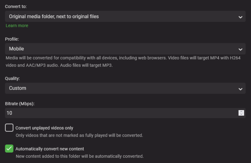

Guest Posted February 3, 2022 Posted February 3, 2022 Hello, I setup a conversion job to automatically convert every new media file added to a specific folder. The settings for this job are set like this: Most files are converted without a problem but there are some files that are always stuck at downloaded and wont be converted nor removed from the list. So far I tried removing the specific download list entry aswell the whole conversation job which just leads to the same file beeing stuck at downloaded again while other freshly added files are being converted and later on removed from the list. Sadly this is happening to a lot of files lately: Searching for a solution I already found someone else running into the same issue and I can indeed confirm what has been said in this this thread: the files being listed there are files which are worked on right now. Finished conversions are removed. This is no history or what so ever. I will attach some logs later on.
