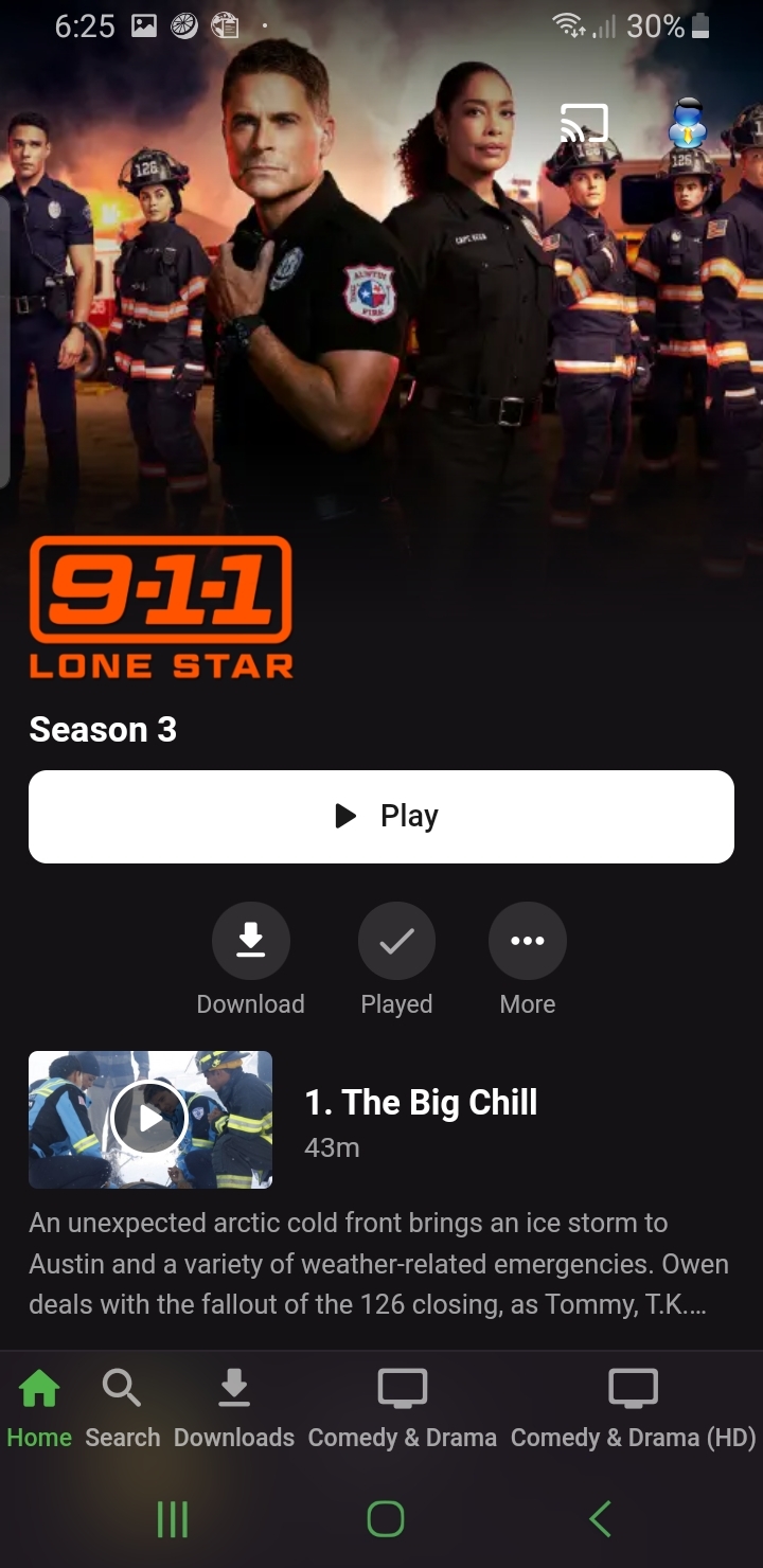

Today I added a new TV series The Big Leap and s03e01 of 9-1-1 Lone Star as well as new episodes of NCIS and NCIS Hawaii.
Emby scraped the information and displays it correctly.
However it only saved nfo/thumbs for NCIS and NCIS Hawaii.
The Big Leap folder is emoty other than the media files. Season 3 folder of 9-1-1 Lone Star is the same.

Screenshot_20220104-182553_Emby.thumb.jpg.d7b87bbc7e5c3e11702ee072507c7c6e.jpgScreenshot_20220104-183454_Emby.thumb.jpg.6d47019a82c4fb138021868689af84a4.jpgScreenshot_20220104-182056_FX.thumb.jpg.f66c639ba0fe1a6742deedfe3d36fa13.jpgScreenshot_20220104-184005_FX.thumb.jpg.a76f01ff60a71e3892089a25b2fb23d8.jpg
