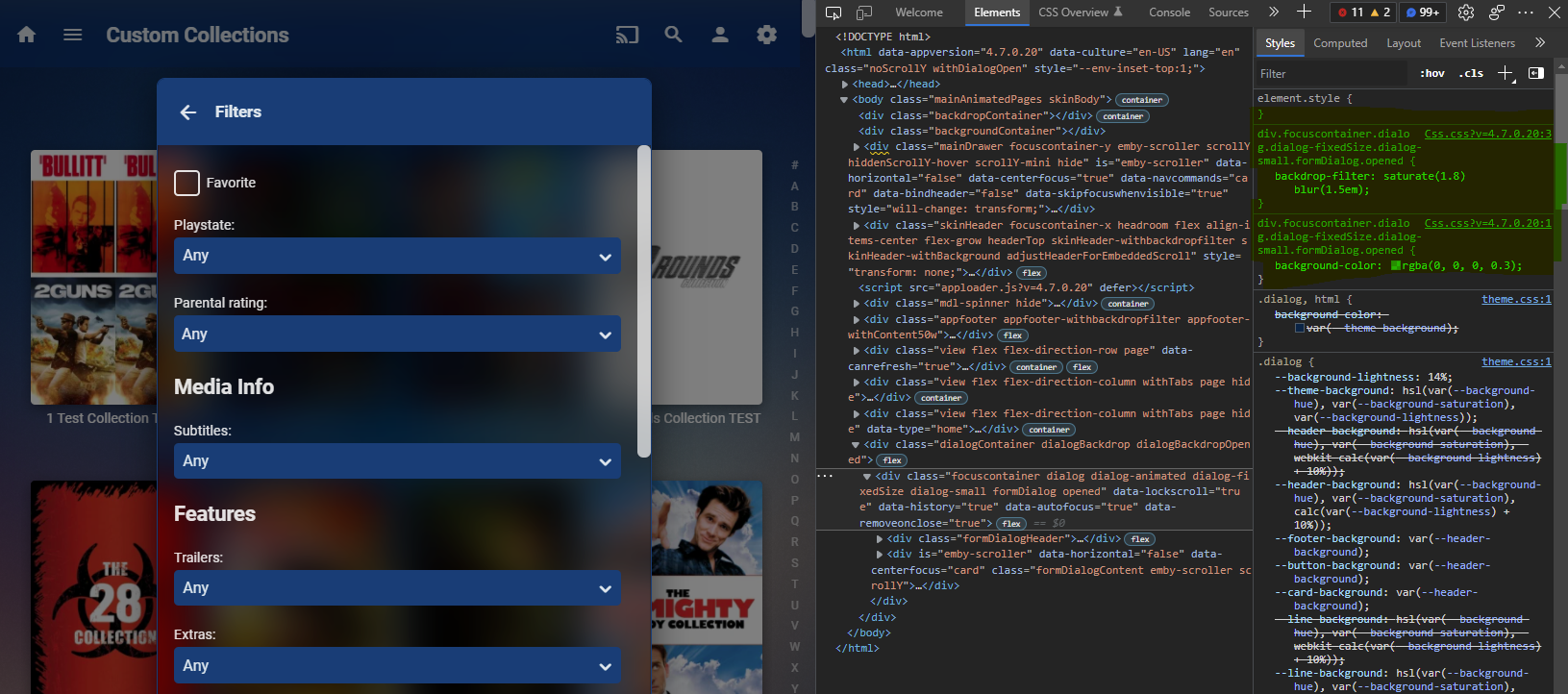

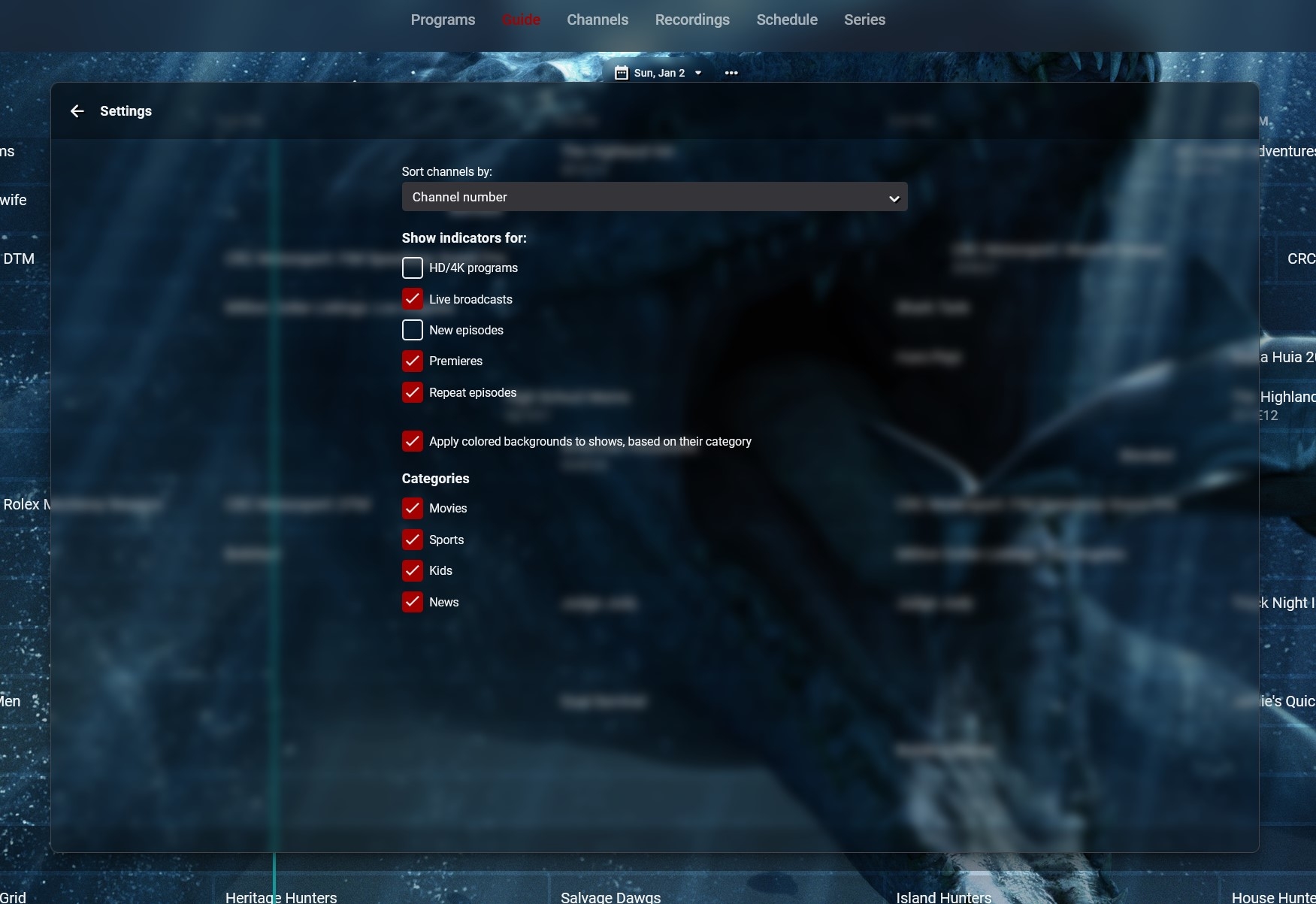

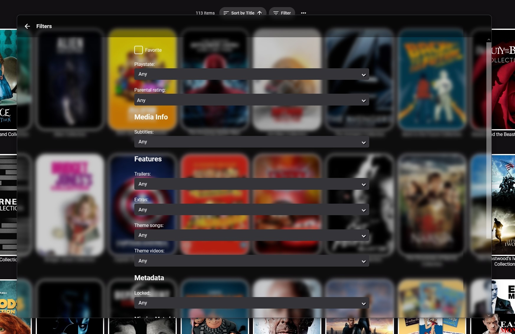

arrbee99 1712 Posted January 2, 2022 Posted January 2, 2022 Me again. Have css coming out of my ears trying to get blur, well more blur and darkening to work where I want it. It seems that these two narrow lists are the same thing on different pages (Collections and TV Guide in this case) - and these two options are the same on different pages would anyone know how to separate the css for them so I can apply different effects (mostly make one darker than the other) to them ? My latest attempt at css (if I've copied the right bit) is div.formDialogContent:not{div.focuscontainer.dialog) {background-color: rgba(0, 0, 0, 0.4);} Think that was aimed at the later (wide) images above Got lots of other bits but I'm getting lost in it all... 1

arrbee99 1712 Posted January 14, 2022 Author Posted January 14, 2022 Don't suppose anyone has any thoughts on how to fix up the blur that got broke. I had stuff like this /* Make WIDE list items e.g. Three Dots Menu, Filters, TV guide items transparent and blurry */ div.focuscontainer.dialog.dialog-fixedSize.dialog-small.formDialog.opened {background-color: rgba(0, 0, 0, 0.3);} div.focuscontainer.dialog.dialog-fixedSize.dialog-small.formDialog.opened {backdrop-filter: saturate(1.8) blur(1.5em);} but its like the first bit works but the backdrop-filter does nothing (unless it's nothing to do with that I suppose...)
Happy2Play 9441 Posted January 15, 2022 Posted January 15, 2022 18 hours ago, arrbee99 said: Don't suppose anyone has any thoughts on how to fix up the blur that got broke. I had stuff like this /* Make WIDE list items e.g. Three Dots Menu, Filters, TV guide items transparent and blurry */ div.focuscontainer.dialog.dialog-fixedSize.dialog-small.formDialog.opened {background-color: rgba(0, 0, 0, 0.3);} div.focuscontainer.dialog.dialog-fixedSize.dialog-small.formDialog.opened {backdrop-filter: saturate(1.8) blur(1.5em);} but its like the first bit works but the backdrop-filter does nothing (unless it's nothing to do with that I suppose...) May need more info as it works on the elements you have applied
arrbee99 1712 Posted January 15, 2022 Author Posted January 15, 2022 Thats weird. Just occurred to try in Chrome, and it seems fine in Chrome but doesn't work in Firefox, but it used to work in Firefox, which I use 95% of the time... Fine in Edge as well. I could try going back to .19, but family are using Emby at the mo.
arrbee99 1712 Posted January 15, 2022 Author Posted January 15, 2022 looks like its a Firefox thing - https://stackoverflow.com/questions/63789769/why-backdrop-filter-in-firefox-dont-work Something to do with version 96. 1

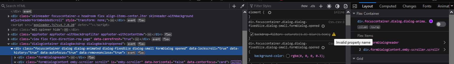

Happy2Play 9441 Posted January 15, 2022 Posted January 15, 2022 11 minutes ago, arrbee99 said: Thats weird. Just occurred to try in Chrome, and it seems fine in Chrome but doesn't work in Firefox, but it used to work in Firefox, which I use 95% of the time... Fine in Edge as well. I could try going back to .19, but family are using Emby at the mo. Will do some research but FireFox shows "invalid property name"
arrbee99 1712 Posted January 15, 2022 Author Posted January 15, 2022 (edited) and - https://bugzilla.mozilla.org/show_bug.cgi?id=1749625 I saw that Invalid Property Name. Surprisingly, didn't know what it meant Edit - and this - https://bugzilla.mozilla.org/show_bug.cgi?id=1741779 Edited January 15, 2022 by arrbee99
Happy2Play 9441 Posted January 15, 2022 Posted January 15, 2022 Note applying the about:config options shown in stackoverflow topic removes the error but is not applied.
arrbee99 1712 Posted January 15, 2022 Author Posted January 15, 2022 Slightly interesting is when I click on say Filter in Emby the Filter item appears with a nice blurry background nice and smoothly, whereas in Chrome it judders into view.
