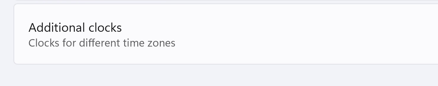

Marijuana 12 Posted December 7, 2021 Posted December 7, 2021 On 12/4/2021 at 8:22 PM, Painkiller8818 said: Yes from my provider i have a link to a php file with a code for my user, this complete link i just copy into the URL field for the m3u file and it works in emby. I don't have the m3u local on the pc so they can always update it online when they add new channels etc. There is a workaround for this to work, you need to set a second additional clock with your time zone etc and it will fix your issues.
Luke 40117 Posted December 7, 2021 Posted December 7, 2021 2 hours ago, Marijuana said: There is a workaround for this to work, you need to set a second additional clock with your time zone etc and it will fix your issues. Hi, an additional clock where?
Marijuana 12 Posted December 7, 2021 Posted December 7, 2021 On windows or any pc that hosts emby server, setting a 2nd clock on windows to your time zone and time fixes the emby time sync then embys guide is correct and matches perfectly.

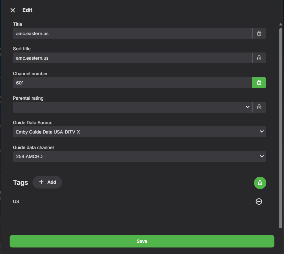

Carlo 4552 Posted January 17 Posted January 17 5 hours ago, Luke said: Hi, yes an option on the guide data source is certainly possible as well. If it could be added to the channel edit screen that would allow individual channel adjustments as needed not covered by the EPG offset. If adjusted and locked, it could be used to override a bad/wrong offset in the guide data as well. 1 1
