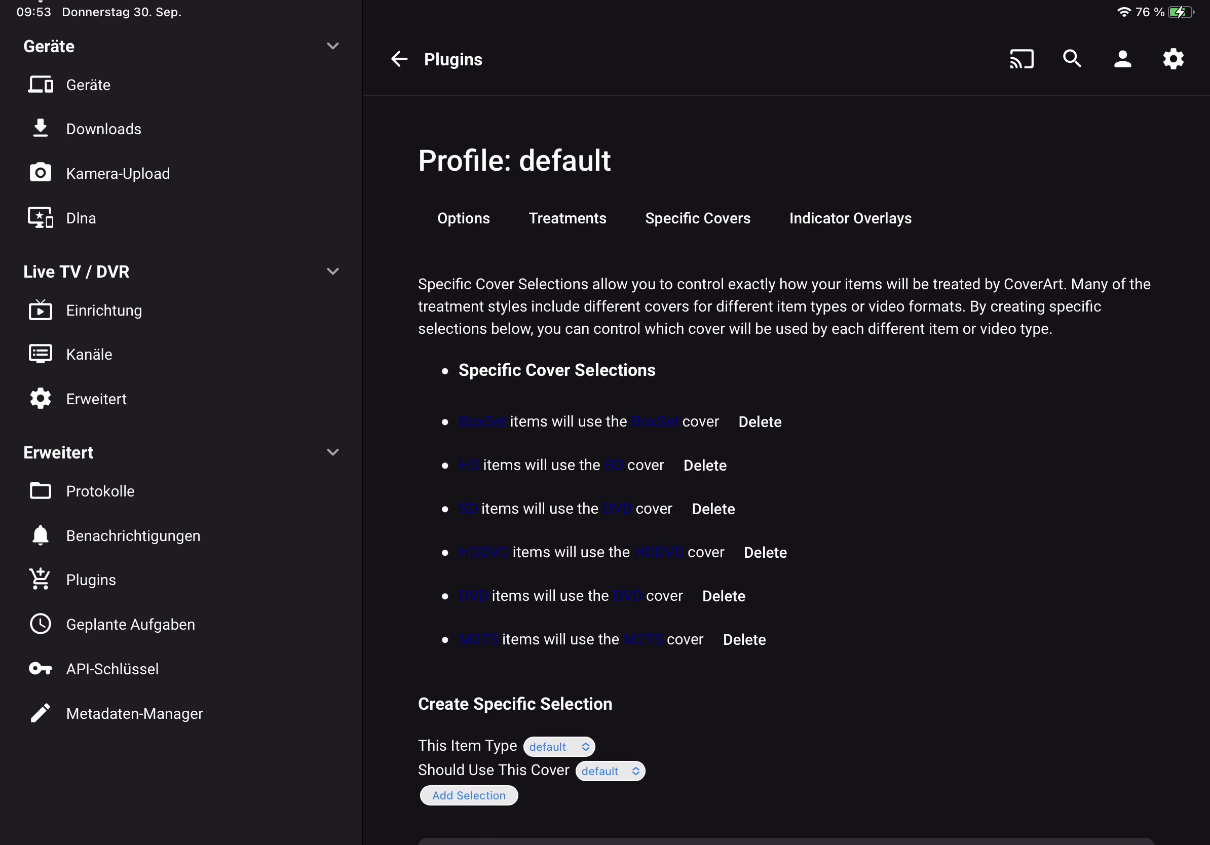

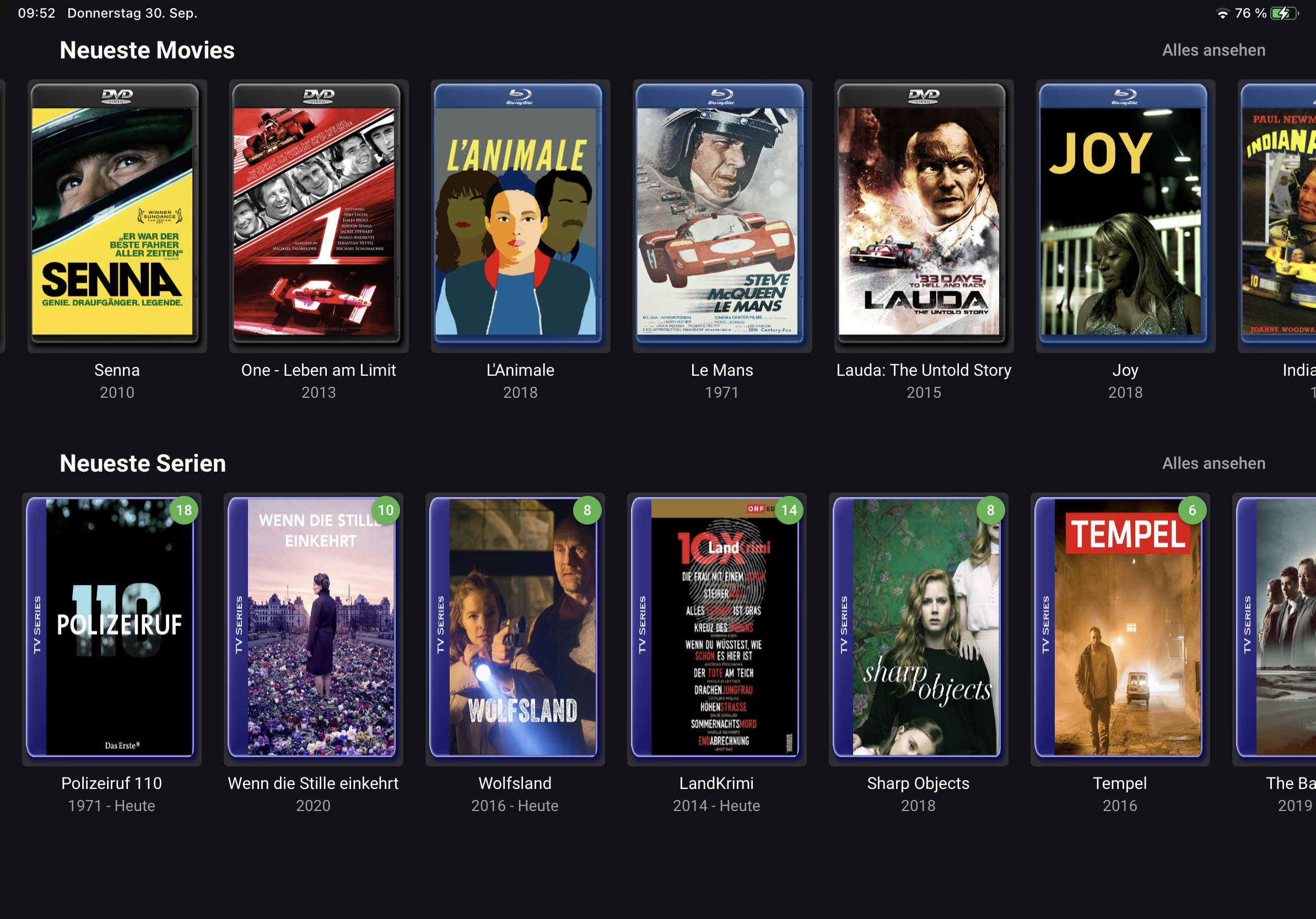

Anderella 13 Posted September 30, 2021 Posted September 30, 2021 Hi, basically I'm a new user and kind of checking out, if I go my further way with Plex or Emby. (after leaving Kodi) As I'm very impressed of the cover plugin, I'm trying to set this up - but couldn't figure the following out: 1) Is there a setting I miss that the series covers also show DVD or BLURAY..... instead of TV-Series. Maybe I'm blindfolded. 2) I managed to difference DVD and BLURAY (with setting "Cover by definition"), but I can't get my TV-recordings (*.ts files) to show up with other cover than Bluray. 3) I have different naming schemes for the "source" of my movies, example the file name containing: _[BLURAY] _[DVD] _[HDDVD] _[HDTV] Is there a way or possibility to implement/use those names for cover selection? Thank you for inputs.... screenshots enclosed.
ebr 15667 Posted September 30, 2021 Posted September 30, 2021 4 hours ago, Anderella said: Is there a setting I miss that the series covers also show DVD or BLURAY..... instead of TV-Series. Hi. No because TV Series are collections of many media files. They aren't media themselves. If you physically separate the types of series, you could use different profiles. More information:
Anderella 13 Posted October 4, 2021 Author Posted October 4, 2021 Hi, thanks for your reply and your inputs. Understand the problem, but is there any chance this could be implemented for seasons? (if all files are bluray or dvd based?) ### And do you have thoughts or advise for my questions 2 and 3? ::)) Thx. 2) I managed to difference DVD and BLURAY (with setting "Cover by definition"), but I can't get my TV-recordings (*.ts files) to show up with other cover than Bluray. 3) I have different naming schemes for the "source" of my movies, example the file name containing: _[BLURAY] _[DVD] _[HDDVD] _[HDTV] Is there a way or possibility to implement/use those names for cover selection?
ebr 15667 Posted October 4, 2021 Posted October 4, 2021 16 minutes ago, Anderella said: I managed to difference DVD and BLURAY (with setting "Cover by definition"), but I can't get my TV-recordings (*.ts files) to show up with other cover than Bluray. If they are all HD then that is the cover they will receive unless you map the "HD" cover to something else. 16 minutes ago, Anderella said: Is there a way or possibility to implement/use those names for cover selection? For movies, at least, you can use a special tag on the item (not the filename but a metadata tag) to indicate a cover. e.g. "ca-dvd" or "ca-bd".
Anderella 13 Posted October 4, 2021 Author Posted October 4, 2021 Again thank you for taking time to help me with my issue. I'm sorry, but I still don't see light at the end of my tunnel:) I checked "Cover by definition instead of type" And my specific cover selections are SD items will use DVD, HD items will use BD cover. Tried a lot, but cannot diferenciate the HD files (MKV files from bluray) and my HD files (TS files, tv-recordings). (My DVD files are also mkv files, but from DVDs) Use container instead of codec didn't work either. ### Do you know a way to write those tags you described in a kind of automated way?
ebr 15667 Posted October 4, 2021 Posted October 4, 2021 2 hours ago, Anderella said: Tried a lot, but cannot diferenciate the HD files (MKV files from bluray) and my HD files (TS files, tv-recordings) Hi. If they are all HD and you are using the cover by definition option, then they are all going to be the same cover...
Anderella 13 Posted October 20, 2021 Author Posted October 20, 2021 Hi, again me. As I'm still trying to reach my goal with different cover for my library, I tried with profiles, but still have not the awaited success, I need help - obviously I'm blindfolded: I put my TV-recordings (*.ts files and their folders) in a different main-folder and created a new profile for them. But the files in this folder again get the default covers (bluray) and not the specified ones. If I can provide any kind of logfile or further infos please let me know. Of course I also tried and restarted the server. Cross-Check: changing the default covers immediately changes the look (but also the specific folder covers) Thx for help, screenshots enclosed.
ebr 15667 Posted October 20, 2021 Posted October 20, 2021 I think the plugin doesn't understand the TS container so set that profile to cover by definition and then map the HD and SD covers to whatever you want these items to be treated with.
Anderella 13 Posted October 20, 2021 Author Posted October 20, 2021 Thank you, I will try. is there any source, where I can find the different cover layouts?
ebr 15667 Posted October 20, 2021 Posted October 20, 2021 1 minute ago, Anderella said: is there any source, where I can find the different cover layouts? Just go to the "Treatments" tab and select the drop down. All of the available ones are shown there. CoverArt 4.0
