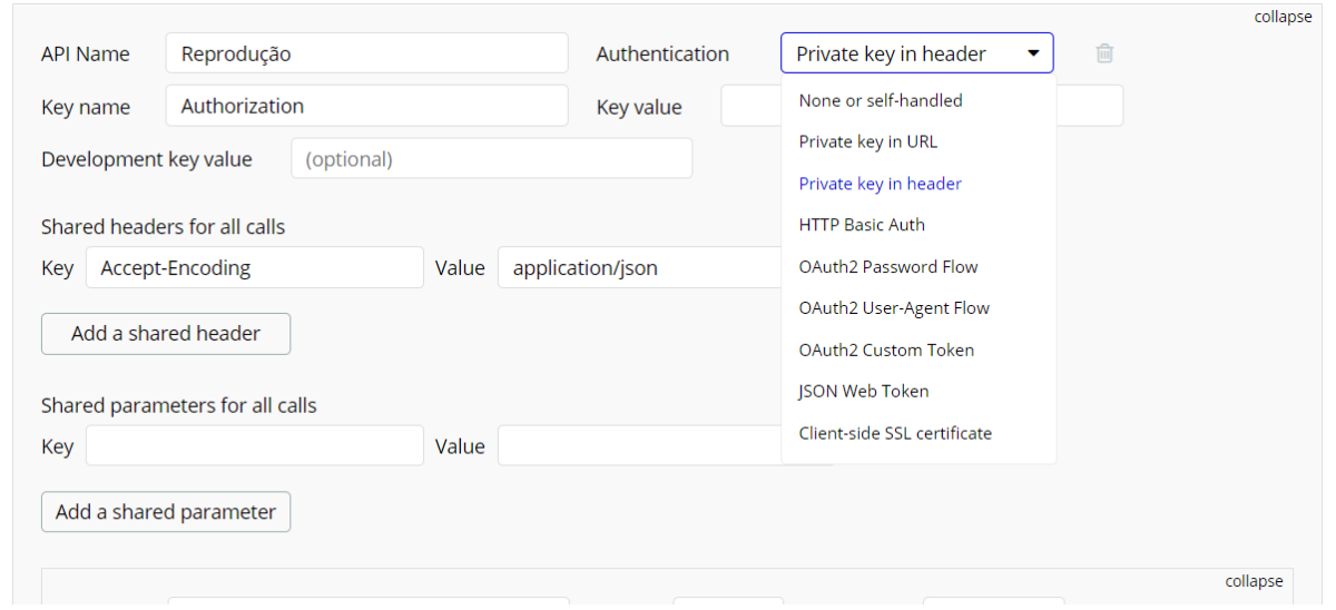

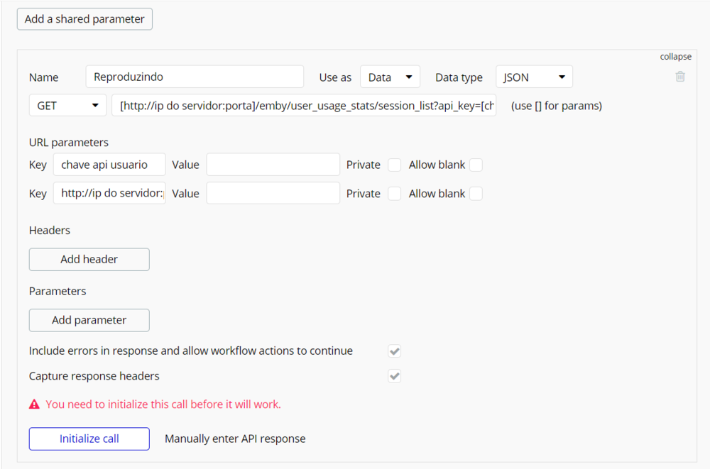

hygorfragas 5 Posted August 23, 2021 Author Posted August 23, 2021 (edited) In my test and work tool I have these fields to work with, do any of these options serve to do this? @TeamB Edited August 23, 2021 by hygorfragas

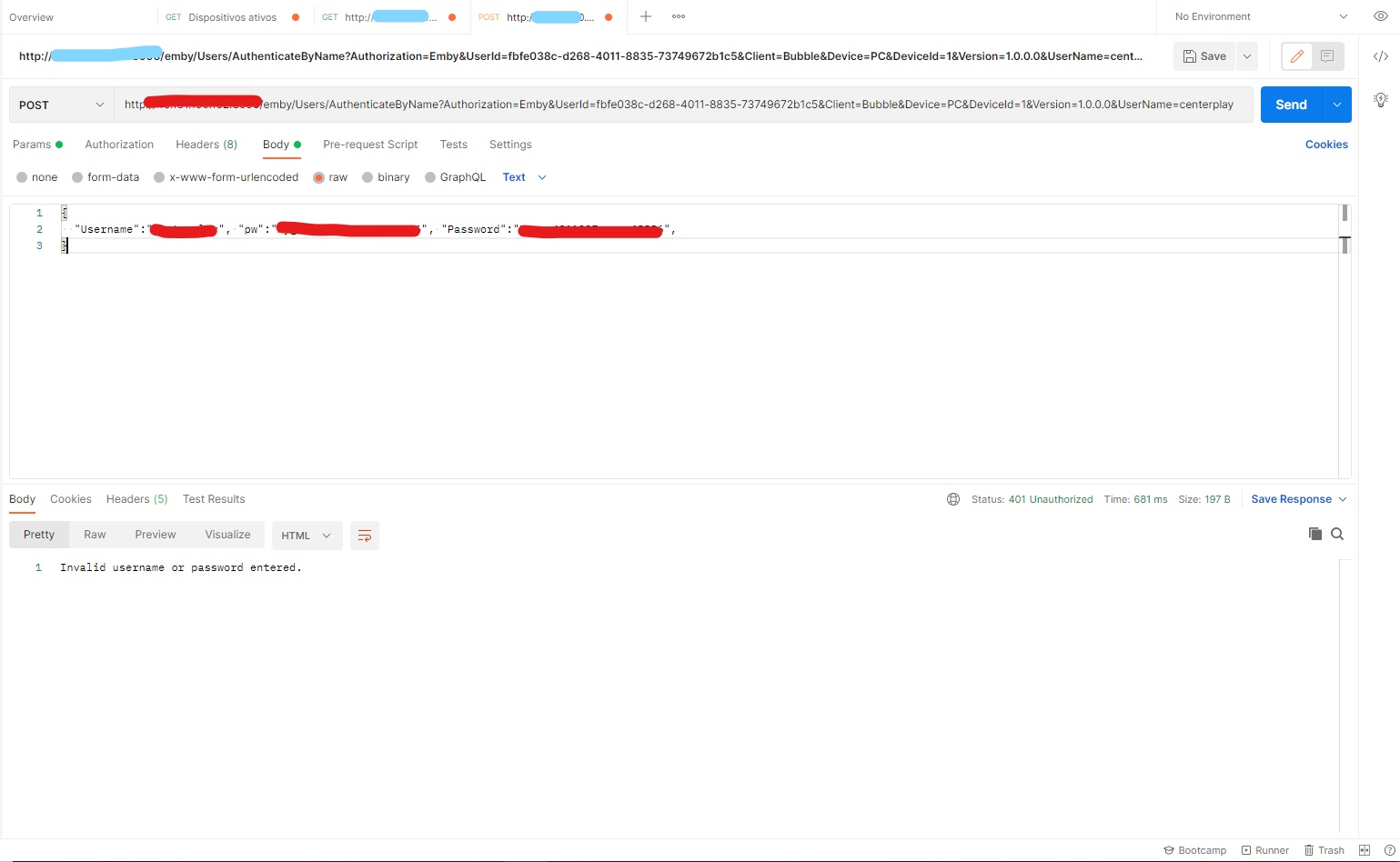

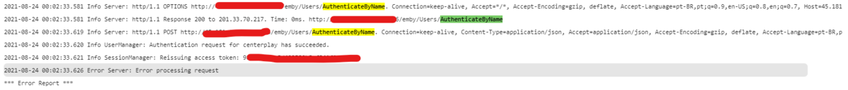

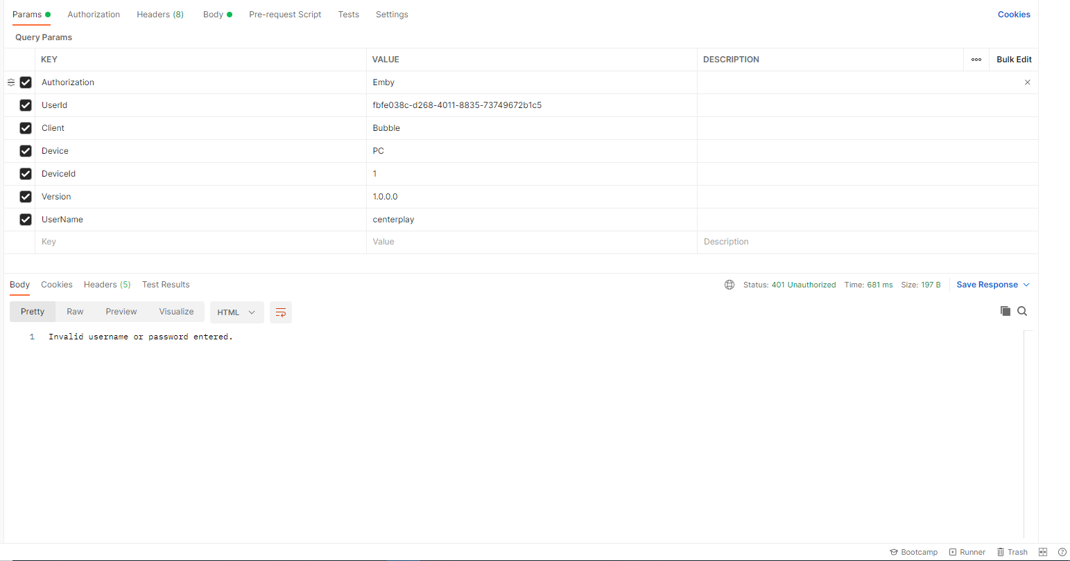

hygorfragas 5 Posted August 24, 2021 Author Posted August 24, 2021 (edited) 18 hours ago, TeamB said: You dont need the user id, just the username and password to request an access token Hello @TeamB Sorry for the delay, in the end I think I'm on the way. I recently did the tests for capturing the token in postman I got an incorrect username and password (which isn't) analyzing the server log I noticed that it generated the token but gave some error. can you help me? the postman call images are below along with the server log image with the response. Edited August 24, 2021 by hygorfragas

ebr 15665 Posted August 25, 2021 Posted August 25, 2021 Hi. It looks like you are putting the parameters that are supposed to be in the auth header as url params. Look closely at the Swagger doc for that call and be sure and get the x-emby-authorization header correct. You also shouldn't have a userID on an authenticate by name call although I doubt that is causing a problem. https://github.com/MediaBrowser/Emby/wiki/User-Authentication
