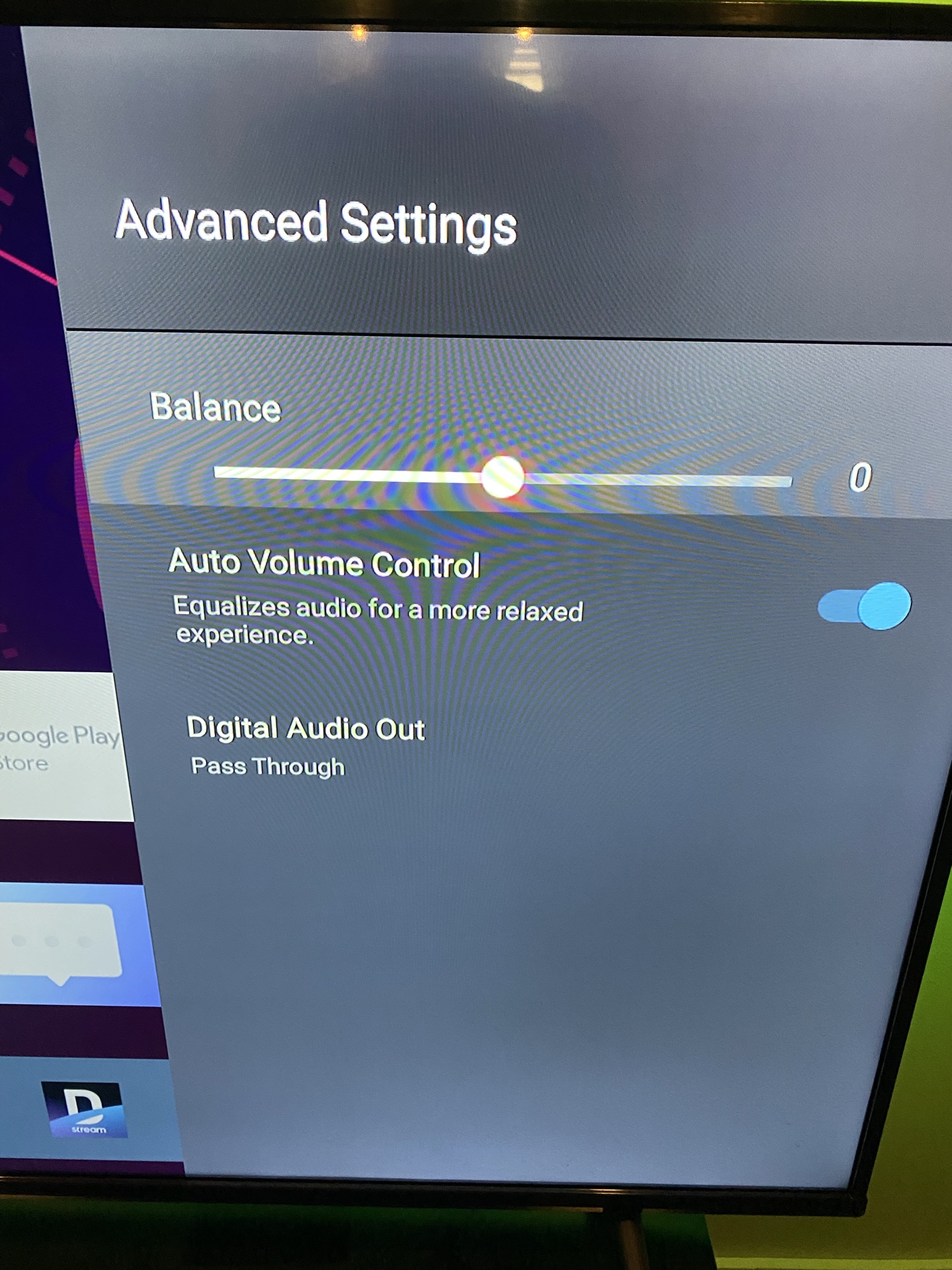

Main Audio on first picture, then Advance Settings on the next picture.
Okay, what are the options under "Sound Mode" and also "Digital Audio Out"?
Sound Mode:  Dynamic, Standard, Movie, Music, Voice, Live. Dynamic is enabled. Digital Audio Out: Pass Through, PCM, Auto, Off. Pass Through is enabled. I believe these are all a default settings.
Try changing the Digital Out to "Auto" and see what happens.
Changed to PCM, no effect, same with Auto.
