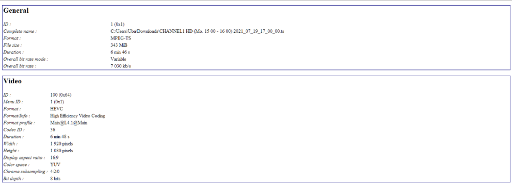

Carlo 4552 Posted July 19, 2021 Posted July 19, 2021 That looks about right to me for a 2K setting for bitrate. What does MediaInfo show for this file? https://mediaarea.net/en/MediaInfo
Carlo 4552 Posted July 19, 2021 Posted July 19, 2021 OK so that is in agreement with Emby. Have you tried this with the primary stream?
vaiuba 0 Posted July 19, 2021 Author Posted July 19, 2021 Same, recording bitrate matches Original stream bitrate, but not Emby Live Bitrate
