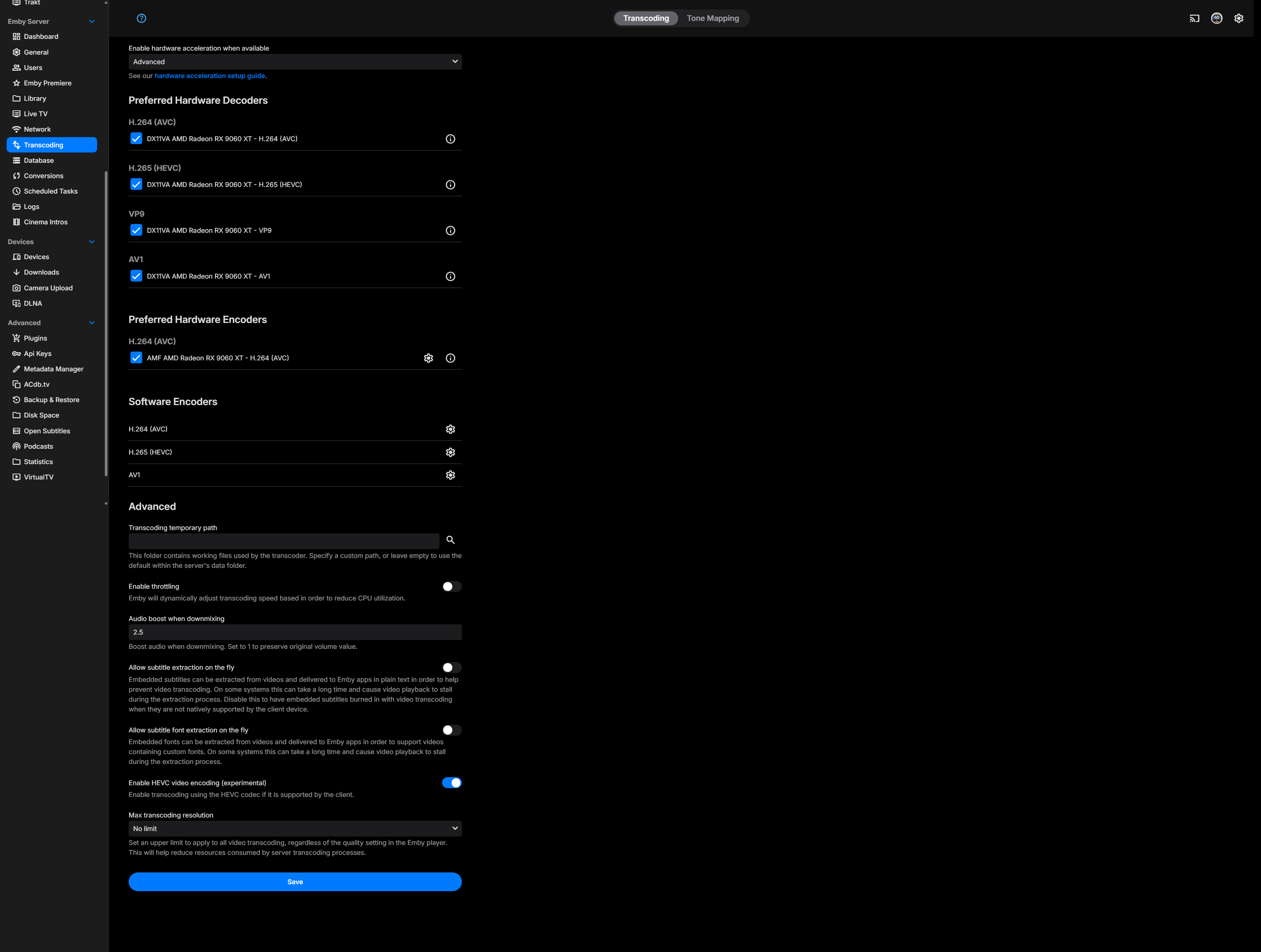

Whats wrong with the GPU I have? Its been decent for my gaming needs, why cant it work with hw acceleration? -

Well this is your issue, your hardware can't hack it, when it needs to transcode. File played : F:\\TV\\The Rookie\\The Rookie Season 2\\The Rookie S02E18 Under the Gun [1080p x265 q22 S85 Joy].mkv Its reverts to software because of you GPU can do what is needed. >>>>>> Processing Plan Name CanDoInHW WillDoInHW Reason DX11VA AMD Radeon RX 9060 XT - H.265 ... >> True True Hardware Codec VideoInput >> False False The sw pipeline builder does not support hw accelera... Scaling >> False False ColorConversion >> False False VideoOutput >> False False Not a hardware encoder x265 >> False False Software Codec >! ThrottleByStreamBufferSize: WARNING - Playback position too close to transcoding position: PlaybackPosition: 00:00:03 - TranscodingPosition: 00:00:06 - ThrottleBuffer: 3s 17:35:48.027 elapsed=00:00:18.85 frame= 181 fps=9.6 q=20.3 q=-1.0 size=N/A time=00:00:07.00 bitrate=N/A throttle=off speed=0.372x 17:35:48.081 elapsed=00:00:22.53 frame= 182 fps=8.1 q=23.7 q=-1.0 size=N/A time=00:00:07.04 bitrate=N/A throttle=off speed=0.313x 17:35:48.688 elapsed=00:00:23.10 frame= 187 fps=8.1 q=24.6 q=-1.0 size=N/A time=00:00:07.25 bitrate=N/A throttle=off speed=0.314x The values marked in RED should be above 1 just to keep up. -

Also why would I be trolling especially since it is shown in hwinfo64? -
