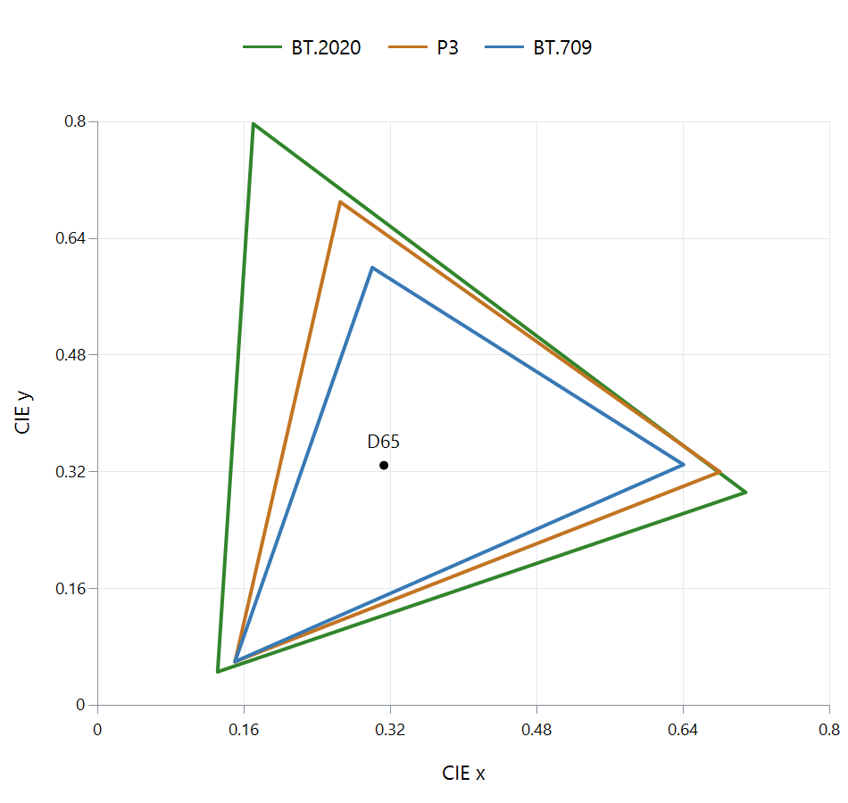

    Gamut mapping adapts colors that fall outside the range the target color space or display can reproduce.
    A neon green can be correctly described in BT.2020 coordinates and still lie outside the colors a BT.709 destination can produce. Gamut mapping chooses a reproducible replacement while managing the relationships among color, brightness, and neighboring detail.
    BT.2020, P3, and BT.709 primary triangles, showing colors outside the smaller target.
    Primary-coordinate plot, with luminance omitted. The line colors identify the gamuts rather than displaying their extreme primaries.
