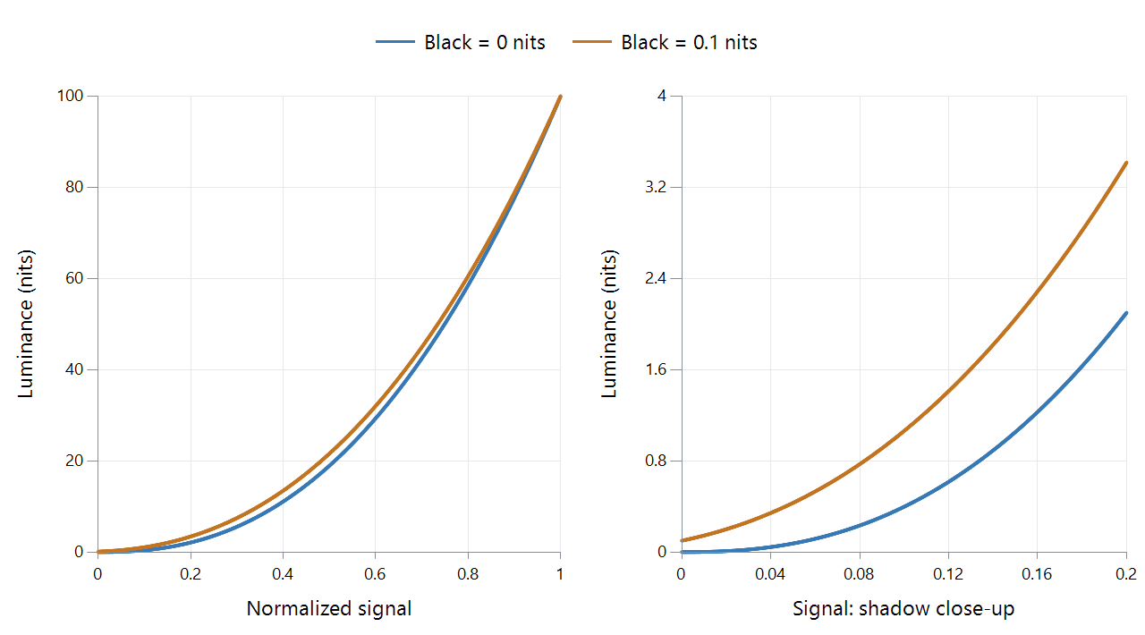

    ITU-R BT.1886 defines a reference SDR display response using a 2.4 exponent and the display black and white levels.
    A reference SDR display response needs more than a gamma number: its black floor and white level determine the light available at the endpoints. BT.1886 defines an EOTF for HDTV reference displays using those measured endpoint luminances and an exponent of 2.4.
    BT.1886 responses at 100-nit white with black levels of zero and 0.1 nit, including a shadow close-up.
    Calculated reference responses. The shadow panel shows the effect of the black floor; these are selected display parameters, not measurements of a television.
    Calculate the response from its endpoints
    Let Lw be white luminance, Lb black luminance, and V the normalized signal. With gamma = 2.4:
    a = (Lw^(1/gamma) − Lb^(1/gamma))^gamma
    b = Lb^(1/gamma) / (Lw^(1/gamma) − Lb^(1/gamma))
    L = a × max(V + b, 0)^gamma
    The coefficients make V = 0 reach the specified black and V = 1 reach the specified white. If black is zero, b becomes zero and a becomes Lw, leaving the familiar pure power response L = Lw × V^2.4.
    For 100-nit white, compare zero black with 0.1-nit black:
    Signal V Light at zero black Light at 0.1-nit black
    0 0 nits 0.1 nit
    0.1 0.398 nit 1.064 nits
    0.5 18.946 nits 21.605 nits
    1 100 nits 100 nits
    The second response reaches the higher black floor and redistributes the lower tones to meet the same white. It is not obtained simply by adding 0.1 nit to every output of the zero-black curve.
