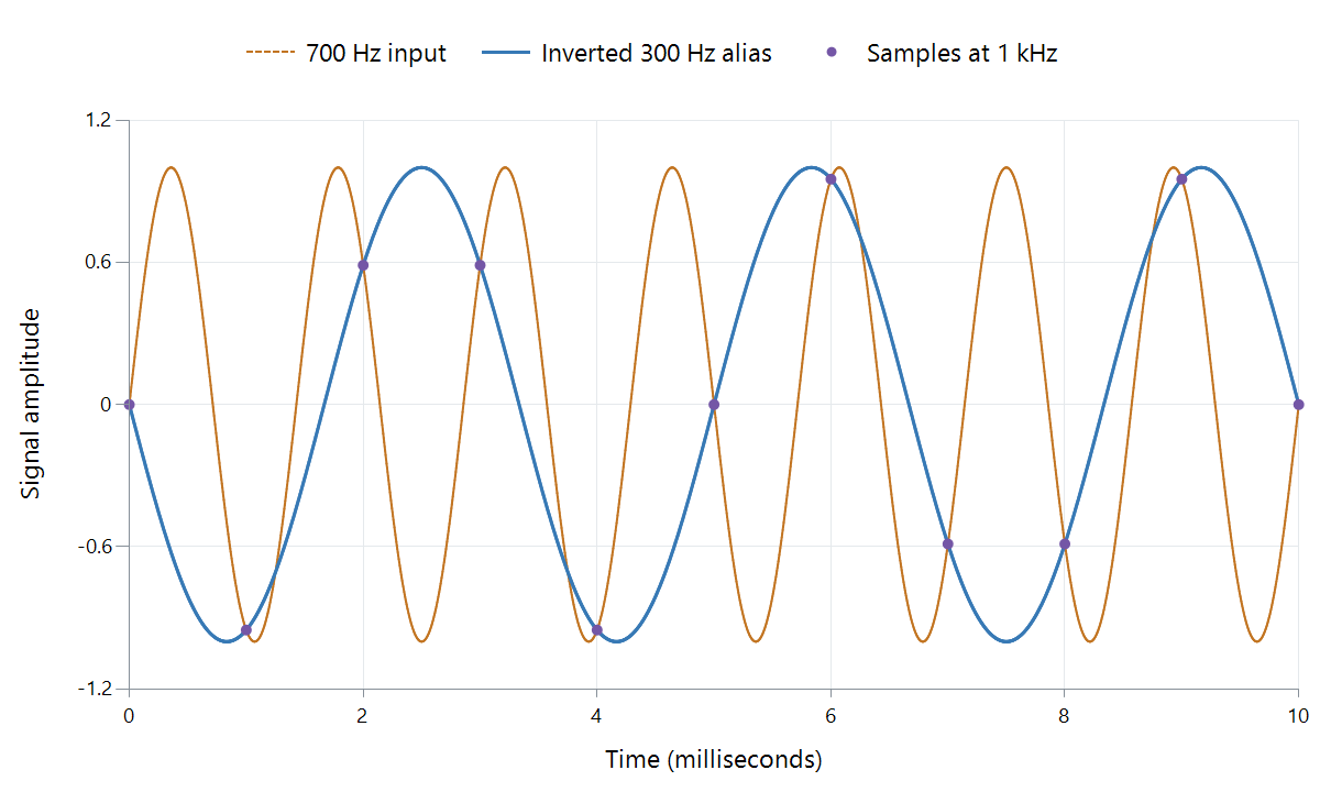

    Two different sine waves agree at the sample positions
    Calculated example at a deliberately low 1 kHz rate: a 700 Hz sine and an inverted 300 Hz sine give identical samples. The continuous curves differ; the measured dots do not.
    At sample index n, the first signal is sin(2π × 700 × n/1,000). The second is −sin(2π × 300 × n/1,000). Their phases differ by whole cycles at these instants, giving the same values:
    Sample index Time Either sampled amplitude
    0 0 ms 0
    1 1 ms About −0.951
    2 2 ms About +0.588
    3 3 ms About +0.588
    A receiver given only that sequence cannot decide which original sine existed. Recording systems filter before sampling to prevent such ambiguity. Practical filters also require a transition band, so the Nyquist number is an ideal boundary rather than a guaranteed flat recording bandwidth.
