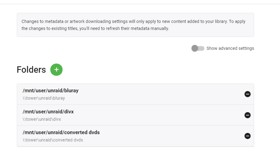

Carlo 4563 Posted July 13, 2021 Posted July 13, 2021 Hi, that is strange. Are all your movies in a Movies library setup with type "Movies"? Can you show us a picture of your movie library?
gnollo 17 Posted July 13, 2021 Author Posted July 13, 2021 I can see this happening in the movies view. If I open some movies (not all), and mark it watched, it will turn a large group of movies into watched (the 19 most recent movies). If I do that on older movies, that I have added some time ago, does not trigger the behaviour.

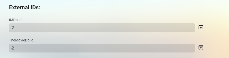

Solution ebr 16946 Posted July 13, 2021 Solution Posted July 13, 2021 What are the tmdb/imdb IDs on these items?
Luke 43428 Posted July 13, 2021 Posted July 13, 2021 Yea if you use the metadata editor, I think you'll see they have incorrect values, and possibly many with the same value.
gnollo 17 Posted July 14, 2021 Author Posted July 14, 2021 14 hours ago, Luke said: Yea if you use the metadata editor, I think you'll see they have incorrect values, and possibly many with the same value. Well spotted. Checked two movies and they both have the same... I checked the movies.xml file in the folder for one of them, <IMDB_ID> has the correct IMDB Id but emby does not seem to pull that in. These other two are instead incorrect in the file <TMDB>-2</TMDB> <TMDB_ID>-2</TMDB_ID>
Carlo 4563 Posted July 14, 2021 Posted July 14, 2021 Hi, so as mentioned, once you clean that up it should work as expected. Just curious, but why so many files with bad meta-data in them? How are your files names and organized on disc? Are you following our Knowledge Base on file naming? https://support.emby.media/support/solutions/articles/44001159102-movie-naming
gnollo 17 Posted July 14, 2021 Author Posted July 14, 2021 I use Media Center Master. I must have messed out with the fetchers, as it was not using TMDB (hence no values). I fixed it, refreshed the metadata, all fixed now. Thanks for your help! 1
