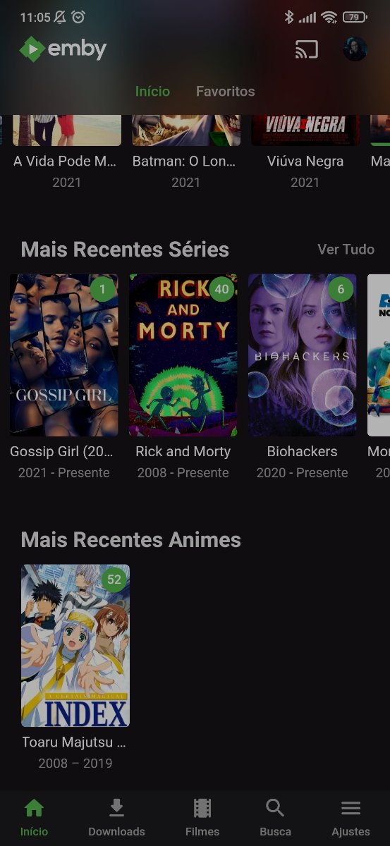

Can you go over an example of something that is missing, that should be showing there.
16 minutes ago, Happy2Play said:
Você pode repassar um exemplo de algo que está faltando, que deveria estar aparecendo ali.

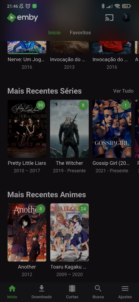

In the case when new media are added to the library, the current ones from the recent tab disappear, as for example in the screenshot I attached to the topic there is the media "To Aru no Index", now as I added new media to the library, it no longer appears there and is showing only the ones that the emby just recognized, as you can see in the screenshot I attached in this comment.

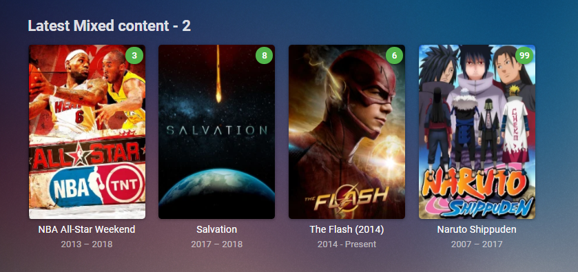

@Lukeis there a date added that would cause the mixed content merged series to drop off Latest Mixed Content library row?
All series have a 2019 added date beside the one display and it has a 2021 added date.  As soon as I add a new item to all the other series they do appear.
Date added option set to file creation date.

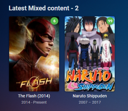

added a new episode to The Flash
Same happens adding new item to other series.

But what is making older items fall off the list?  Images above show the issue.
  • Agree 1
  • 2 weeks later...
The grouping is happening after the limiting, that's the part that needs to be improved.
