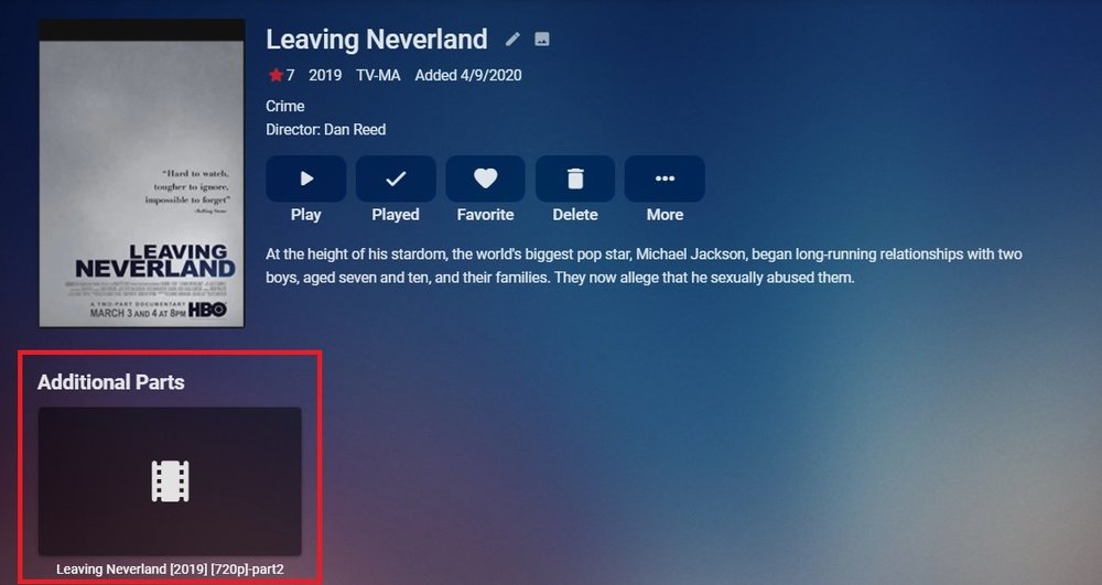

Happy2Play 9813 Posted July 15, 2021 Posted July 15, 2021 Best guess is the naming scheme as "part x" will be our files stacking naming scheme for multi part media. See Split video files (file stacking) section If you open the part that Emby does see do you see the other parts attach to that item in the UI? example
