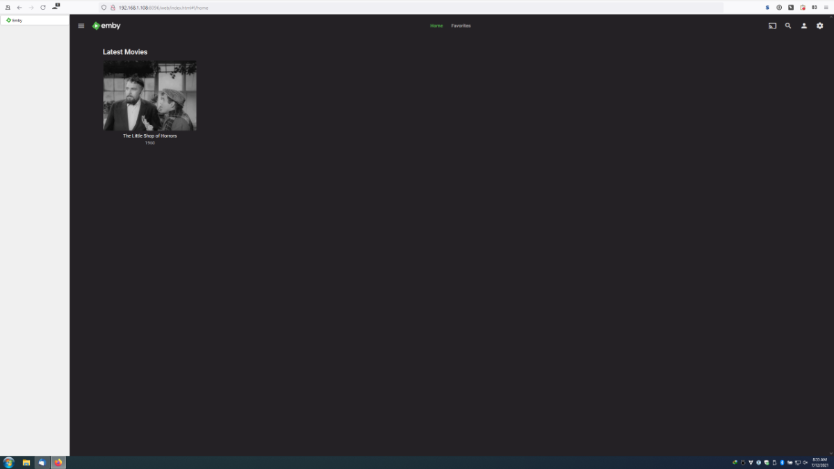

ng4ever 40 Posted July 12, 2021 Posted July 12, 2021 I just get a screenshot. How do I fix this please? Thanks.

ng4ever 40 Posted July 12, 2021 Author Posted July 12, 2021 I think it has something to do with access to the internet or file access write after updating OS. Forgot I posted in the wrong forum. I run the server on Synology NAS with DSM 7 now. It was on DSM 6.

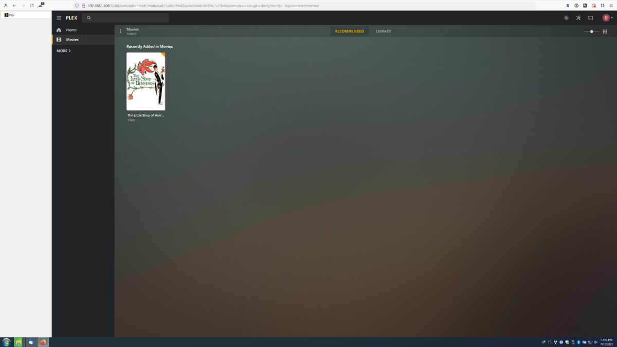

ng4ever 40 Posted July 12, 2021 Author Posted July 12, 2021 2 hours ago, rbjtech said: In a browser on the same machine, using the same interface - see if it can get to https://www.themoviedb.org/ If it can, then it could simply be load issues with themovedb - there is nothing emby can do about that - you just need to try again. Do you know if Plex uses the same site ? Going to try it as well just for a test.
ng4ever 40 Posted July 12, 2021 Author Posted July 12, 2021 (edited) @rbjtechhow can it be load issues if it works in Plex and Jellyfin ? I just tried as a test. Edited July 12, 2021 by ng4ever
