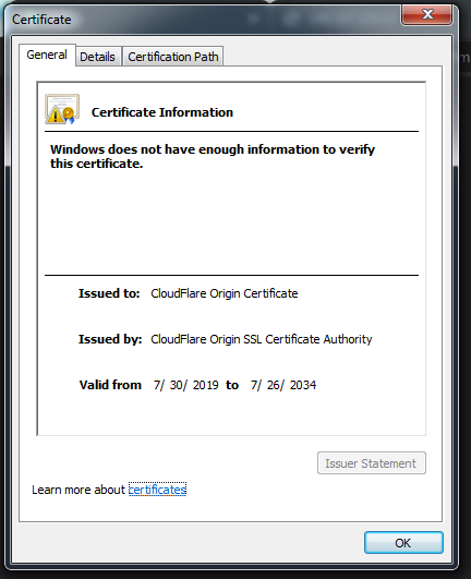

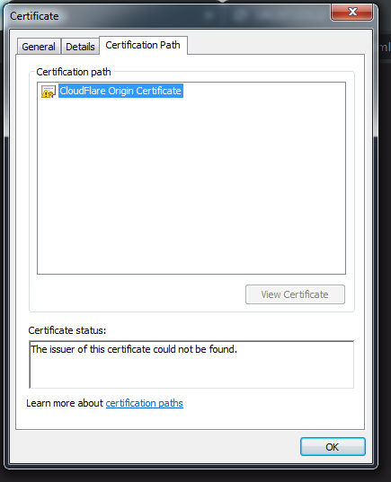

crusher11 1134 Posted July 12, 2021 Author Posted July 12, 2021 9 minutes ago, vdatanet said: Well, that’s progress. If you click on the browser security lock, what information does the ssl certificate give you?
vdatanet 1619 Posted July 12, 2021 Posted July 12, 2021 I have no experience with Cloudflare because I use Nginx, but it looks like the browser connects directly to the server instead of using the Cloudflare proxy. Cloudflare origin certificate certificate is not trusted - Security - Cloudflare Community

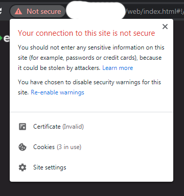

crusher11 1134 Posted July 12, 2021 Author Posted July 12, 2021 7 minutes ago, vdatanet said: I have no experience with Cloudflare because I use Nginx, but it looks like the browser connects directly to the server instead of using the Cloudflare proxy. Cloudflare origin certificate certificate is not trusted - Security - Cloudflare Community Because we changed CloudFlare from proxied to DNS only. I changed it back. https://domain is still not secure, but now it says the certificate is valid.
vdatanet 1619 Posted July 12, 2021 Posted July 12, 2021 1 minute ago, crusher11 said: Because we changed CloudFlare from proxied to DNS only. I changed it back. https://domain is still not secure, but now it says the certificate is valid. Clear the browser cache.
crusher11 1134 Posted July 12, 2021 Author Posted July 12, 2021 (edited) 9 minutes ago, vdatanet said: Clear the browser cache. https://domain is now secure. remoteip:443 still gives an empty response error though. Not that people should be accessing it via IP anyway. Edited July 12, 2021 by crusher11

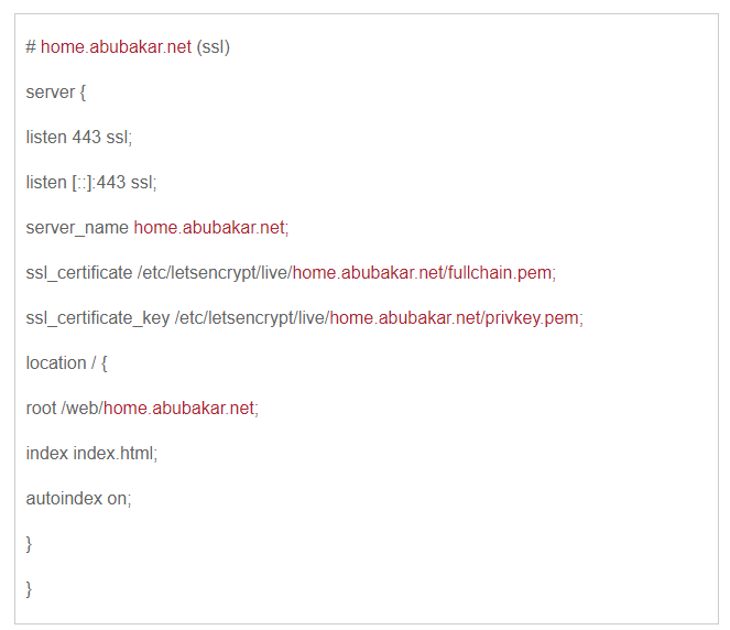

vdatanet 1619 Posted July 12, 2021 Posted July 12, 2021 1 minute ago, crusher11 said: Well mine seems to be relative to something, and I'm not sure how having it in a docker container affects things either. NGINX and SSL On Docker on Synology NAS | Life, The Universe and ... Everything! (abubakar.net)
vdatanet 1619 Posted July 12, 2021 Posted July 12, 2021 Forget what you had before, it didn't work, you had it set up Emby - Cloudflare.
vdatanet 1619 Posted July 12, 2021 Posted July 12, 2021 (edited) Perhaps this document is clearer: Things Ian Says :: Enabling https with Nginx, Docker, and LetsEncrypt (ian-says.com) You have to use the mount path: Edited July 12, 2021 by vdatanet
