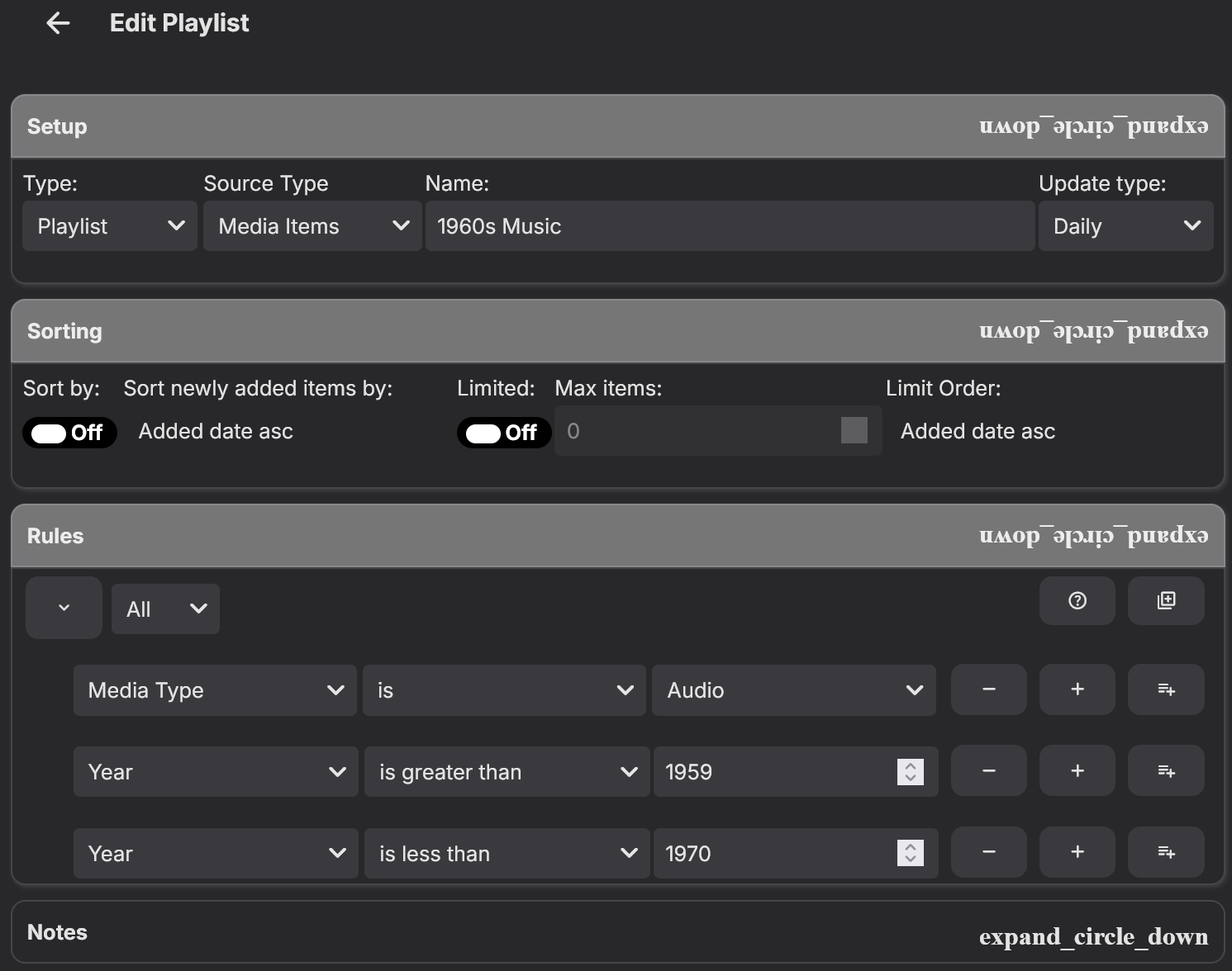

KevinSartori 22 Posted August 14, 2024 Posted August 14, 2024 (edited) On 8/11/2024 at 12:21 PM, PuffyToesToo said: As reported by others, I am having issues getting my playlists to populate. I have several playlists that have the same parameters, save for file locations. (They are music playlists by decade set to update daily). No matter what parameters I set, two of them refuse to populate any content, despite copying the settings from the others. Using Emby 4.8.8.0 and plugin version 2.5.5.0. These are some pretty basic parameters. Any advice? I'm certainly no expert with Smart Playlist, but I wonder if the issue is with Path? If your files are all tagged correctly, you shouldn't need that. Here's my 1960s Music playlist: Edited August 14, 2024 by KevinSartori 1

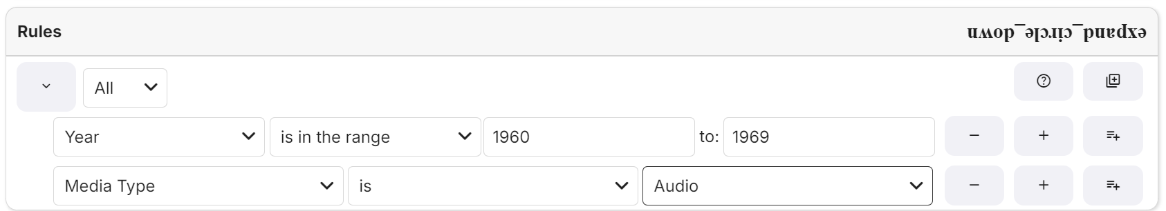

user24 354 Posted August 14, 2024 Posted August 14, 2024 Checking the Path(s) for all the Decades sounds like a good idea. Another method for a 60s decade playlist could be to use the following two Rules: I haven't been having any problems with this method (so far - fingers crossed). 1
KevinSartori 22 Posted August 14, 2024 Posted August 14, 2024 user24, I hadn't noticed that "is in the range" option before. Nice! I love the simplification! 1
PuffyToesToo 348 Posted August 15, 2024 Posted August 15, 2024 Thank you for the help, both of you. I tried your suggestions and nothing would work. So I just ended up creating new ones with a different name under your parameters. I'll se ehow that goes! They did populate, but mine did originally and then just stopped. Thank you so much! 1

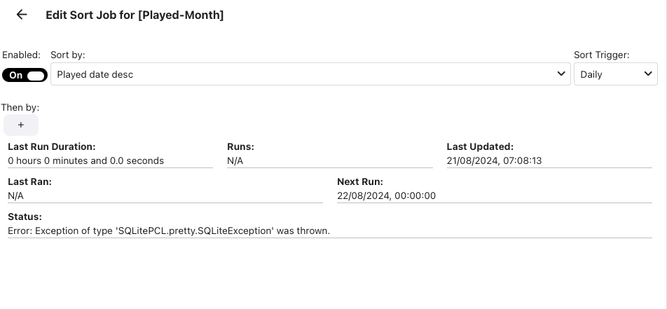

Cluttered 15 Posted August 21, 2024 Posted August 21, 2024 Just upgraded to 4.8.8.4 and smartplaylists 2.5.0.4810 which I think is the latest (I had to search through the posts to find it, is there a better way?). Anyway a number of my playlists are empty, I need to investigate those. I also have an sql error in one and they all have problem with some button images, I'm on a Mac using the latest Monterey. SQL Error Missing graphics? Missing graphics?

bobbyzero 4 Posted August 22, 2024 Posted August 22, 2024 On 21/08/2024 at 08:20, Cluttered said: Just upgraded to 4.8.8.4 and smartplaylists 2.5.0.4810 which I think is the latest (I had to search through the posts to find it, is there a better way?). Anyway a number of my playlists are empty, I need to investigate those. I also have an sql error in one and they all have problem with some button images, I'm on a Mac using the latest Monterey. SQL Error Same thing happening for me, the smart playlist log shows it completed, but the emby log shows smart playlist errors: 2024-08-22 20:00:02.275 Info App: Sqlite: 1 - incomplete input in "delete from ListItems where " 2024-08-22 20:00:02.277 Error App: [SmartPlaylist][Error]: Exception of type 'SQLitePCL.pretty.SQLiteException' was thrown.
Bernie V 7 Posted August 26, 2024 Posted August 26, 2024 On 8/22/2024 at 8:02 PM, bobbyzero said: Same thing happening for me, the smart playlist log shows it completed, but the emby log shows smart playlist errors: 2024-08-22 20:00:02.275 Info App: Sqlite: 1 - incomplete input in "delete from ListItems where " 2024-08-22 20:00:02.277 Error App: [SmartPlaylist][Error]: Exception of type 'SQLitePCL.pretty.SQLiteException' was thrown. I'm having also these issues.
