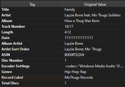

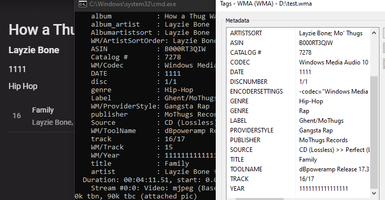

koopa8840 24 Posted July 13, 2021 Posted July 13, 2021 30 minutes ago, mbarylski said: I don't think it works that way anymore because most fields are tag driven. Adding the metadata to the tags makes it permanent and available to other apps like Plex. At this point we need a response from Luke. @Luke Is Emby reading WM/Year? If not, it seems like it needs to be added unless there's some other way to get the year added in metadata for an album that doesn't exist in MusicBrainz. That said, i'm not even getting years for albums that ARE in MusicBrainz. I added the MusicBrainz Album ID for this one yesterday and it's still not showing a year. Do you have a metadata downloader enabled in the library settings? As you can see, I have no Year or Date set via the tag, but I do have the MB tags and Emby's fetchers enabled.

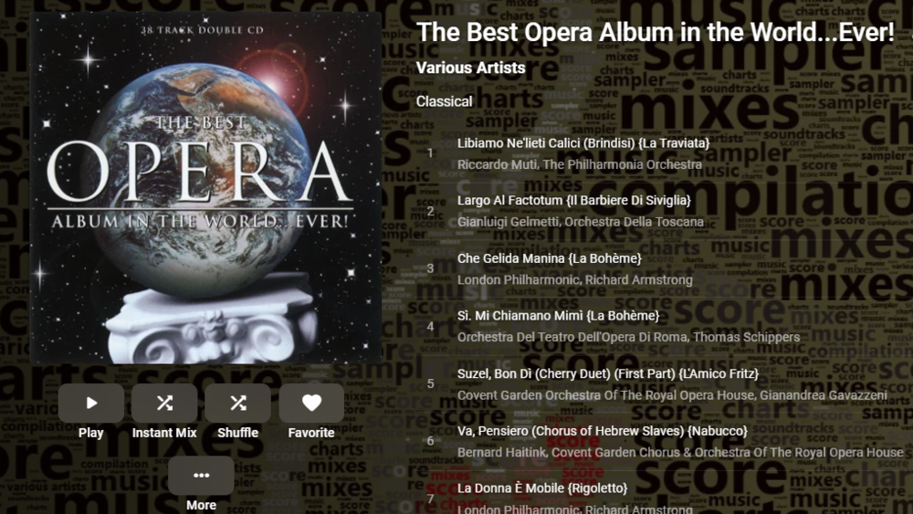

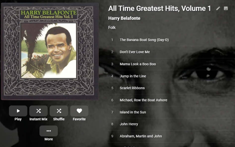

MBSki 1115 Posted July 13, 2021 Author Posted July 13, 2021 The only thing I'm seeing with the ones that don't work are the Album title's have punctuation. Harry Belafonte - All Time Greatest Hits, Volume 1 Includes a comma Various Artists - Are You Hip-Hop's Biggest Fan? Question mark at the end of title that can't be added in mp3Tag So far that's all I've found. Still appears to be an issue with wma though.
MBSki 1115 Posted July 13, 2021 Author Posted July 13, 2021 Here's another one with punctuation that I can't get to load the year. @Luke In the past I've had to change the actual folder name to exactly match the album in order for metadata to populate correctly. Unfortunately, I can't add some punctuation to folder names in Windows. Is that why these aren't loading? Is Emby trying to match exactly WITH punctuation?

koopa8840 24 Posted July 14, 2021 Posted July 14, 2021 (edited) 1 hour ago, mbarylski said: I already tried that and it doesn't work. What program did you use? In Picard, under the Tag column, Date is actually WM/Year. I tried adding a DATE tag and Picard wouldn't accept it. However, in Mp3Tag, I added a DATE tag, gave it a date, refresh Emby and the year appears. Edited July 14, 2021 by koopa8840

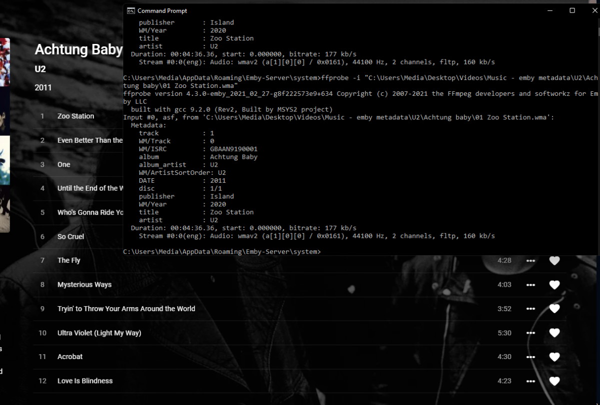

Happy2Play 9802 Posted July 14, 2021 Posted July 14, 2021 Using the Date method works for me also. Just took a couple minutes for everything to update after I Refreshed the Album.

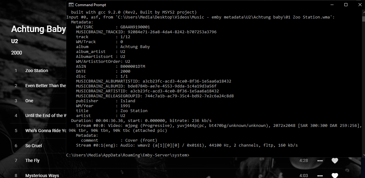

Happy2Play 9802 Posted July 14, 2021 Posted July 14, 2021 Changed Date from 2011 to 2000 and Refreshed Album. Processed in mp3tag to get other ids but you can see the Date field being used. But in the end @Lukeneeds to comment on WM/Year. Ideally I would think this needs to be added. But there does appear to be a workaround adding an addition tag Date.

koopa8840 24 Posted July 14, 2021 Posted July 14, 2021 32 minutes ago, mbarylski said: Yea, I did the same thing and it didn't work. Are your files wma? Yes. If you look in my screenshots, you will see "codec = Windows Media Audio" and "D:\test.wma" 8 minutes ago, Happy2Play said: Changed Date from 2011 to 2000 and Refreshed Album. Processed in mp3tag to get other ids but you can see the Date field being used. But in the end @Lukeneeds to comment on WM/Year. Ideally I would think this needs to be added. But there does appear to be a workaround adding an addition tag Date. I agree.
MBSki 1115 Posted July 14, 2021 Author Posted July 14, 2021 3 minutes ago, koopa8840 said: Yes. If you look in my screenshots, you will see "codec = Windows Media Audio" and "D:\test.wma" I agree. I'm trying it again now. Waiting...waiting... 1
MBSki 1115 Posted July 14, 2021 Author Posted July 14, 2021 And there it is!! @koopa8840 You're right! Son of a gun. Man, what a pain though. How is any user going to figure that out. @Luke Please respond. Looks like there's a gap in the metadata being pulled for wma's. Please fix.
Happy2Play 9802 Posted July 14, 2021 Posted July 14, 2021 As mentioned Picard Date=Year / WM/Year and mp3Tag Date is its own DATE field.
