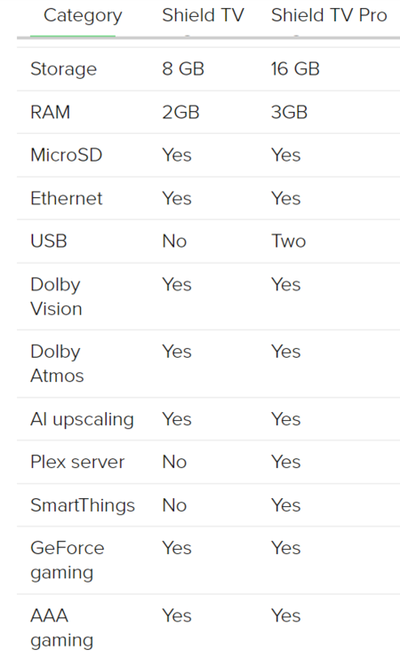

justinrh 267 Posted July 11, 2021 Posted July 11, 2021 11 hours ago, vdatanet said: Ohhh, sorry to tell you this device sucks. And why does the non-Pro suck and the Pro doesn't suck? Both have the same capability, with the main diff between them is just storage, correct?
vdatanet 1619 Posted July 11, 2021 Posted July 11, 2021 (edited) 10 minutes ago, justinrh said: And why does the non-Pro suck and the Pro doesn't suck? Both have the same capability, with the main diff between them is just storage, correct? RAM 2 Gb instead of 3 Gb and 32 bits instead of 64 bits. In my opinion, the problem is in the firmware, there's a memory leak. Shield TV 2019 (tube) & High Bitrate Content | NVIDIA GeForce Forums The hotfix doesn't fix this. So for Nvidia the issue is fixed, but the truth is that it is not fixed. Edited July 11, 2021 by vdatanet 1
