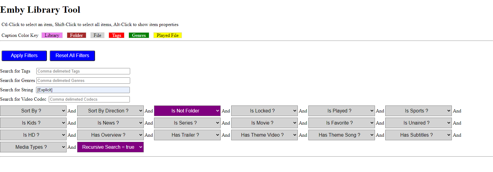

MBSki 1115 Posted December 29, 2021 Posted December 29, 2021 @VicMoore I was looking at the filters you added and wondering if there was a way to filter by keyword. Here's my use case: I have songs with [Explicit] in the title of the song. I'd like to tag these so I can filter them out of my kids view. It seems the filter is only to filter on tags. Is that right or am I just doing something wrong?
VicMoore 755 Posted December 29, 2021 Author Posted December 29, 2021 Hi Mbarylski... You can filter on a "string." You can also filter on Geners, Tags, and many other things. So you would filter on "[Explicit]" and then tag the results Vic
MBSki 1115 Posted December 30, 2021 Posted December 30, 2021 42 minutes ago, VicMoore said: You can filter on a "string." You can also filter on Geners, Tags, and many other things. So you would filter on "[Explicit]" and then tag the results Hmmm, ok. That's what I thought, but I can't get it to work. Any idea what I'm doing wrong? Here's my filter: And here is an example of a song with explicit in the filename and Title tag.
VicMoore 755 Posted December 30, 2021 Author Posted December 30, 2021 You should search on [Explicit] not "[Explicit]" Vic
Happy2Play 9811 Posted December 30, 2021 Posted December 30, 2021 Quick test on this I could only get Search string [Explicit] to work at Artist folder not Music folder. So there appears to be a limit on the String search. @VicMoore

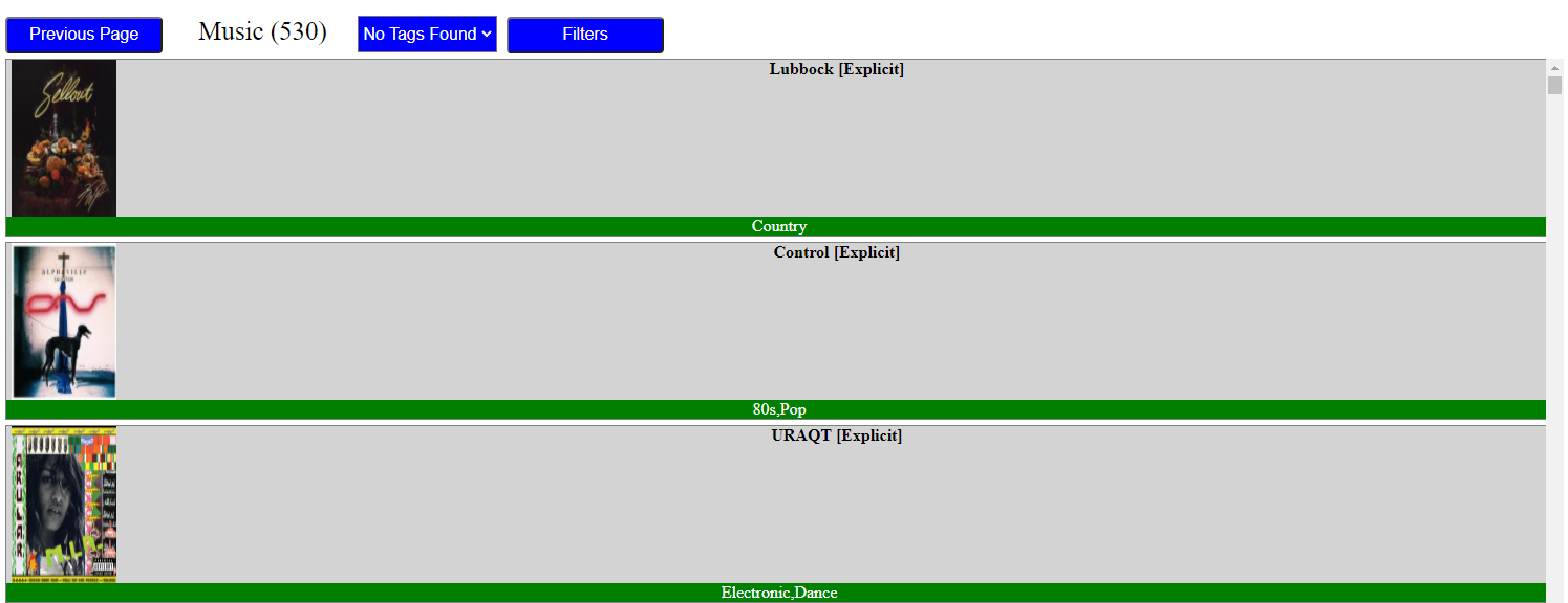

MBSki 1115 Posted January 3, 2022 Posted January 3, 2022 2 hours ago, VicMoore said: Mbarylski, I have some time now. Could you explain the problem to me again? I tried the scenario you gave earlier and I thought it worked. So, I guess that I didn't really understand the problem. Sometimes, I am a bit slow You are my top priority. Vic No problem, thank you so much @VicMoore! So when I go to my Music in the tool, I see a list of all my albums. I click filter so I can do a keyword search on Explicit which I have in the filename of each Explicit song as well as in the Title. When I click on "Apply Filters" I get no results. It just says No Tags found even though I wasn't looking for tags, I was looking for a string of text within the Title or the song's filename. What I'd like it to do is pull back all the individual songs that have explicit in the filename or Title so I can select all those songs and apply an Explicit tag.
Happy2Play 9811 Posted January 3, 2022 Posted January 3, 2022 @VicMoore @mbarylski I figured it out looking at the query. From library level filter it has "Filters=IsFolder" and from Artist it does not. music library query Quote http://localhost:8097/emby/Users/{userid}/Items?Recursive=true&ParentId={parentid}&Fields=Genres,ParentId,Tags&Filters=IsFolder&Recursive=true&SearchTerm=[Explicit] query within Artist folder Quote http://localhost:8097/emby/Users/{userid}/Items?Recursive=true&ParentId={parentid}&Fields=Genres,Overview,Tags&Recursive=true&SearchTerm=[Explicit] So from library you have apply "is not folder" filter also to get what you want. 1
MBSki 1115 Posted January 3, 2022 Posted January 3, 2022 That worked! Thanks @Happy2Play! So I get 530 matches. @VicMoore, any chance you could add a select all button?
