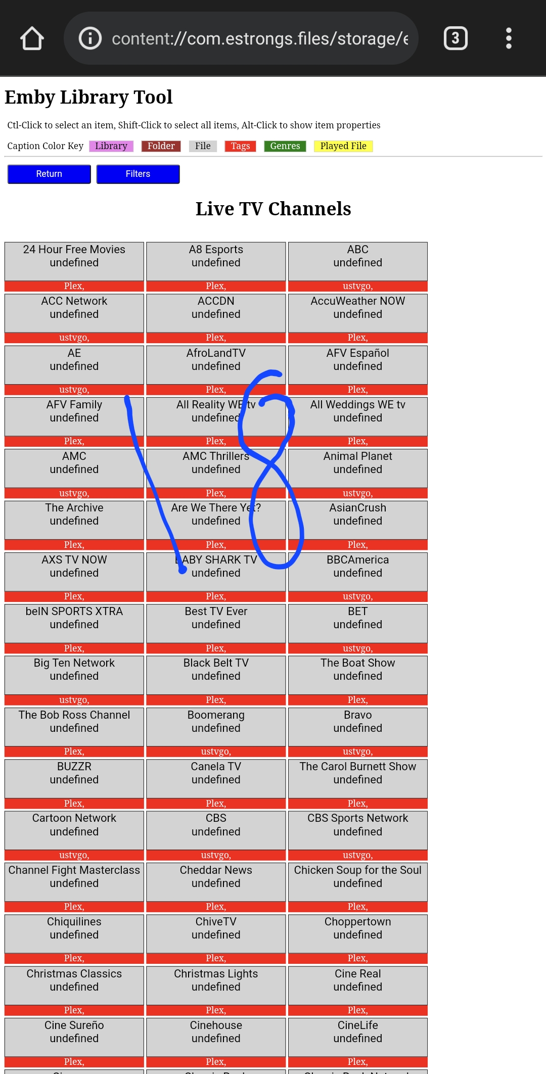

VicMoore 755 Posted December 16, 2021 Author Posted December 16, 2021 Good morning Kanipek... I changed the code to use the actual channel numbers defined for channels. Test it out and see if it works OK. Yarafie, please also check to make sure everything works for you also. Does anyone want additional info included with the channels? Vic EmbyTagApp18.html

kanipek 230 Posted December 16, 2021 Posted December 16, 2021 44 minutes ago, VicMoore said: Test it out and see if it works OK Works exactly as I would expect! Thank You!

yarafie 6 Posted December 16, 2021 Posted December 16, 2021 1 hour ago, VicMoore said: Good morning Kanipek... I changed the code to use the actual channel numbers defined for channels. Test it out and see if it works OK. Yarafie, please also check to make sure everything works for you also. Does anyone want additional info included with the channels? Vic EmbyTagApp18.html 169.13 kB · 3 downloads Works right didn't really notice channel numbers until you pointed it out V18 is more correct since you are using the channel number from channel metadata I assume.
