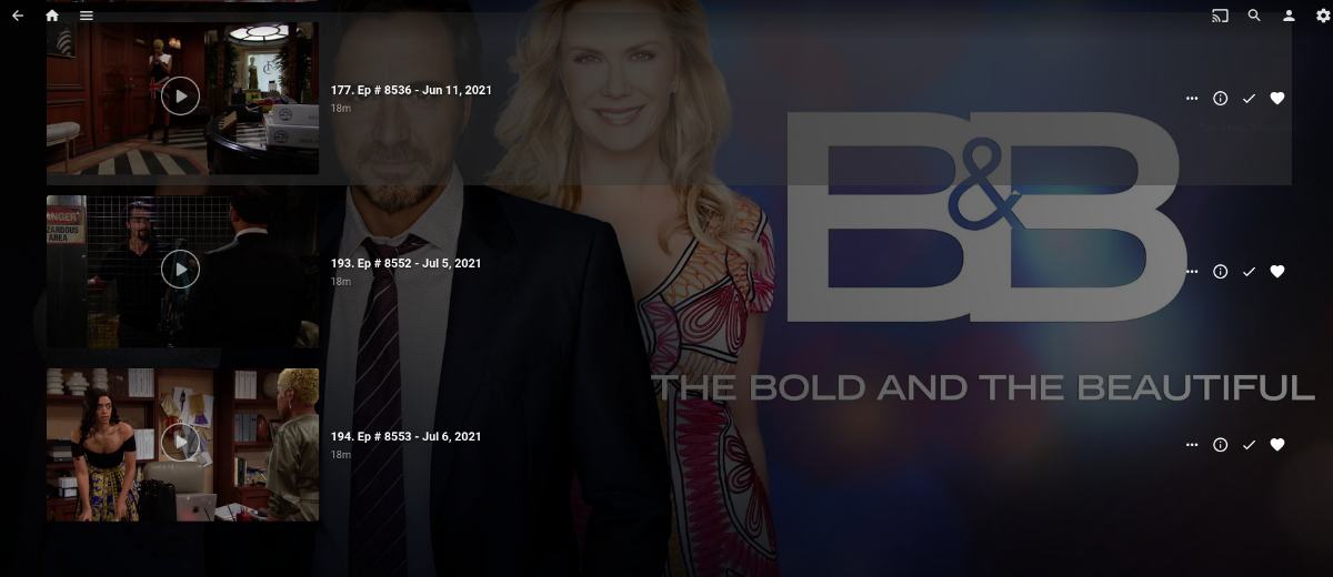

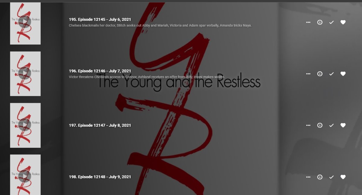

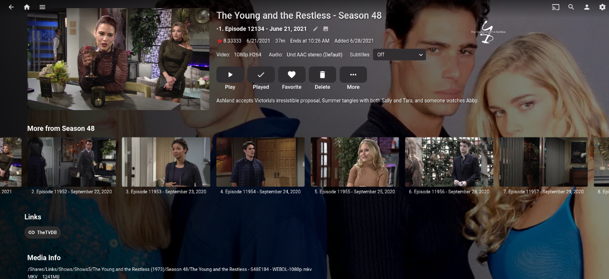

syralk 13 Posted July 8, 2021 Posted July 8, 2021 (edited) Hi it seem that some videos are not found in emby its happen when I have a show with alot of episodes in one season 2 shows to that so far The Young and the Restless (1973) and The Bold and the Beautiful (1987) both of them have more then 150 episodes. if I take the example of The Young and the Restless (1973) the last episode found is 177 and on of the missing one is label as episode -1 then the rest is not present This is the files list from 183 to the 195 'The Young and the Restless - S48E183 - WEBDL-1080p.nfo' 'The Young and the Restless - S48E183 - WEBDL-1080p-thumb.jpg' 'The Young and the Restless - S48E184 - WEBDL-1080p.mkv' 'The Young and the Restless - S48E184 - WEBDL-1080p.nfo' 'The Young and the Restless - S48E184 - WEBDL-1080p-thumb.jpg' 'The Young and the Restless - S48E185 - WEBDL-1080p.mkv' 'The Young and the Restless - S48E185 - WEBDL-1080p.nfo' 'The Young and the Restless - S48E185 - WEBDL-1080p-thumb.jpg' 'The Young and the Restless - S48E186 - WEBDL-1080p.mkv' 'The Young and the Restless - S48E186 - WEBDL-1080p.nfo' 'The Young and the Restless - S48E186 - WEBDL-1080p-thumb.jpg' 'The Young and the Restless - S48E187 - WEBDL-1080p.mkv' 'The Young and the Restless - S48E187 - WEBDL-1080p.nfo' 'The Young and the Restless - S48E187 - WEBDL-1080p-thumb.jpg' 'The Young and the Restless - S48E188 - WEBDL-1080p.mkv' 'The Young and the Restless - S48E188 - WEBDL-1080p.nfo' 'The Young and the Restless - S48E188 - WEBDL-1080p-thumb.jpg' 'The Young and the Restless - S48E189 - WEBDL-1080p.mkv' 'The Young and the Restless - S48E189 - WEBDL-1080p.nfo' 'The Young and the Restless - S48E189 - WEBDL-1080p-thumb.jpg' 'The Young and the Restless - S48E190 - WEBDL-1080p.mkv' 'The Young and the Restless - S48E190 - WEBDL-1080p.nfo' 'The Young and the Restless - S48E190 - WEBDL-1080p-thumb.jpg' 'The Young and the Restless - S48E191 - WEBDL-1080p.mkv' 'The Young and the Restless - S48E191 - WEBDL-1080p.nfo' 'The Young and the Restless - S48E191 - WEBDL-1080p-thumb.jpg' 'The Young and the Restless - S48E192 - WEBDL-1080p.mkv' 'The Young and the Restless - S48E192 - WEBDL-1080p-thumb.jpg' 'The Young and the Restless - S48E193 - WEBDL-1080p.mkv' 'The Young and the Restless - S48E193 - WEBDL-1080p-thumb.jpg' 'The Young and the Restless - S48E194 - WEBDL-1080p.mkv' 'The Young and the Restless - S48E194 - WEBDL-1080p.nfo' 'The Young and the Restless - S48E194 - WEBDL-1080p-thumb.jpg' 'The Young and the Restless - S48E195 - WEBDL-1080p.mkv' 'The Young and the Restless - S48E195 - WEBDL-1080p.nfo' 'The Young and the Restless - S48E195 - WEBDL-1080p-thumb.jpg' Edited July 8, 2021 by syralk

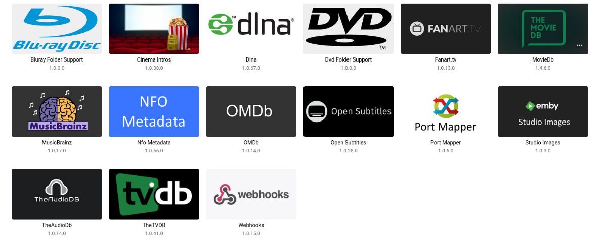

CaffNoir 22 Posted July 12, 2021 Posted July 12, 2021 51 minutes ago, syralk said: here my server logs -threads 0 -v info -print_format json -show_streams -show_chapters -show_format -show_data 2021-07-12 09:29:41.577 Debug MediaProbeManager: ProcessRun 'ffprobe' Started. 2021-07-12 09:29:41.603 Info MediaProbeManager: ProcessRun 'ffprobe' Process exited with code 0 2021-07-12 09:29:41.606 Debug App: Running EpisodeNfoProvider for /Shares/Links/Shows/Shows5/The Young and the Restless (1973)/Season 48/The Young and the Restless - S48E183 - Episode 12133 - June 18, 2021 WEBDL-1080p.mkv 2021-07-12 09:29:41.609 Debug SqliteItemRepository: Public GetItemLinks 2021-07-12 09:29:41.610 Debug App: Running PersonNfoProvider for Robert W. Arbogast 2021-07-12 09:29:41.610 Debug App: PersonNfoProvider returned no metadata for Robert W. Arbogast 2021-07-12 09:29:41.660 Debug SqliteItemRepository: Public GetItemLinks 2021-07-12 09:29:41.661 Debug App: Running PersonNfoProvider for Glenn Taranto 2021-07-12 09:29:41.661 Debug App: PersonNfoProvider returned no metadata for Glenn Taranto 2021-07-12 09:29:41.670 Debug App: Running FFProbeProvider for /Shares/Links/Shows/Shows5/The Young and the Restless (1973)/Season 48/The Young and the Restless - S48E184 - Episode 12134 - June 21, 2021 WEBDL-1080p.mkv 2021-07-12 09:29:41.673 Info MediaProbeManager: ProcessRun 'ffprobe' Execute: /bin/ffprobe -i file:"/Shares/Links/Shows/Shows5/The Young and the Restless (1973)/Season 48/The Young and the Restless - S48E184 - Episode 12134 - June 21, 2021 WEBDL-1080p.mkv" -threads 0 -v info -print_format json -show_streams -show_chapters -show_format -show_data 2021-07-12 09:29:41.674 Debug MediaProbeManager: ProcessRun 'ffprobe' Started. 2021-07-12 09:29:41.709 Info MediaProbeManager: ProcessRun 'ffprobe' Process exited with code 0 2021-07-12 09:29:41.713 Debug App: Running EpisodeNfoProvider for /Shares/Links/Shows/Shows5/The Young and the Restless (1973)/Season 48/The Young and the Restless - S48E184 - Episode 12134 - June 21, 2021 WEBDL-1080p.mkv 2021-07-12 09:29:41.717 Debug SqliteItemRepository: Public GetItemLinks 2021-07-12 09:29:41.717 Debug App: Running PersonNfoProvider for Emily Bicks 2021-07-12 09:29:41.717 Debug App: PersonNfoProvider returned no metadata for Emily Bicks 2021-07-12 09:29:41.753 Debug App: Running FFProbeProvider for /Shares/Links/Shows/Shows5/The Young and the Restless (1973)/Season 48/The Young and the Restless - S48E185 - Episode 12135 - June 22, 2021 WEBDL-1080p.mkv 2021-07-12 09:29:41.754 Info MediaProbeManager: ProcessRun 'ffprobe' Execute: /bin/ffprobe -i file:"/Shares/Links/Shows/Shows5/The Young and the Restless (1973)/Season 48/The Young and the Restless - S48E185 - Episode 12135 - June 22, 2021 WEBDL-1080p.mkv" -threads 0 -v info -print_format json -show_streams -show_chapters -show_format -show_data 2021-07-12 09:29:41.755 Debug MediaProbeManager: ProcessRun 'ffprobe' Started. 2021-07-12 09:29:41.778 Debug SqliteItemRepository: Public GetItemLinks 2021-07-12 09:29:41.778 Debug App: Running PersonNfoProvider for Cole Coleman 2021-07-12 09:29:41.778 Debug App: PersonNfoProvider returned no metadata for Cole Coleman 2021-07-12 09:29:41.781 Info MediaProbeManager: ProcessRun 'ffprobe' Process exited with code 0 2021-07-12 09:29:41.784 Debug App: Running EpisodeNfoProvider for /Shares/Links/Shows/Shows5/The Young and the Restless (1973)/Season 48/The Young and the Restless - S48E185 - Episode 12135 - June 22, 2021 WEBDL-1080p.mkv 2021-07-12 09:29:41.822 Debug App: Running FFProbeProvider for /Shares/Links/Shows/Shows5/The Young and the Restless (1973)/Season 48/The Young and the Restless - S48E186 - Episode 12136 - June 23, 2021 WEBDL-1080p.mkv 2021-07-12 09:29:41.823 Info MediaProbeManager: ProcessRun 'ffprobe' Execute: /bin/ffprobe -i file:"/Shares/Links/Shows/Shows5/The Young and the Restless (1973)/Season 48/The Young and the Restless - S48E186 - Episode 12136 - June 23, 2021 WEBDL-1080p.mkv" -threads 0 -v info -print_format json -show_streams -show_chapters -show_format -show_data 2021-07-12 09:29:41.824 Debug MediaProbeManager: ProcessRun 'ffprobe' Started. 2021-07-12 09:29:41.830 Debug SqliteItemRepository: Public GetItemLinks 2021-07-12 09:29:41.830 Debug App: Running PersonNfoProvider for Zoe Taylor 2021-07-12 09:29:41.830 Debug App: PersonNfoProvider returned no metadata for Zoe Taylor 2021-07-12 09:29:41.848 Info MediaProbeManager: ProcessRun 'ffprobe' Process exited with code 0 2021-07-12 09:29:41.851 Debug App: Running EpisodeNfoProvider for /Shares/Links/Shows/Shows5/The Young and the Restless (1973)/Season 48/The Young and the Restless - S48E186 - Episode 12136 - June 23, 2021 WEBDL-1080p.mkv 2021-07-12 09:29:41.881 Debug SqliteItemRepository: Public GetItemLinks 2021-07-12 09:29:41.881 Debug App: Running PersonNfoProvider for Erin Foster 2021-07-12 09:29:41.881 Debug App: PersonNfoProvider returned no metadata for Erin Foster 2021-07-12 09:29:41.891 Debug App: Running FFProbeProvider for /Shares/Links/Shows/Shows5/The Young and the Restless (1973)/Season 48/The Young and the Restless - S48E187 - Episode 12137 - June 24, 2021 WEBDL-1080p.mkv 2021-07-12 09:29:41.892 Info MediaProbeManager: ProcessRun 'ffprobe' Execute: /bin/ffprobe -i file:"/Shares/Links/Shows/Shows5/The Young and the Restless (1973)/Season 48/The Young and the Restless - S48E187 - Episode 12137 - June 24, 2021 WEBDL-1080p.mkv" -threads 0 -v info -print_format json -show_streams -show_chapters -show_format -show_data 2021-07-12 09:29:41.893 Debug MediaProbeManager: ProcessRun 'ffprobe' Started. 2021-07-12 09:29:41.918 Info MediaProbeManager: ProcessRun 'ffprobe' Process exited with code 0 2021-07-12 09:29:41.920 Debug App: Running EpisodeNfoProvider for /Shares/Links/Shows/Shows5/The Young and the Restless (1973)/Season 48/The Young and the Restless - S48E187 - Episode 12137 - June 24, 2021 WEBDL-1080p.mkv 2021-07-12 09:29:41.934 Debug SqliteItemRepository: Public GetItemLinks 2021-07-12 09:29:41.936 Debug App: Running PersonNfoProvider for Clayton Rohner 2021-07-12 09:29:41.936 Debug App: PersonNfoProvider returned no metadata for Clayton Rohner 2021-07-12 09:29:41.955 Debug App: Running FFProbeProvider for /Shares/Links/Shows/Shows5/The Young and the Restless (1973)/Season 48/The Young and the Restless - S48E188 - Episode 12138 - June 25, 2021 WEBDL-1080p.mkv 2021-07-12 09:29:41.956 Info MediaProbeManager: ProcessRun 'ffprobe' Execute: /bin/ffprobe -i file:"/Shares/Links/Shows/Shows5/The Young and the Restless (1973)/Season 48/The Young and the Restless - S48E188 - Episode 12138 - June 25, 2021 WEBDL-1080p.mkv" -threads 0 -v info -print_format json -show_streams -show_chapters -show_format -show_data 2021-07-12 09:29:41.957 Debug MediaProbeManager: ProcessRun 'ffprobe' Started. 2021-07-12 09:29:41.984 Info MediaProbeManager: ProcessRun 'ffprobe' Process exited with code 0 2021-07-12 09:29:41.988 Debug App: Running EpisodeNfoProvider for /Shares/Links/Shows/Shows5/The Young and the Restless (1973)/Season 48/The Young and the Restless - S48E188 - Episode 12138 - June 25, 2021 WEBDL-1080p.mkv 2021-07-12 09:29:41.989 Debug SqliteItemRepository: Public GetItemLinks 2021-07-12 09:29:41.989 Debug App: Running PersonNfoProvider for Jesse Head 2021-07-12 09:29:41.989 Debug App: PersonNfoProvider returned no metadata for Jesse Head 2021-07-12 09:29:42.024 Debug App: Running FFProbeProvider for /Shares/Links/Shows/Shows5/The Young and the Restless (1973)/Season 48/The Young and the Restless - S48E189 - Episode 12139 - June 28, 2021 WEBDL-1080p.mkv 2021-07-12 09:29:42.025 Info MediaProbeManager: ProcessRun 'ffprobe' Execute: /bin/ffprobe -i file:"/Shares/Links/Shows/Shows5/The Young and the Restless (1973)/Season 48/The Young and the Restless - S48E189 - Episode 12139 - June 28, 2021 WEBDL-1080p.mkv" -threads 0 -v info -print_format json -show_streams -show_chapters -show_format -show_data 2021-07-12 09:29:42.026 Debug MediaProbeManager: ProcessRun 'ffprobe' Started. 2021-07-12 09:29:42.042 Debug SqliteItemRepository: Public GetItemLinks 2021-07-12 09:29:42.042 Debug App: Running PersonNfoProvider for Bernardo De Paula 2021-07-12 09:29:42.042 Debug App: PersonNfoProvider returned no metadata for Bernardo De Paula 2021-07-12 09:29:42.051 Info MediaProbeManager: ProcessRun 'ffprobe' Process exited with code 0 2021-07-12 09:29:42.054 Debug App: Running EpisodeNfoProvider for /Shares/Links/Shows/Shows5/The Young and the Restless (1973)/Season 48/The Young and the Restless - S48E189 - Episode 12139 - June 28, 2021 WEBDL-1080p.mkv 2021-07-12 09:29:42.088 Debug App: Running FFProbeProvider for /Shares/Links/Shows/Shows5/The Young and the Restless (1973)/Season 48/The Young and the Restless - S48E19 - Episode 11969 - October 15, 2020 HDTV-1080p.mkv 2021-07-12 09:29:42.089 Info MediaProbeManager: ProcessRun 'ffprobe' Execute: /bin/ffprobe -i file:"/Shares/Links/Shows/Shows5/The Young and the Restless (1973)/Season 48/The Young and the Restless - S48E19 - Episode 11969 - October 15, 2020 HDTV-1080p.mkv" -threads 0 -v info -print_format json -show_streams -show_chapters -show_format -show_data 2021-07-12 09:29:42.090 Debug MediaProbeManager: ProcessRun 'ffprobe' Started. 2021-07-12 09:29:42.096 Debug SqliteItemRepository: Public GetItemLinks 2021-07-12 09:29:42.097 Debug App: Running PersonNfoProvider for Brianna Haynes 2021-07-12 09:29:42.097 Debug App: PersonNfoProvider returned no metadata for Brianna Haynes 2021-07-12 09:29:42.119 Info MediaProbeManager: ProcessRun 'ffprobe' Process exited with code 0 2021-07-12 09:29:42.123 Debug App: Running EpisodeNfoProvider for /Shares/Links/Shows/Shows5/The Young and the Restless (1973)/Season 48/The Young and the Restless - S48E19 - Episode 11969 - October 15, 2020 HDTV-1080p.mkv 2021-07-12 09:29:42.149 Debug SqliteItemRepository: Public GetItemLinks 2021-07-12 09:29:42.149 Debug App: Running PersonNfoProvider for Rashawn Underdue 2021-07-12 09:29:42.149 Debug App: PersonNfoProvider returned no metadata for Rashawn Underdue 2021-07-12 09:29:42.151 Debug App: Running FFProbeProvider for /Shares/Links/Shows/Shows5/The Young and the Restless (1973)/Season 48/The Young and the Restless - S48E190 - Episode 12140 - June 29, 2021 WEBDL-1080p.mkv 2021-07-12 09:29:42.152 Info MediaProbeManager: ProcessRun 'ffprobe' Execute: /bin/ffprobe -i file:"/Shares/Links/Shows/Shows5/The Young and the Restless (1973)/Season 48/The Young and the Restless - S48E190 - Episode 12140 - June 29, 2021 WEBDL-1080p.mkv" -threads 0 -v info -print_format json -show_streams -show_chapters -show_format -show_data 2021-07-12 09:29:42.153 Debug MediaProbeManager: ProcessRun 'ffprobe' Started. 2021-07-12 09:29:42.178 Info MediaProbeManager: ProcessRun 'ffprobe' Process exited with code 0 2021-07-12 09:29:42.182 Debug App: Running EpisodeNfoProvider for /Shares/Links/Shows/Shows5/The Young and the Restless (1973)/Season 48/The Young and the Restless - S48E190 - Episode 12140 - June 29, 2021 WEBDL-1080p.mkv 2021-07-12 09:29:42.202 Debug SqliteItemRepository: Public GetItemLinks 2021-07-12 09:29:42.202 Debug App: Running PersonNfoProvider for Dominic Prietto 2021-07-12 09:29:42.202 Debug App: PersonNfoProvider returned no metadata for Dominic Prietto 2021-07-12 09:29:42.223 Debug App: Running FFProbeProvider for /Shares/Links/Shows/Shows5/The Young and the Restless (1973)/Season 48/The Young and the Restless - S48E191 - Episode 12141 - June 30, 2021 WEBDL-1080p.mkv 2021-07-12 09:29:42.224 Info MediaProbeManager: ProcessRun 'ffprobe' Execute: /bin/ffprobe -i file:"/Shares/Links/Shows/Shows5/The Young and the Restless (1973)/Season 48/The Young and the Restless - S48E191 - Episode 12141 - June 30, 2021 WEBDL-1080p.mkv" -threads 0 -v info -print_format json -show_streams -show_chapters -show_format -show_data 2021-07-12 09:29:42.225 Debug MediaProbeManager: ProcessRun 'ffprobe' Started. 2021-07-12 09:29:42.253 Debug SqliteItemRepository: Public GetItemLinks Can we see your plugins installed ?
