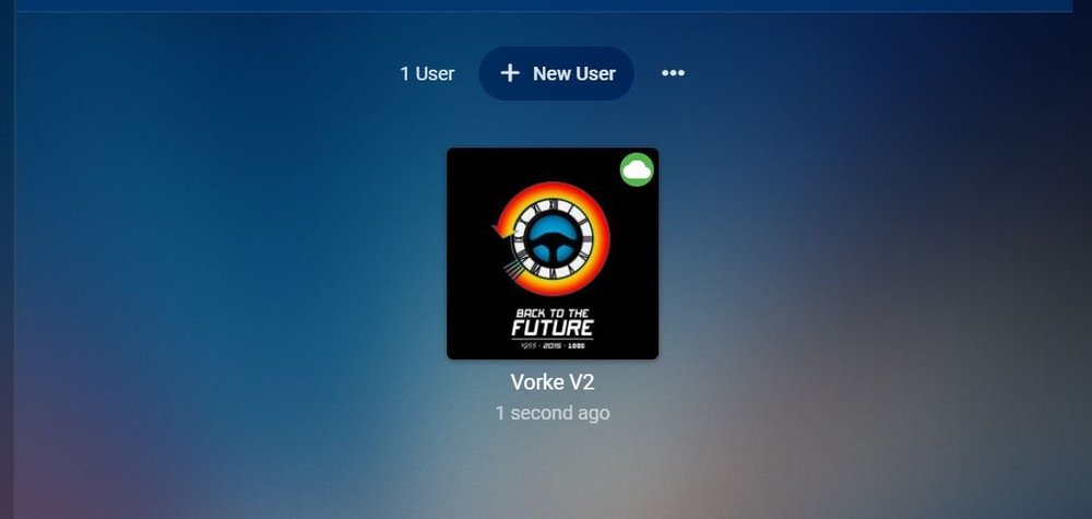

clarkss12 304 Posted July 4, 2021 Author Posted July 4, 2021 (edited) 12 minutes ago, cayars said: Remove Vorke V2 user? ?????? I am the Vorke V2 user. Vorke V2 is my server name. Edited July 4, 2021 by clarkss12
pwhodges 2028 Posted July 4, 2021 Posted July 4, 2021 Ah, you gave him your own login, and now want him not to be able to use it? I believe you can block specific devices (though I don't know the details). Or you could change your password - which would be a mild pain as you'd have to log your devices in again, but that's not a big deal, is it? Paul
clarkss12 304 Posted July 4, 2021 Author Posted July 4, 2021 1 minute ago, pwhodges said: Ah, you gave him your own login, and now want him not to be able to use it? I believe you can block specific devices (though I don't know the details). Or you could change your password - which would be a mild pain as you'd have to log your devices in again, but that's not a big deal, is it? Paul That is the issue, he just installed the app and started using it, I don't recall any password....... I would like to give him his own user account, so I can control his usage...... We are just testing it, to see if it serves his purpose. He is purchasing an RV and wants to add a TV so his grandkids can watch the old TV shows (that I have on my server), while they are traveling or camping ......... HOW did I give him my login??? He just installed the app, connected to my WiFi and he was off to the races...... The issue is how he got access using the WAN. I do not have a password for my server. Even if I had a password and gave it to him, I would still be in the same situation.

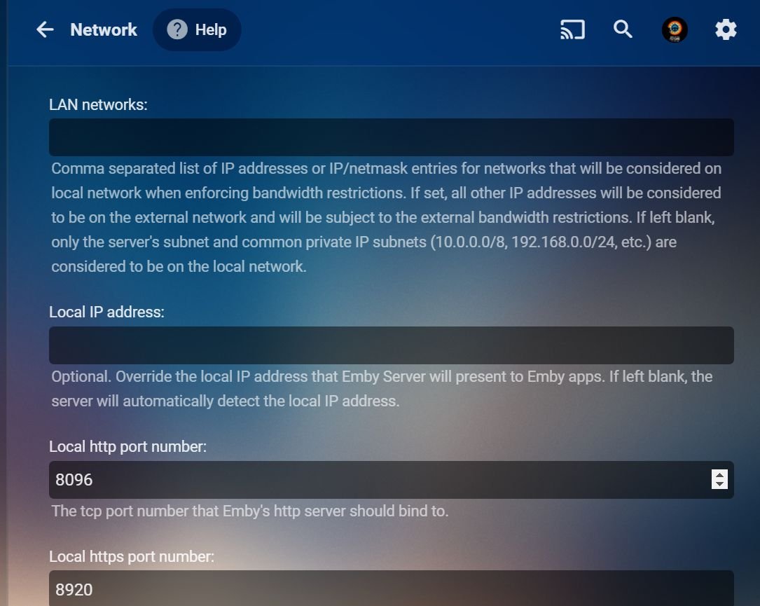

pwhodges 2028 Posted July 4, 2021 Posted July 4, 2021 Then you probably don't have one! On the Network page of the dashboard, what is shown in the first field: "LAN Networks"? We need to find out why a login without password is possible remotely. Paul
clarkss12 304 Posted July 4, 2021 Author Posted July 4, 2021 4 minutes ago, pwhodges said: Then you probably don't have one! On the Network page of the dashboard, what is shown in the first field: "LAN Networks"? We need to find out why a login without password is possible remotely. Paul
Carlo 4561 Posted July 4, 2021 Posted July 4, 2021 You can turn on the "hide this user" option for remote users (user profile tab) and set a password (password tab). If you already had a password, change it. Then create a new user account for him to use.
