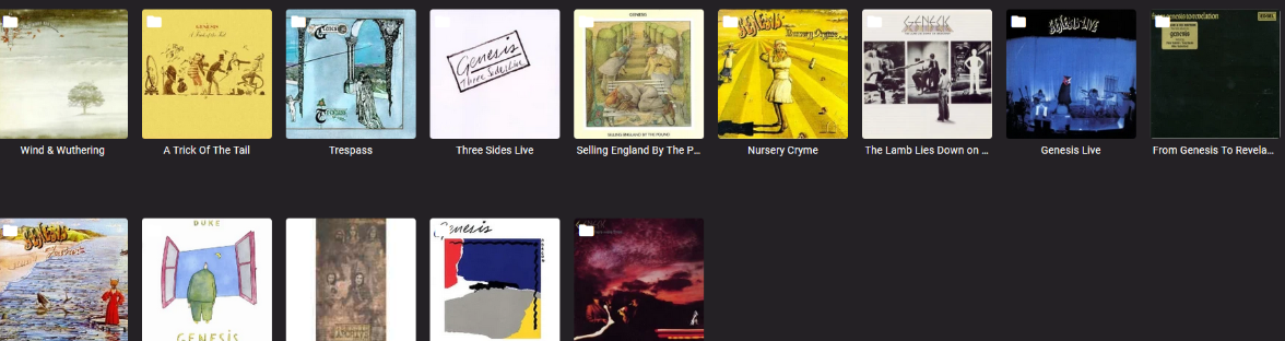

fitzbew 1 Posted July 4, 2021 Posted July 4, 2021 (edited) I realize the title to this is a bit silly, but I have updated to 4.6.4.0 on my Synology NAS and music support seems to be basically gone. Yes I can access my music but the experience is just awful. Do not get me wrong, I have been using Emby for years and I like it a lot, and I am also a software engineer so I get it when customers are not happy. Anyways...I am basically dead in the water as it stands now. I have a large music library that is in a folder structure of artist/album/songs and they are tagged. I will try and explain what I am experiencing. First off I will start with the web interface. If I access the library with folder view which I prefer the experience is a bit better. I will see something like this Now if I click into a folder it is pretty good also...I actually see album covers If I click on an album it is not so bad but I do not see an "album view"...no name of the album or year or anything like that...I see this If I try to sort the albums be release date it is simply an alphabetical sort and remember...these are all properly tagged. Now if I view the library by Artist (which I do not prefer) it gets worse... It can take a minute or more for really anything to show up and I am presented with first random songs at the top (why???). These actually have the proper album art. Below that I get albums (why would this not be the first thing listed and can I change that?), but no album art at all just the same picture for every single one and they are not even all from the same library If I click see all I get something like this...no album art at all, but clearly it is there somewhere If I click on an album I get what I would call an "album view" which is what I want but now I have no album art So with the web interface I seem to have 2 options...see album art but no album view or see album view but have no album art. This is the case for the whole library. Now I also have a modern Denon receiver which supports DLNA and gapless flac playback. Emby's DLNA supports is completely unusable at all. If I view my library by folder then every single album is only allowed to be playable with the songs in alphabetical order...who would want to listen to an album with the songs not in the order they appear on the album, but instead in alphabetical order by title. Can I change this??? If I try artist mode and then click through I get the tracks in the proper order but they are all duplicated so I have to listen to every track twice, but in the correct order So basically DLNA support does not exist in any reasonable way which is a huge bummer. None of these things were the case before I upgraded to 4.6.4. I realize making software is work...and I do the same thing. And I do not want to sounds like an ass, but at this point the music support no longer seems to exist in any way that could be considered OK. The saddest part is that all this behavior is part of an "upgrade" Anyways...maybe I could be filled in on why I am experiencing this and what I should expect. It does still seem to be good for video which I also use. I appreciate all the work and everything. Thanks Edited July 4, 2021 by fitzbew 1

Happy2Play 9812 Posted July 4, 2021 Posted July 4, 2021 As for the image that shows for multiple albums it is hard to say as that image is a Backdrop/Fanart for the Artist. So there is a image issue at some level of your collection. As for folder order using sort by filename gives me track order for playback but can only guess DLNA should use the same order but it may be something this is not done in DLNA as is does not get as much support or updating. The web client plays the order I select in sort by in folder view.
Happy2Play 9812 Posted July 4, 2021 Posted July 4, 2021 (edited) Can you go over Genesis folder structure and what images are at each folder level. Also what is the Music library folder structure setting set to? Edited July 4, 2021 by Happy2Play
fitzbew 1 Posted July 4, 2021 Author Posted July 4, 2021 I have 9 different libraries. I just deleted the library with my Genesis albums (which I was only using as an example...I was seeing these issues throughout the whole library). I have recreated the library and Emby is scanning it now which I suspect will take some time as it is 318GB and over 21,000 files I am thinking the initial scan was just not correct and the database was missing a bunch of info perhaps. As for the Genesis folder structure it just looked like this and the only images were embedded in the file metadata tags so no images in the folders themselves Again, I appreciate the response
