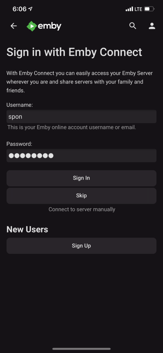

spon 26 Posted July 2, 2021 Posted July 2, 2021 Hi guys. Is emby connect down? I'm not able to log in via connect from any source (ie. iphone app, browser, etc). Message indicates my username or password is incorrect, but it is not. Thanks

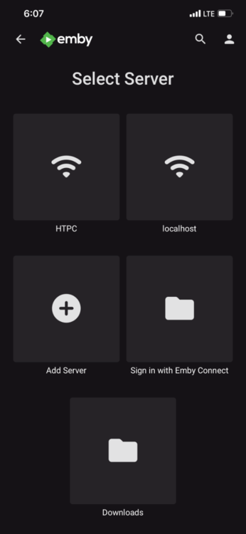

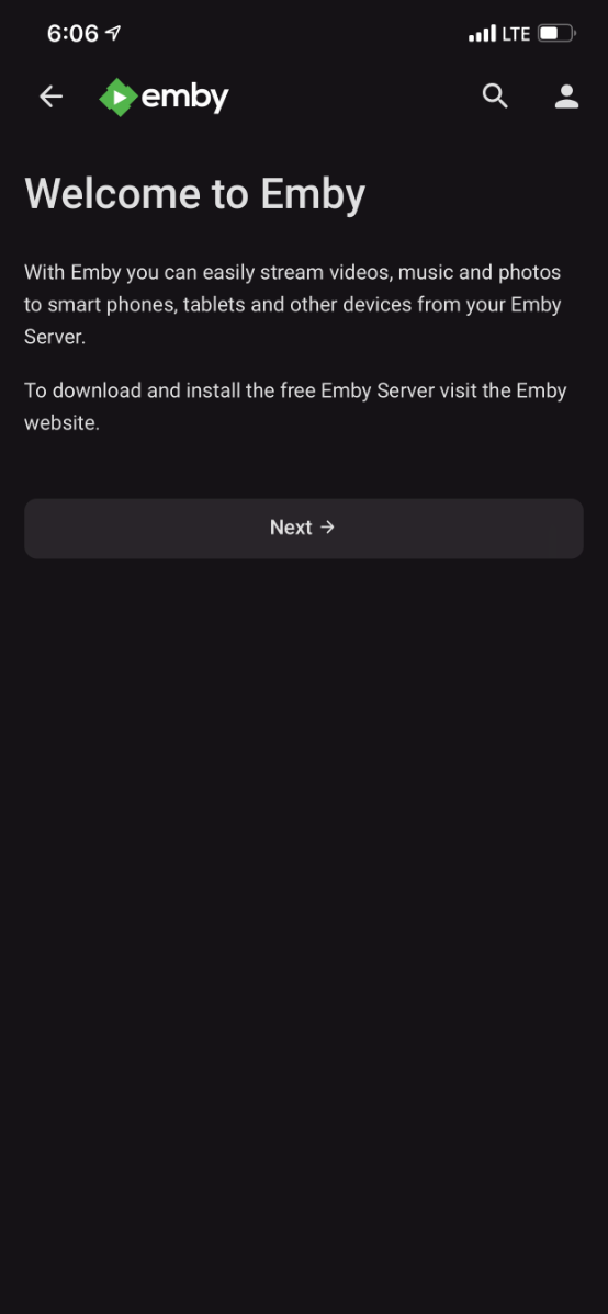

spon 26 Posted July 5, 2021 Author Posted July 5, 2021 Hi guys. Unfortunately I still haven’t been able to get it to work. The trick that @cayars mentioned did sort of work, in that it allowed me to log in, but I’m not able to connect to my server. Here are the sequential screenshots.
Luke 42202 Posted July 5, 2021 Posted July 5, 2021 @spon I would suggest checking out our Connection Troubleshooter: https://support.emby.media/support/solutions/articles/44001849007-connectivity Please try the steps listed there and let us know which ones succeed and which ones do not. Thanks !
Carlo 4561 Posted July 5, 2021 Posted July 5, 2021 Let us know if the link Luke gave above helped you. Also if you go to www.canyouseeme.org and test using your Emby port (likely 8096 or 8920) does it fail or connect?
Solution spon 26 Posted July 5, 2021 Author Solution Posted July 5, 2021 Thanks guys. Looks like my port forwarding was reset somehow at the router level. I re-added it and all is good. Thanks again. 1
