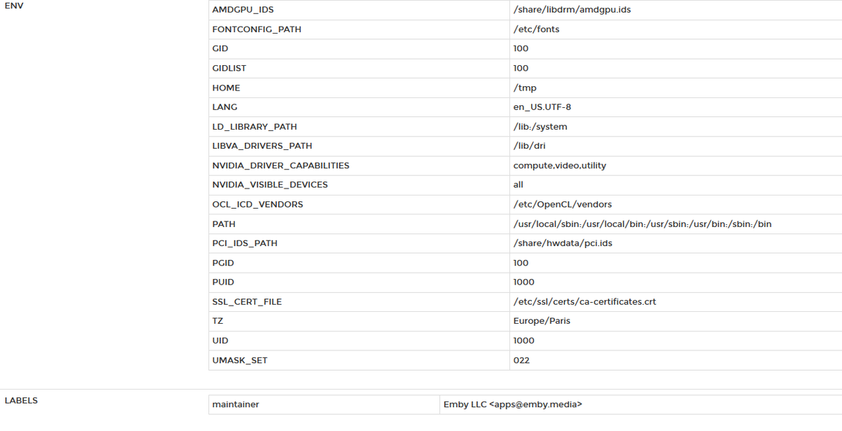

gretagarbo 3 Posted August 26, 2021 Author Posted August 26, 2021 (edited) Hello all and thank you for answering! I'm running emby on docker on openmediavault 5. I reset my config and created my domain name for holidays. Now, locally (my-local-ip:8096 or 8920 with security exception), I can read everything and I have emby premiere enabled. But externally (my-domain-name:external-port with ssl cert), I can't read anything ("no compatible stream are currently available") and I have "get emby premiere". As if there were two different configurations. I'll give you my logs after the first library scan. I'm lost now Edited August 26, 2021 by gretagarbo added env variables
