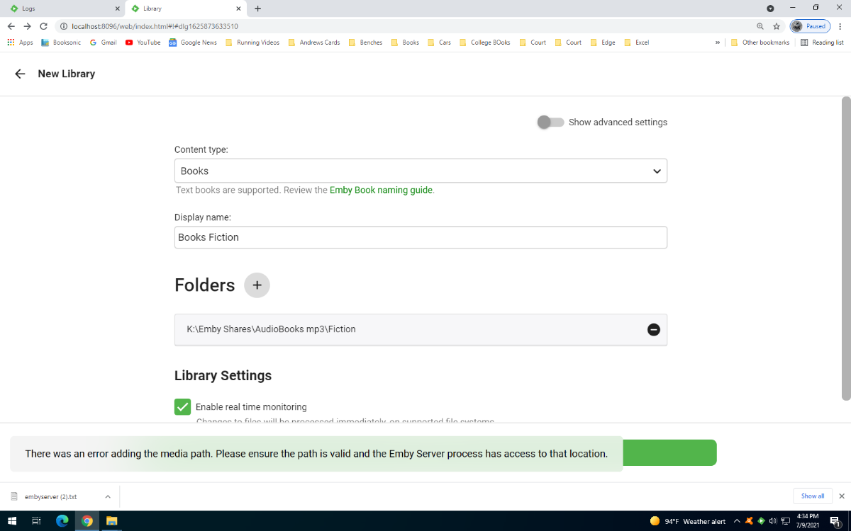

dadofhgnadn 14 Posted July 9, 2021 Author Posted July 9, 2021 All right..... please find attached the server log. I managed to get the library removed by deleting the current path and then adding a path in that library to c:\temp. I then refreshed the metadata and removed. Shut down Emby Server and then restarted it. Now it is gone. I then attempted to recreate the library with the correct path and I receive an error (see image). It is a local drive. embyserver (2).txt
Happy2Play 9802 Posted July 10, 2021 Posted July 10, 2021 Books are not the same as Audiobooks and will not show audio files. For electronic books, the following types are supported: pdf epub mobi cbr cbz azw3 So can you provide the same for Audiobooks. But not sure on why "K:\Emby Shares\AudioBooks mp3\Non Fiction" works and "K:\Emby Shares\AudioBooks mp3\Fiction" does not, assuming it exists on that drive. Issues with this path also Skipping realtime monitor for G:\Processed Home Movies because the path does not exist But that log is showing a corrupt database. SQLitePCL.pretty.SQLiteException: Corrupt: database disk image is malformed You will need to try and recover your database per the KB. Corrupt Database : Emby 1
