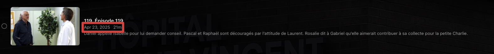

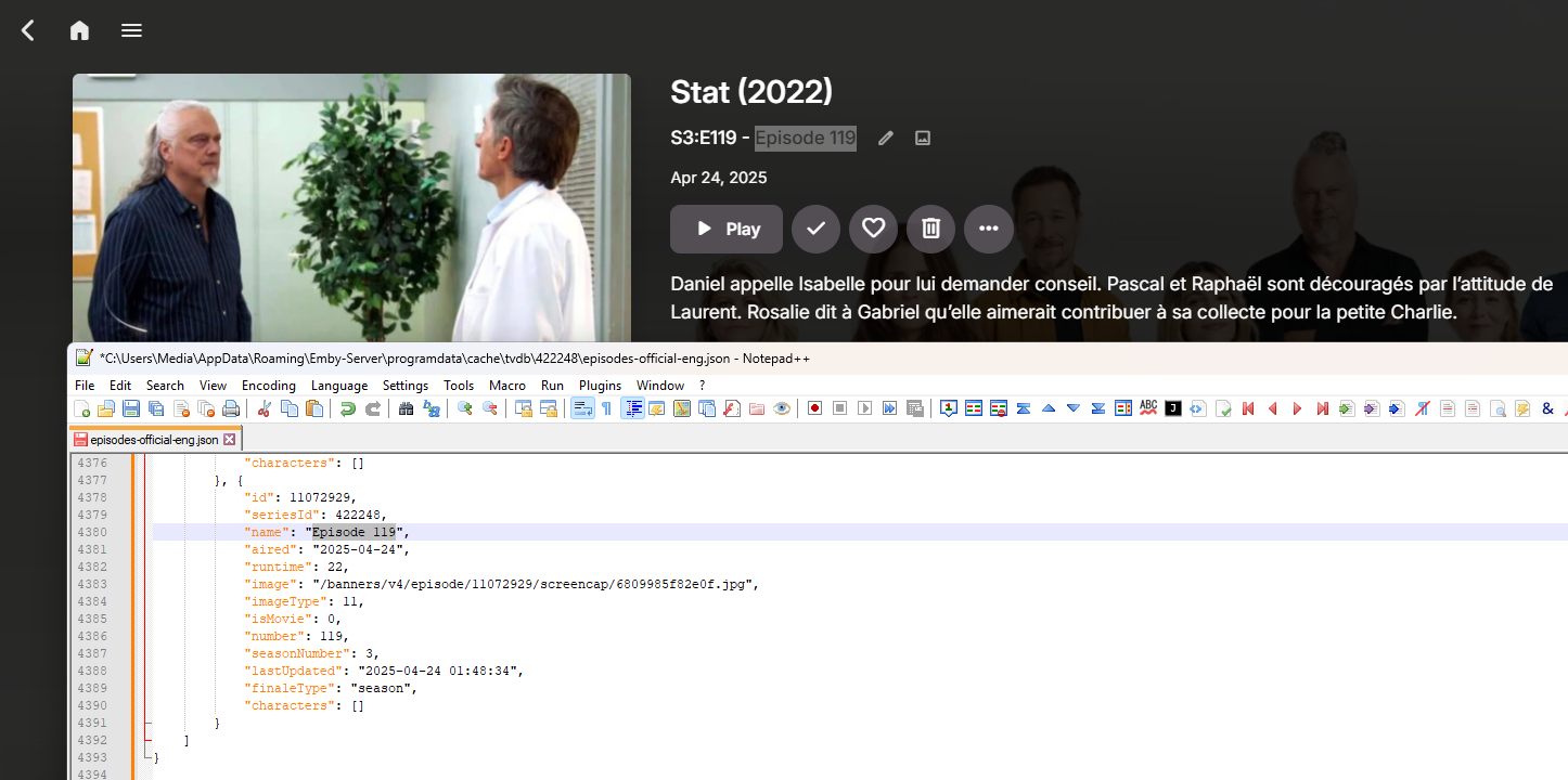

Quack6765 2 Posted May 6, 2025 Posted May 6, 2025 I'm having the same issue. For example using the following show Stat (2022) with episode 119: https://www.thetvdb.com/series/stat-2022/episodes/11072929 We can see that the aired date is april 24 2025 but yet in Emby it shows april 23 2025: Now in my Emby logs we can confirm that the metadata is pulled from TVDB from the correct page and I made sure to have TVDB as my main metadata provider. 2025-05-06 14:21:57.219 Debug App: Running TvdbEpisodeProvider for /data/tv-shows/Stat (2022)/Season 03/Stat (2022) - S03E119 - Episode 119 [WEBDL-1080p][AAC 2.0][h264]-TFA.mkv 2025-05-06 14:21:57.219 Info HttpClient: GET https://api4.thetvdb.com/v4/episodes/11072929/extended?meta=translations 2025-05-06 14:21:57.310 Debug App: Running EpisodeNfoProvider for /data/tv-shows/Stat (2022)/Season 03/Stat (2022) - S03E119 - Episode 119 [WEBDL-1080p][AAC 2.0][h264]-TFA.mkv 2025-05-06 14:21:57.310 Debug App: EpisodeNfoProvider returned no metadata for /data/tv-shows/Stat (2022)/Season 03/Stat (2022) - S03E119 - Episode 119 [WEBDL-1080p][AAC 2.0][h264]-TFA.mkv If we check the any other episode from TVDB and Emby we can see the same behaviour. For example using the episode 1 of season 3 TVDB says the aired date is sept 9 but Emby shows sept 8. So the issue is that somehow when fetching the metadata Emby does some parsing or formatting to the date and something is not working correctly which results in subtracting 1 day for all released date versus what TVDB has for all episodes

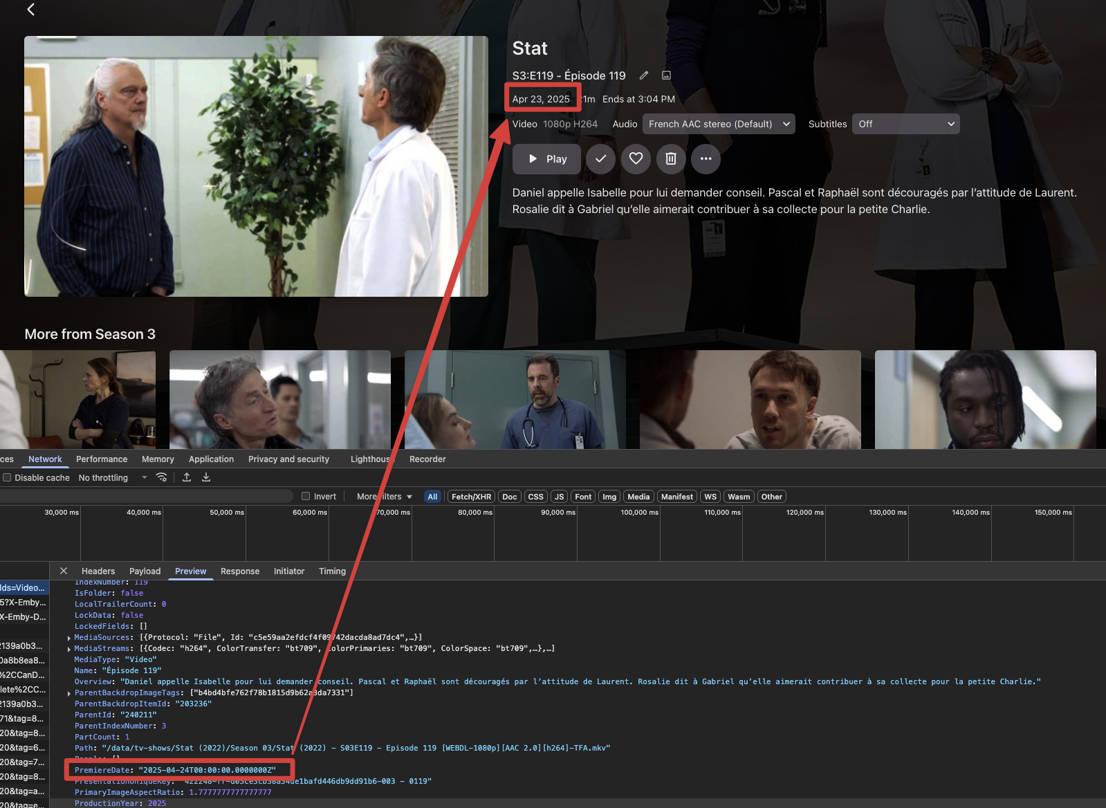

Quack6765 2 Posted May 6, 2025 Posted May 6, 2025 Looking at the dev console, it seems the backend is showing the correct date but yet the frontend shows 1 day earlier as the aired date

Quack6765 2 Posted May 7, 2025 Posted May 7, 2025 I was able to fix the issue. Using the official docker image, the value TZ='America/New_York' is not respected and does nothing. So even if Emby was using the correct timezone, the actual docker container was still on UTC. Instead I mapped the following volume in my docker compose file: - /etc/timezone:/etc/timezone:ro - /etc/localtime:/etc/localtime:ro which resulted in my container using the host (so the correct) timezone. After that I refreshed+replaced all metadata for the show and the episode is now correctly showing april 24. Thanks ! 1
