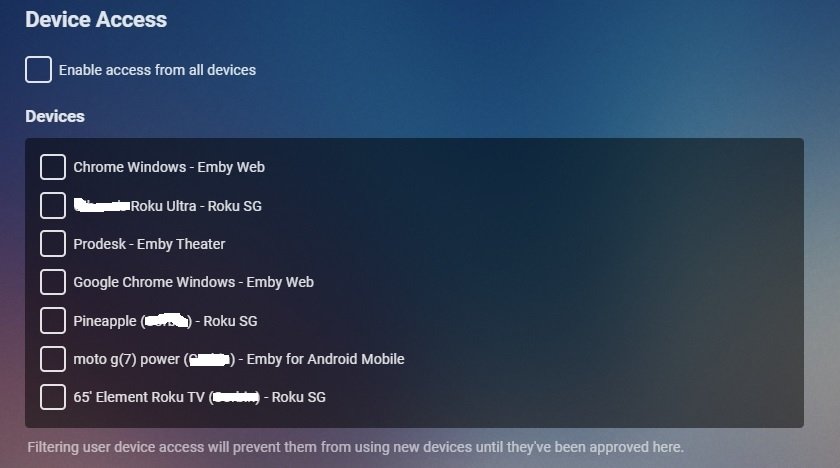

Jrod696 28 Posted June 30, 2021 Author Posted June 30, 2021 1 hour ago, Luke said: @Jrod696 ? So I used the app on my phone and took my phone off wifi, my phone is not listed in the device list. I used his account and password and it would not log me in using a direct connect, I checked the allow all devices and hit save and could access, unchecked it and could not. The curious thing when I went to go in and add the device specific ( my cell) its not listed in the device list. It appears though that aside from the device recognition storage it does work properly as far as access is concerned when direct connecting.

Jrod696 28 Posted July 1, 2021 Author Posted July 1, 2021 17 minutes ago, Luke said: Thanks for the feedback. Have your questions been answered? I am still interested in trying to find out if there is a settings issue or a way to fix the issue so that devices actually show up in the dashboard and to be sure that users with specific access set by device can only access with that device or devices that are selected, currently that is not the case. If the issues is my end how can I fix it?

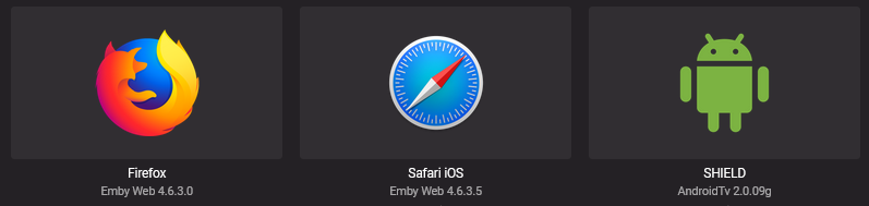

Happy2Play 9802 Posted July 1, 2021 Posted July 1, 2021 12 minutes ago, Luke said: Thanks for the feedback. Have your questions been answered? I think the issue still remains as remote user is circumventing the access via Connect via browser not native app. As Remove user should be blocked per this setting. But have not been able to reproduce this. On 6/28/2021 at 7:27 PM, Jrod696 said: i also was on the phone with him when he did this and confirmed he was using the app icon on his phone not going through the safari browser Not entirely sure what this is suppose to mean as it clearly shows a browser connection.

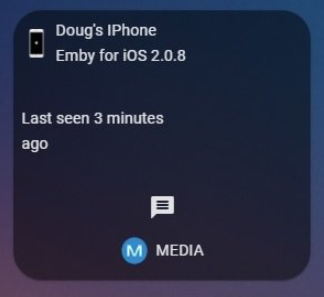

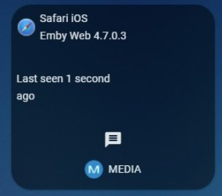

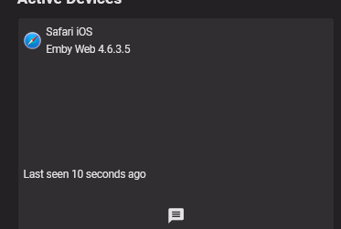

Happy2Play 9802 Posted July 1, 2021 Posted July 1, 2021 @LukeI sort of see a issue as the Safari iOS is only shown as a device when the user is logged on and removed when logged off. Same via Devices, something auto remove Safari iOS from Devices. Logged in Logged off But reappears at login. Now if I apply restriction to that device while logged in, the restriction will apply once user logs off. Logging in again is restricted in my test.

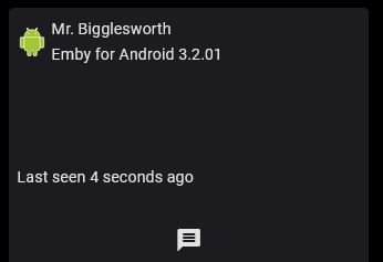

Jrod696 28 Posted July 1, 2021 Author Posted July 1, 2021 (edited) 4 minutes ago, Happy2Play said: @LukeI sort of see a issue as the Safari iOS is only shown as a device when the user is logged on and removed when logged off. Same via Devices, something auto remove Safari iOS from Devices. Logged in Logged off But reappears at login. Now if I apply restriction to that device while logged in, the restriction will apply once user logs off. Logging in again is restricted in my test. in my test i show myself logged in using my android device using the app and it still does not show in devices. he used the installed app on his phone he did not use safari, I dont know if its the age of the iphone i dont know, i dont even have apple devices, but even if hes a complete idiot and doesnt understand the green icon vs the safari icon is still not a security violation that a browser can login to the server when the only device he should be able to use is 1 single fire stick. Edited July 1, 2021 by Jrod696
