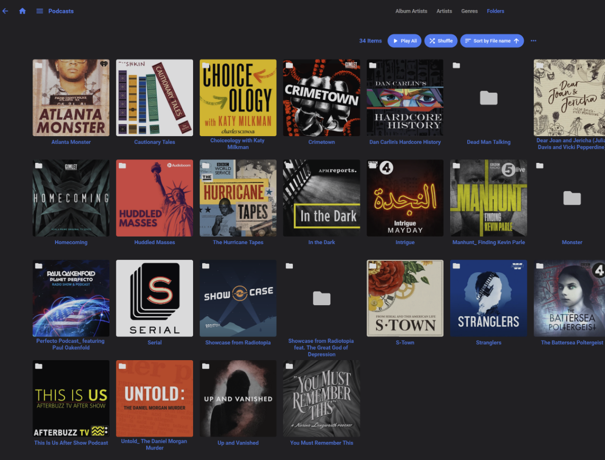

Spaceboy 2573 Posted June 26, 2021 Posted June 26, 2021 personally i would recommend setting up gpodder to do the obtaining and point emby at the download folder as a mixed content library 2
Bigmack3000 108 Posted June 27, 2021 Author Posted June 27, 2021 4 hours ago, cayars said: It doesn't download them but sets up links in Emby to follow and play the Podcasts. Emby essentially streams them to the clients from the location pointed to in the RSS feed. So you could have 100K podcast episodes running on a thumb drive. Thanks. I do prefer to download them because I've had episodes disappear before. Sometimes a podcast will be sold to something like spotify, and then suddenly all the back episodes are no longer accessible. 4 hours ago, Spaceboy said: personally i would recommend setting up gpodder to do the obtaining and point emby at the download folder as a mixed content library I'll into gpodder for keeping track of them. So there's no official process for organizing them in emby? Basically, if i make a mixed library folder, it'll treat each individual podcast kind of like a tv show? And scrape all naming and ordering information from inside the file itself?

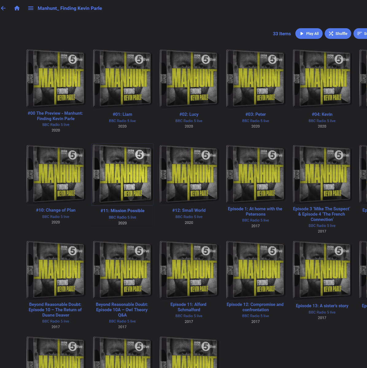

Spaceboy 2573 Posted June 27, 2021 Posted June 27, 2021 think i had to set something in gpodder to get it to name the files by the episode names. then i get: and 1

Bigmack3000 108 Posted June 28, 2021 Author Posted June 28, 2021 15 hours ago, ebr said: Hi. Not really at this time because we don't have a metadata provider that would identify them properly. podchaser.com looks like it could be a possible option for that. 21 hours ago, Spaceboy said: think i had to set something in gpodder to get it to name the files by the episode names. then i get: and Do you mind showing me an example of the actual file name for one of the bonus episodes to get it between episode 10 and 11? Is there a way to have emby autosort them by release date so that bonus episodes are always in the correct spot?
Spaceboy 2573 Posted June 28, 2021 Posted June 28, 2021 18 hours ago, Bigmack3000 said: podchaser.com looks like it could be a possible option for that. Do you mind showing me an example of the actual file name for one of the bonus episodes to get it between episode 10 and 11? Is there a way to have emby autosort them by release date so that bonus episodes are always in the correct spot? they are named on disk exactly as they show up in emby because there is no metadata gpodder shows a release date but that isnt brought through into the file attributes at all. and some of the shows (included the one i provided the screenshot of) were downloaded on one go. otherwise you would be able to sort on date added and get what you are looking for. its not perfect, but its good enough
