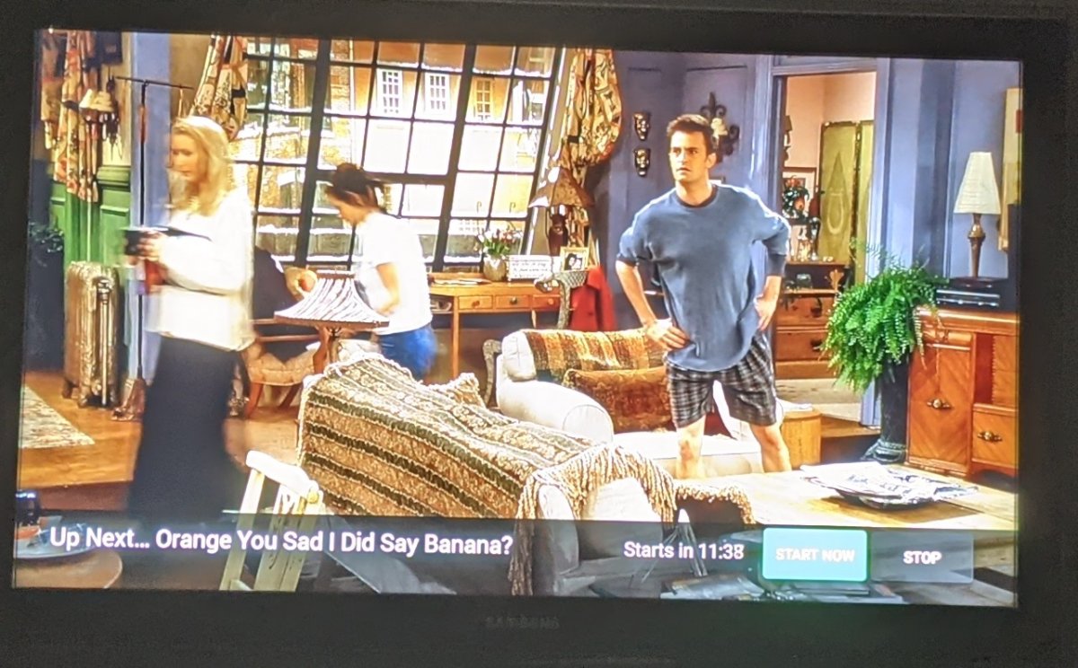

Dreakon13 143 Posted June 26, 2021 Posted June 26, 2021 (edited) Hi, I have an Amazon 4K Firestick with app version 2.0.21a Registered and Emby server version 4.6.3.0. I was doing some general shuffling through my TV shows library last night (watching what I wanted to watch, skipping past what I didn't... the new age channel surfing lol) and with a slightly concerning frequency, I was getting the examples in the screenshots of "Up Next" with crazy times. Like halfway through a 20 minute episode, saying it "starts in" 11-13 minutes. It normally works fine, popping up with a small fraction of the shows left. I'm guessing maybe the shuffling/skipping was confusing things? I'm not sure if this is a server issue or a Firestick issue. Sorry if this isn't in the right place. Appreciate any insights. Edited June 26, 2021 by Dreakon13

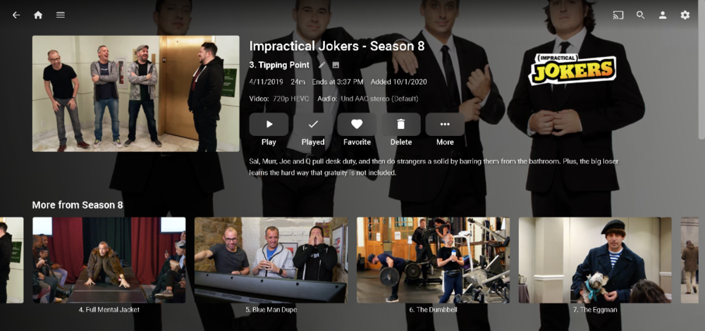

Dreakon13 143 Posted June 26, 2021 Author Posted June 26, 2021 (edited) 1 hour ago, ebr said: So the panel is coming up when there really is that much time left? This almost has to be metadata related. Do the durations show properly on the detail page? Yeah, about halfway through the episodes the panel was showing up, which is roughly 11-13 minutes give or take. The duration seems correct (this is the Impractical Jokers episode I was watching): (I pulled that from the web app, let me know if I need to check on the Firestick.) It's a good episode, I could try watching it again and see if it happens. I have a feeling it'll work fine though. Could the fact I shuffled the full library and skipped a number of random shows/episodes, before landing on these to watch, play into it at all? Edited June 26, 2021 by Dreakon13

seanbuff 1356 Posted July 8, 2021 Posted July 8, 2021 Okay happened again this evening, while watching the same series - was offered the next ep with around 7 mins left in the current one After I cancelled, stopped and sent the logs. I replayed the same ep and waited til the end where it correctly offered at -40 secs -- which to me says Emby does know the correct duration of the media. Will PM details.
ebr 16338 Posted July 8, 2021 Posted July 8, 2021 Unfortunately, the log doesn't contain the start of the item which is what would tell us when it calculated the up next time. I thought this might be a problem because so much time will pass between the origin of the issue and you seeing it. Did you immediately back out and send the log?
seanbuff 1356 Posted July 8, 2021 Posted July 8, 2021 Timeline of activity in EST to match app log: 05:44:49.568 Info SessionManager: Playback start reported by app AndroidTv 2.0.30g playing Unknown Caller. Started at 0 ms Started watching first item, watched entire episode, then during closing credits used OSD to skip to next episode before the T-40 sec auto offer 06:34:31.626 Info SessionManager: Playback start reported by app AndroidTv 2.0.30g playing Household. Started at 0 ms Next episode starts playing, and then with about 7 mins left I am offered to start the Next Ep (pic above) I took the pic above and waited about 90 secs to see if it would keep ticking over before hitting cancel and sending log via app.
