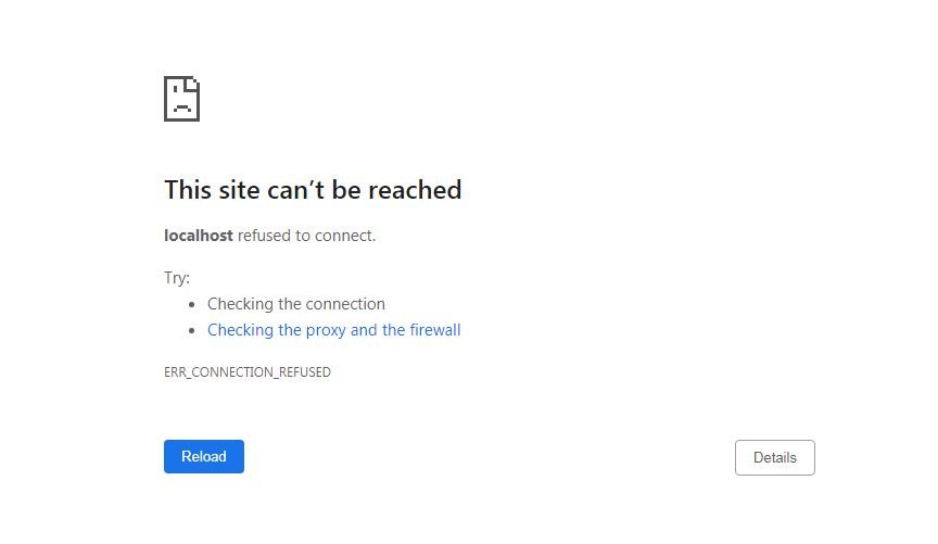

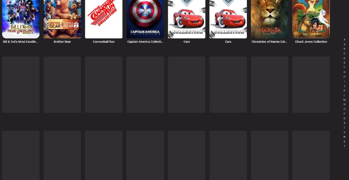

playloud 10 Posted June 24, 2021 Posted June 24, 2021 When attempting to browse collections, or when clicking "Add to Collection", the collections start to load until about "C" alphabetically, then stop loading. The connection to server is lost and only a reboot brings it back up. I am using the Web App on the actual Windows server. embyserver.txt

Luke 42200 Posted June 25, 2021 Posted June 25, 2021 It's something to do with the auto-generated images. That's why the problem does not occur in places where the images are not displayed.

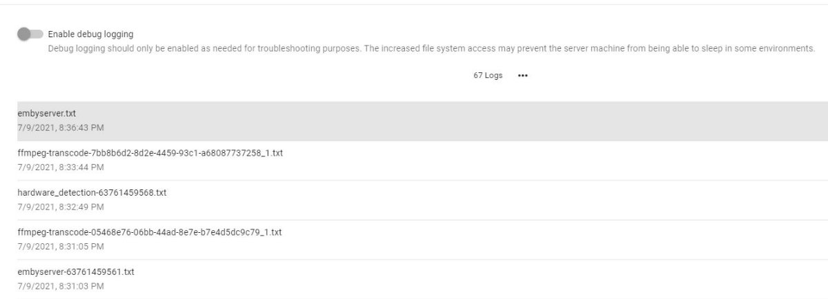

Carlo 4561 Posted July 8, 2021 Posted July 8, 2021 Unless you have a reason to have debug logging on I'd turn it off. It's useful for brief points in code testing but "litters" the log with lots of info that can make it hard to read. Could you turn that option off and generate new logs?
playloud 10 Posted July 8, 2021 Author Posted July 8, 2021 Logs attached without debug logging embyserver-63761363167.txt embyserver (1).txt
Carlo 4561 Posted July 9, 2021 Posted July 9, 2021 This still has debug log turned on. Logs menu, first option, turn off.
playloud 10 Posted July 10, 2021 Author Posted July 10, 2021 I ensured debug log was turned off, but I was pretty sure it was last time. embyserver-63761459561.txt embyserver.txt
Carlo 4561 Posted July 10, 2021 Posted July 10, 2021 (edited) Better logging this time! I'm not sure how useful the logs are going to be for this as it might not log the issue. I didn't see anything unfortunately. Would we be able to setup a remote session where I can login with you via desktop sharing and try to help you with this? Edited July 10, 2021 by cayars
