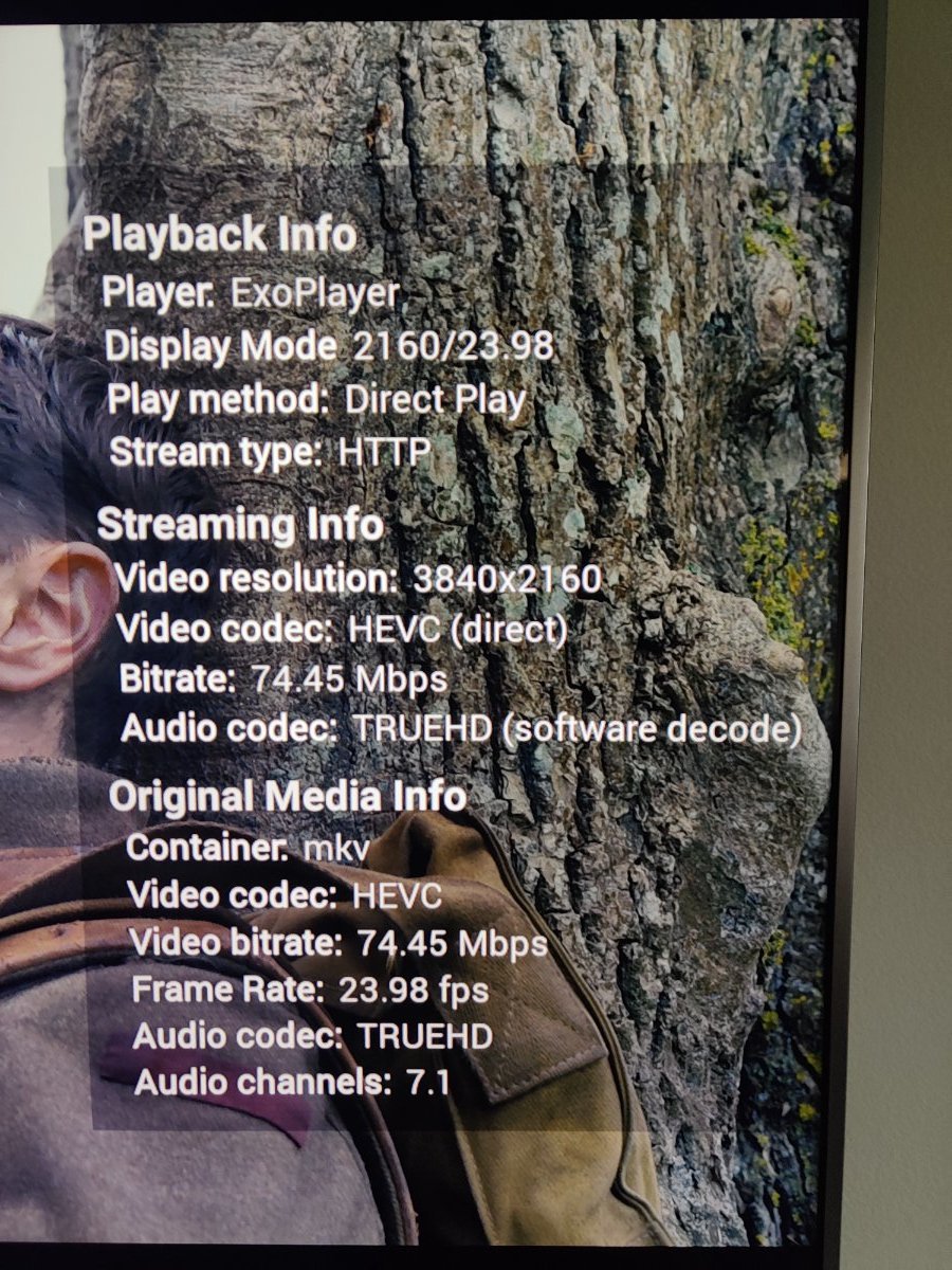

CHA0SENG7NE 28 Posted June 22, 2021 Posted June 22, 2021 Updated to the latest version of server. All working great apart from DOLBY ATMOS audio streams arent displaying correctly on amplifier. Checked Stats for Nerds. The video is direct play. The audio has software decode. Im using an Nvidia Shield Pro 2019 connected into Denon AVR-X2400H. Any other codec displays correct like DTS:X, Dolby etc I have attached log files. Anything else let me know. This was working fine beforehand. Still has sound and isnt a deal breaker but it isnt right. Many thanks hardware_detection-63759991798.txt embyserver.txt

rbjtech 5337 Posted June 23, 2021 Posted June 23, 2021 (edited) Are you using 'File' or 'HTTP' delivery ? What does SFN show ? Edited June 23, 2021 by rbjtech
CHA0SENG7NE 28 Posted June 23, 2021 Author Posted June 23, 2021 (edited) Edited June 23, 2021 by CHA0SENG7NE

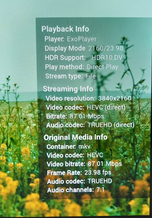

rbjtech 5337 Posted June 23, 2021 Posted June 23, 2021 ah ok - HTTP and a s/w decode on Audio - not good. My stream type is 'File' - in other words, real direct playback - no emby http streaming is involved. https://support.emby.media/support/solutions/articles/44002058112-shield-tv-direct-file-access It would be interesting if this access method solves your issue ... if it does, then maybe the new version has broken something.
rbjtech 5337 Posted June 23, 2021 Posted June 23, 2021 Gimme a couple of hours and I'll test this - I have a DV remux of 1917 myself using the same kit (but using File method) and I'm almost 100% sure True-HD Atmos was perfectly fine (and shown on the Denon AVR).

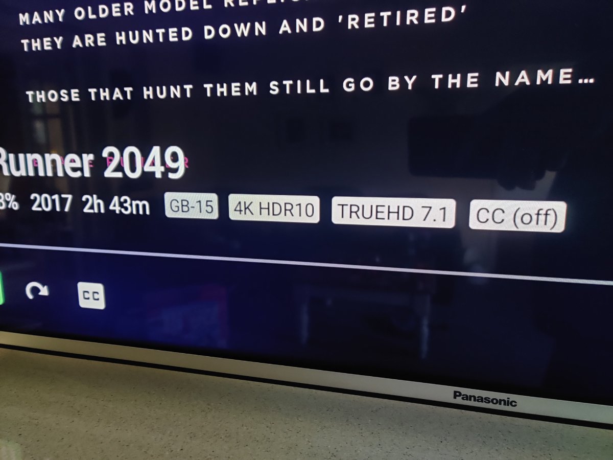

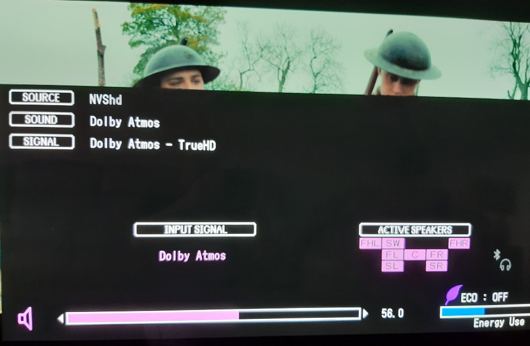

rbjtech 5337 Posted June 23, 2021 Posted June 23, 2021 (edited) I don't see any issues - I can't test HTTP but according to @ebr this will not make any difference I'm using server 4.6.0.3 and Shield Client version 2.0.26g - which is the same as what's being reported in your log above. Interestingly, your rip is 75Mb/sec whilst mine is 87Mb/sec - could be as mine has DV (and is playing as DV) but I also see your SFN doesn't mention the HDR Support line ? Is your TV SDR ? Edited June 23, 2021 by rbjtech 1
CHA0SENG7NE 28 Posted June 23, 2021 Author Posted June 23, 2021 Just got home and tried it again after switching everything of at the mains. Its bloody working..... 1

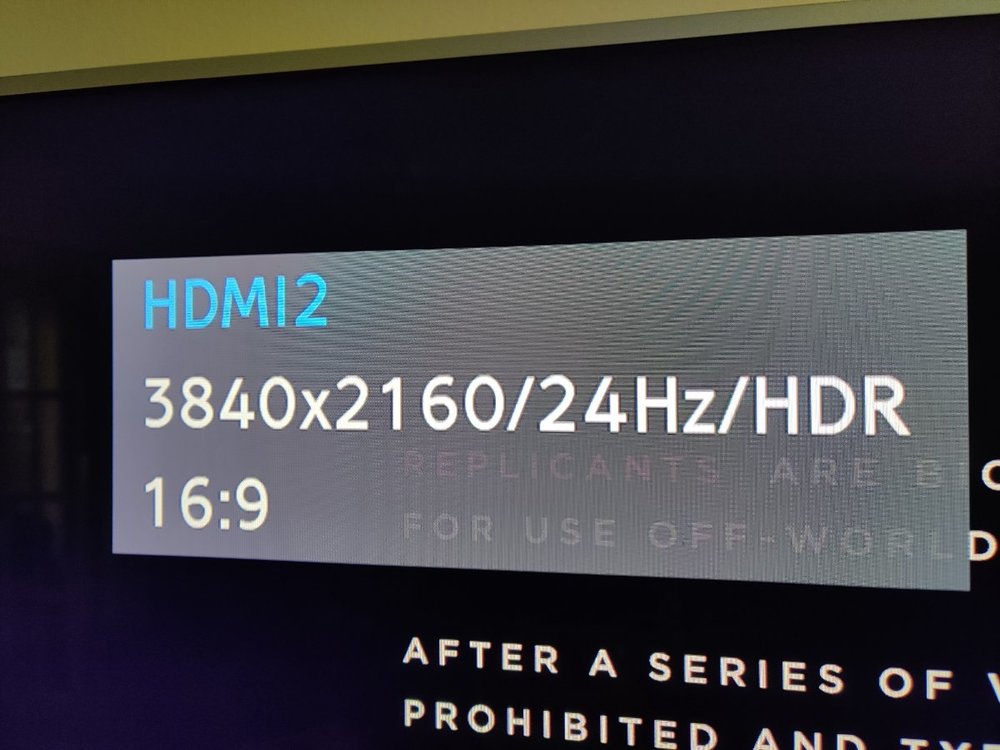

CHA0SENG7NE 28 Posted June 23, 2021 Author Posted June 23, 2021 2 hours ago, rbjtech said: I don't see any issues - I can't test HTTP but according to @ebr this will not make any difference I'm using server 4.6.0.3 and Shield Client version 2.0.26g - which is the same as what's being reported in your log above. Interestingly, your rip is 75Mb/sec whilst mine is 87Mb/sec - could be as mine has DV (and is playing as DV) but I also see your SFN doesn't mention the HDR Support line ? Is your TV SDR ? My TV is HDR and it plays in HDR the tv switches and displays the info.
rbjtech 5337 Posted June 23, 2021 Posted June 23, 2021 lol - isn't that always the way ! Does it say about 'HDR Support' in the SFN since the restart ? as your previous screen shot it was missing - hence the question.
CHA0SENG7NE 28 Posted June 23, 2021 Author Posted June 23, 2021 Nope it doesn't have it but the TV definitely switches to HDR and the picture is correct. I wonder why it doesn't display that? But! The audio is perfect again so thanks to everyone for reaching out. 1
