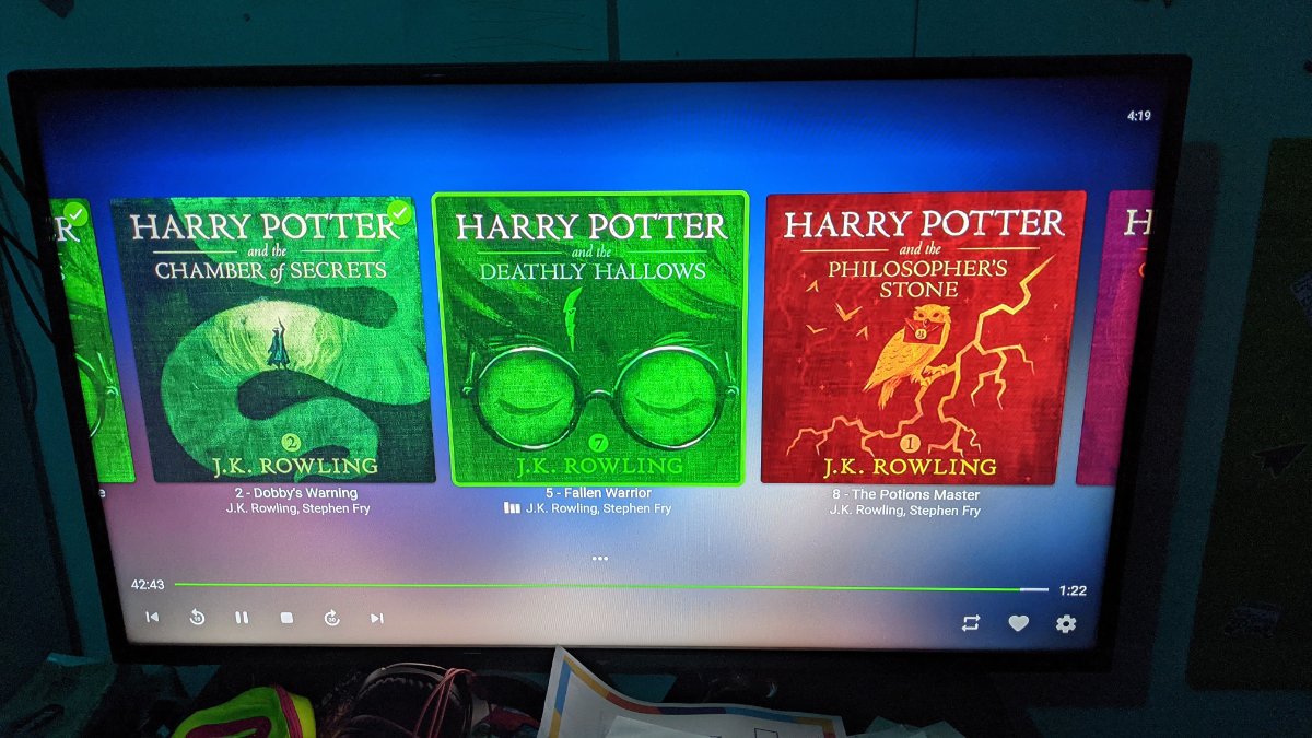

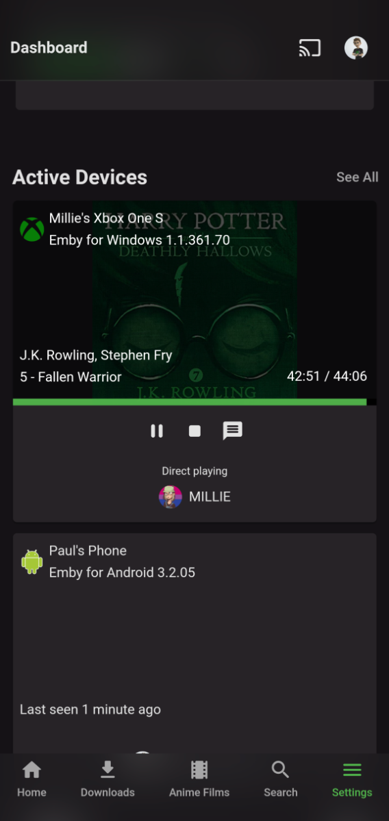

Guest Posted July 12, 2021 Posted July 12, 2021 Sorry for the late reply, with the latest build it still doesn't work, the screenshots I have attached don't fully show the problem, on the Xbox (Client) it ways there's 1.22 mins left but it has actually stopped playing and doesn't move at all or even start the next chapter. On the server it will get to 1.22mons from the end then keep skipping back 10seconds and counting up then skip back over and over in a loop, this to is not playing at all. I have also attached a log fine (sorry debug was off when she was listening) The screen shots are from about 4:15am to 4:20am. embyserver.txt

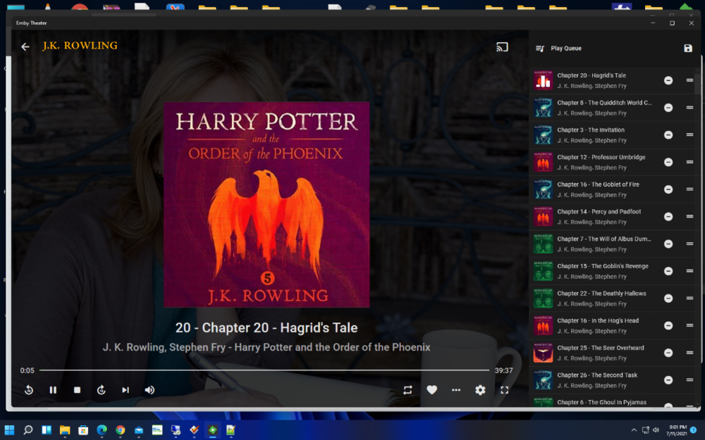

Happy2Play 9840 Posted July 12, 2021 Posted July 12, 2021 (edited) 8 hours ago, morpheus2n2 said: she just go into the Author and hits shuffle Threw folder view or the Authors tab? But I guess it shouldn't matter as Shuffle should be creating a queue. But I can not reproduce on PC/web client or desktop/app store ET as you mentioned. Edited July 12, 2021 by Happy2Play

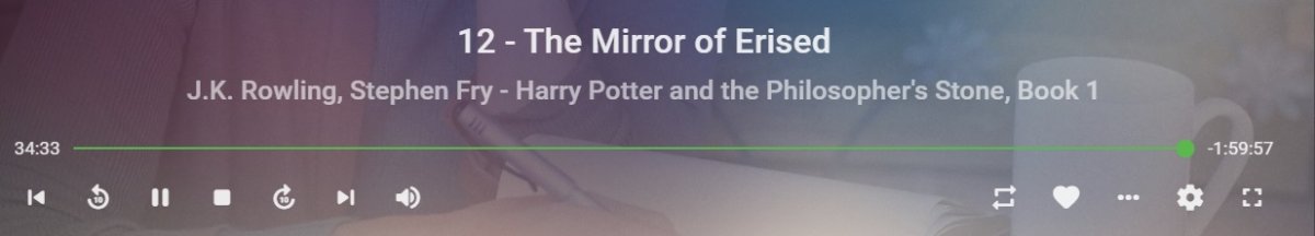

Happy2Play 9840 Posted July 12, 2021 Posted July 12, 2021 There is something wonky with the files as they are extending passed 0, but go to the next chapter for me when I select Shuffle. Only grabbed the first book but all the tracks I tested were extended past 0. Tested in 4.6.4.0 and 4.7.0.3 web client. Don't see this behavior on my books.

Happy2Play 9840 Posted July 12, 2021 Posted July 12, 2021 Just now, morpheus2n2 said: Interesting, if it help she says that it will skip if she has fast forwarded through a chapter but if left to play out in full it wornt skip, so would that be somthing to do with the extended passed 0? Also what is extended passed 0? Per the image is should stop that track at 0 but it keeps going into the negative numbers. So the media track timestamp is wrong or corrupted.
Guest Posted July 12, 2021 Posted July 12, 2021 1 minute ago, Happy2Play said: Per the image is should stop that track at 0 but it keeps going into the negative numbers. So the media track timestamp is wrong or corrupted. Ohh I always thought it meant that's how long it played for pmsl
Solution Happy2Play 9840 Posted July 12, 2021 Solution Posted July 12, 2021 3 minutes ago, morpheus2n2 said: Ohh I always thought it meant that's how long it played for pmsl Depends on the view, but that image shows the book is 34:33 and counts down to zero but goes beyond that. And this view shows similar time exceeds track duration 1
Guest Posted July 12, 2021 Posted July 12, 2021 1 minute ago, Happy2Play said: Depends on the view, but that image shows the book is 34:33 and counts down to zero but goes beyond that. And this view shows similar time exceeds track duration Ahh got it yeah thats what her Xbox was doing but when I looked at the Dashboard page from My account it would show that it was skipping back 10 seconds each time it hit a particular mark, witch would make sense if the files are funky cos it has no clue what to do with it, and cos they worked in Plex I thought nothing of it so it could just be when plex gets to the same point and it starts to be wired it just skips the track instead of keep trying to play what's not there it hence it looking like it works. You have been a great help thank you so much
