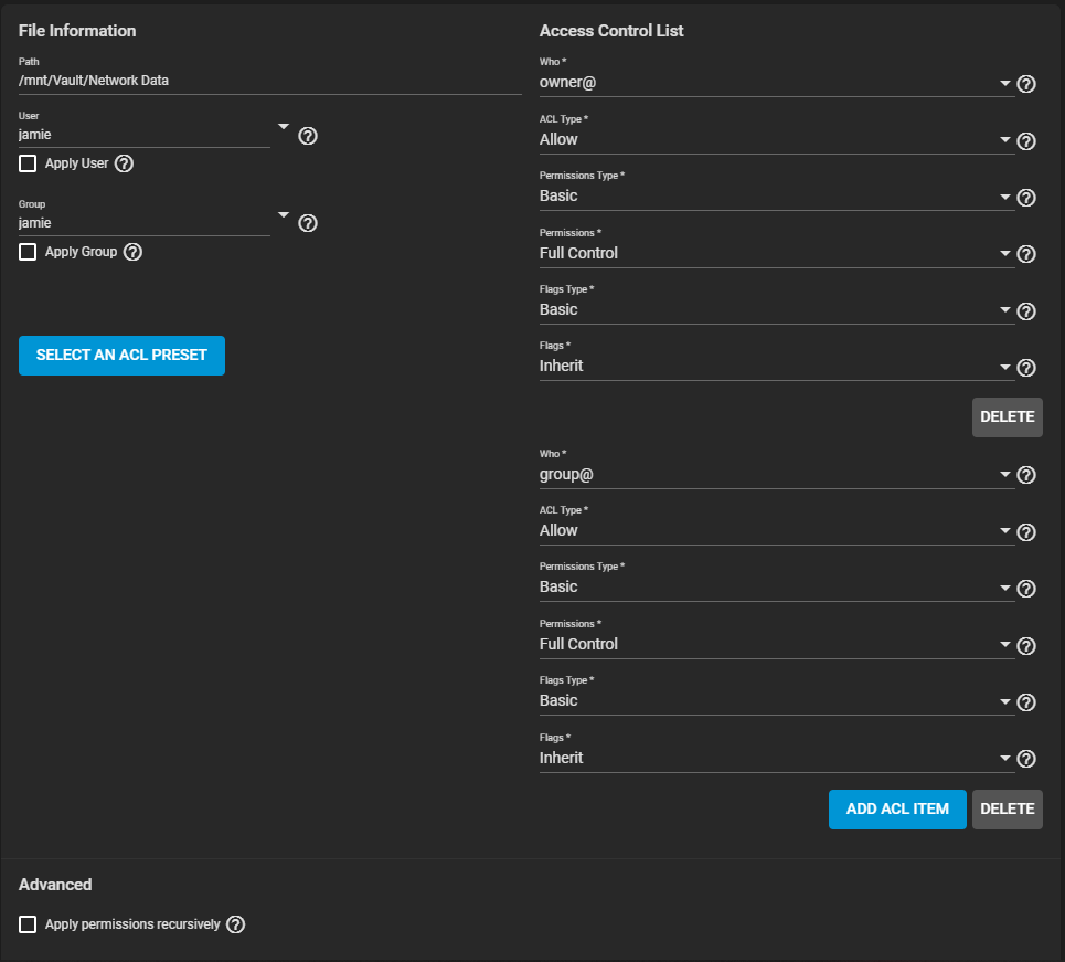

I have attached my embyserver.txt log in case that's of help alongside a screenshot of my truenas ACLS

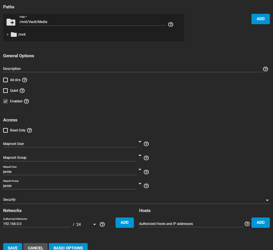

nfs share screenshot from within truenas. The mapall options make all mounts act as that user on the host
Spoiler

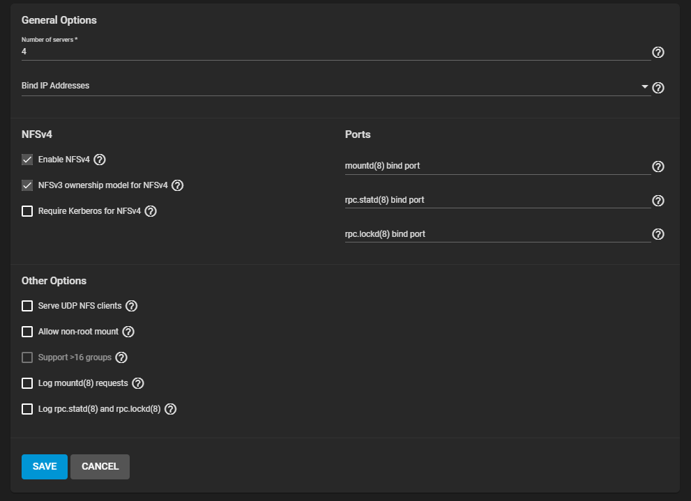

Here are my nfs service settings in truenas
Spoiler

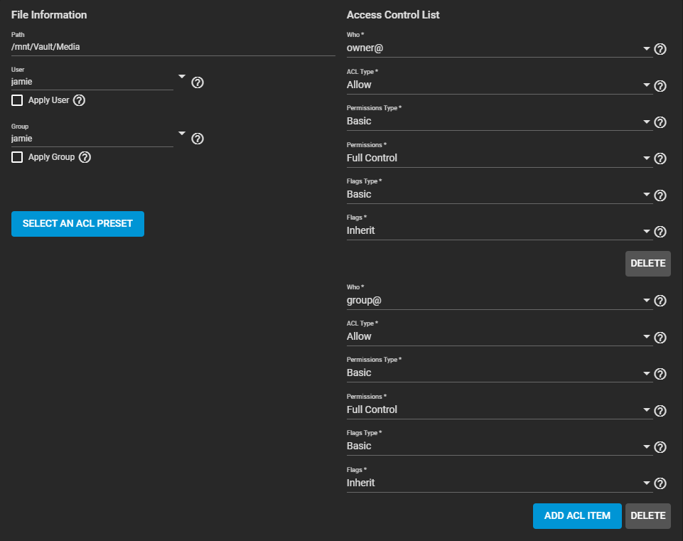

Here are the truenas dataset details, all permissions were pushed recursively after data was moved
Ensure your data set names and pool names do not contain spaces as nfs does not play nice with that
Spoiler
